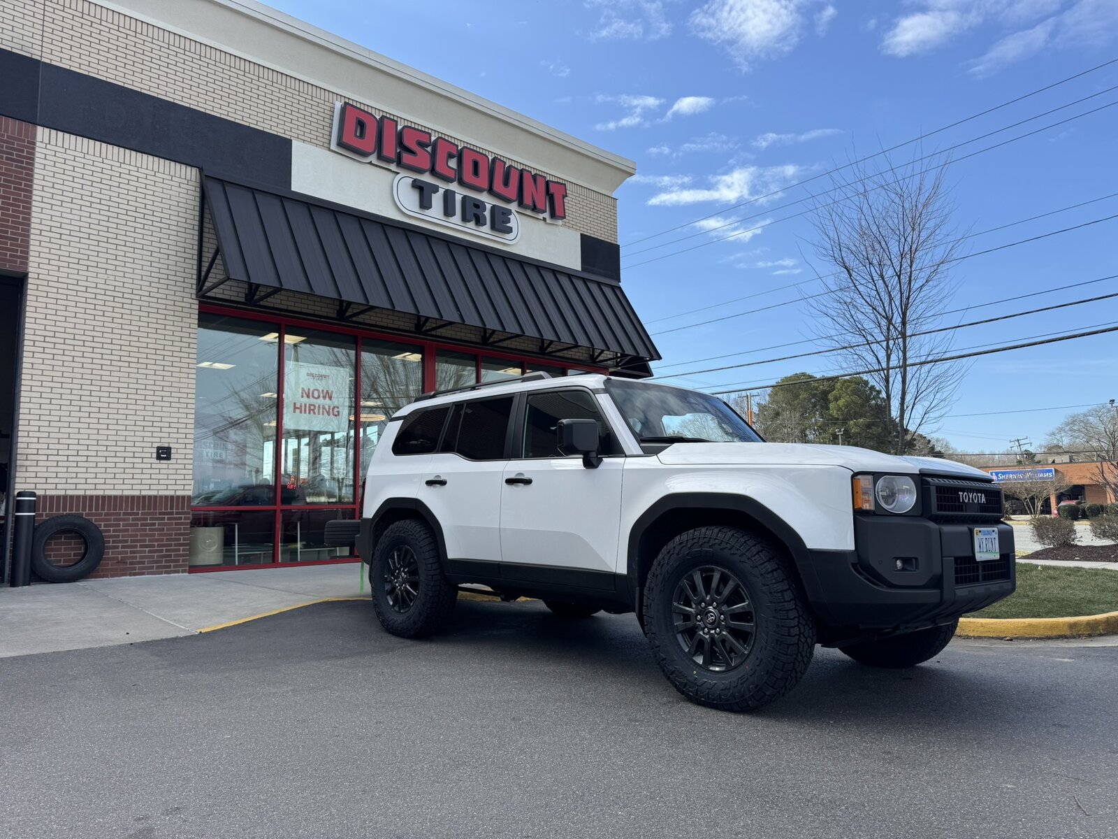

285/75R18 which gives you a 34.83" x 11.22" on stock rims.
There's two downsides though. One is that the tire no longer fits in the stock location, so you have to make other arrangements for a fullsize spare. Also, when you don't have a spare in the stock location, numerous things get a lot more vulnerable, including the black plastic on the rear bumper. I also ordered another stock size wheel to put back in place. Now I'll have a fullsize spare, plus a "donut".

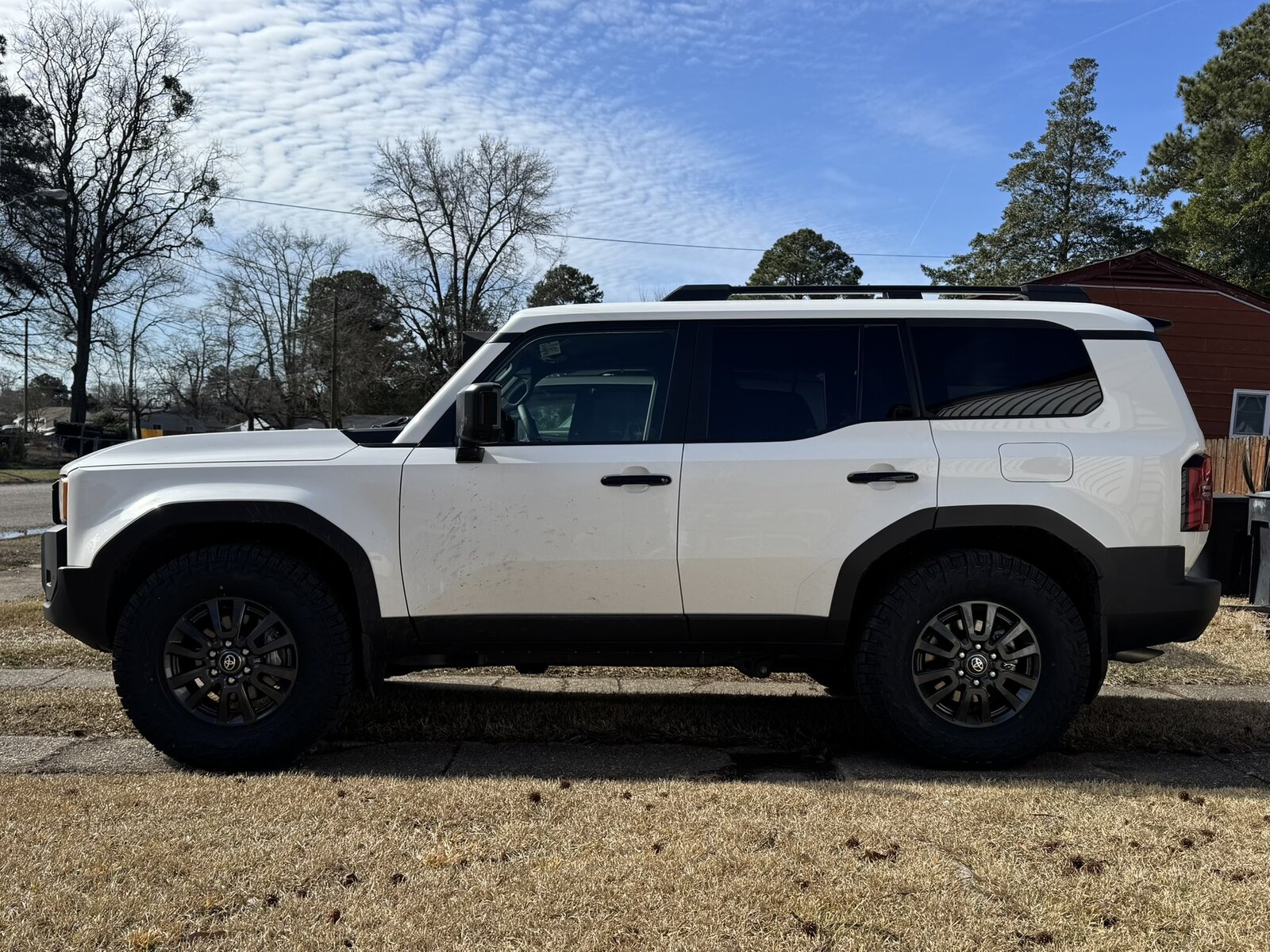

These roof rails are from Amazon.com (direct link to the product). Currently they're less than $200 with Amazon's attached coupon. After some additional inspection, they are indiscernible, at least to me, from OEM. I have no doubt they will last and carry things just fine with a proper installation.

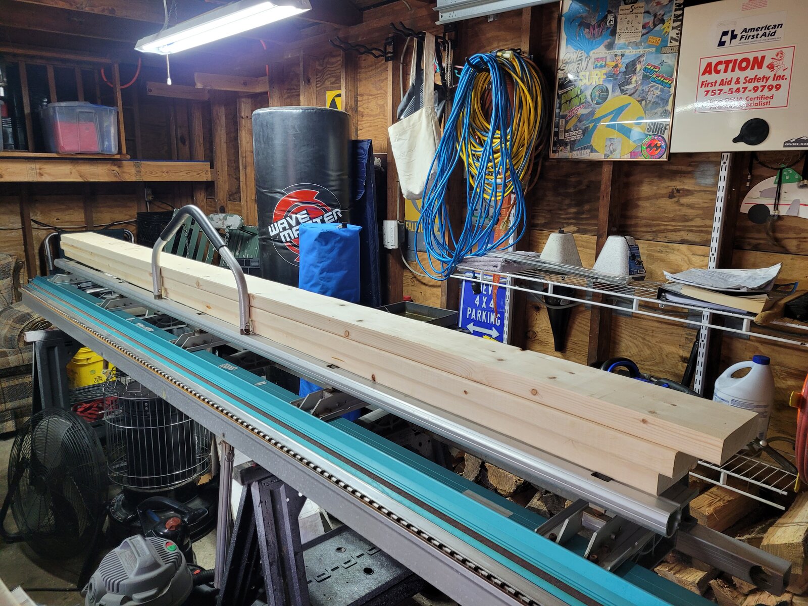

Speaking of roof rails, I bought some 2x6s this weekend to aid in sliding the Alu-Cab RTT over from the GX to the LC. Ignore my mess of a garage. Everything has a place, it's just not all in it.

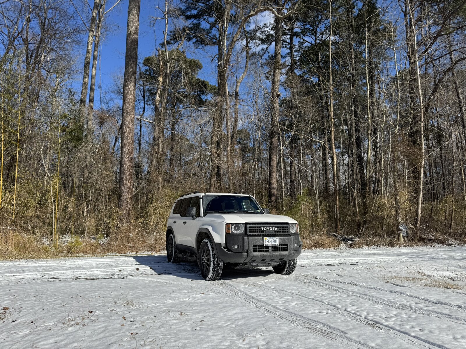

And today I was able to test the LC in snow/ice. It did great. No surprise.

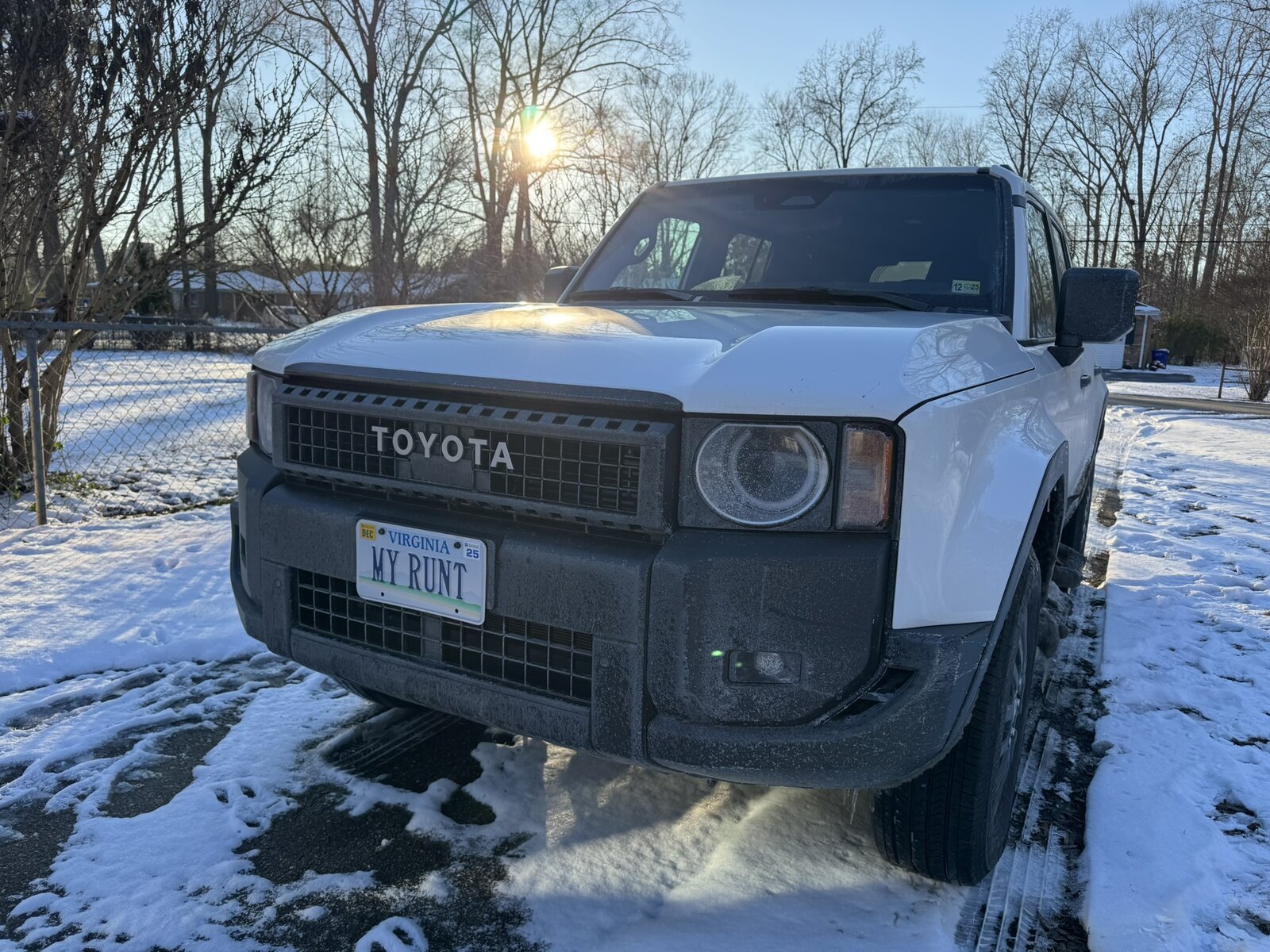

Then, when I got home, I installed the new plates. I may move my other plate over after I sell the GX, but for now...
Did your 1958 have factory bolts in place, or did you have to buy them? If you did buy them, what size and type bolt?
There are bolts in place to keep the holes sealed. The roof rack came with bolts that were slightly longer than the factory bolts, so I used them, but I believe the factory bolts would have worked.
Good info brother. I have a 1958 as well.

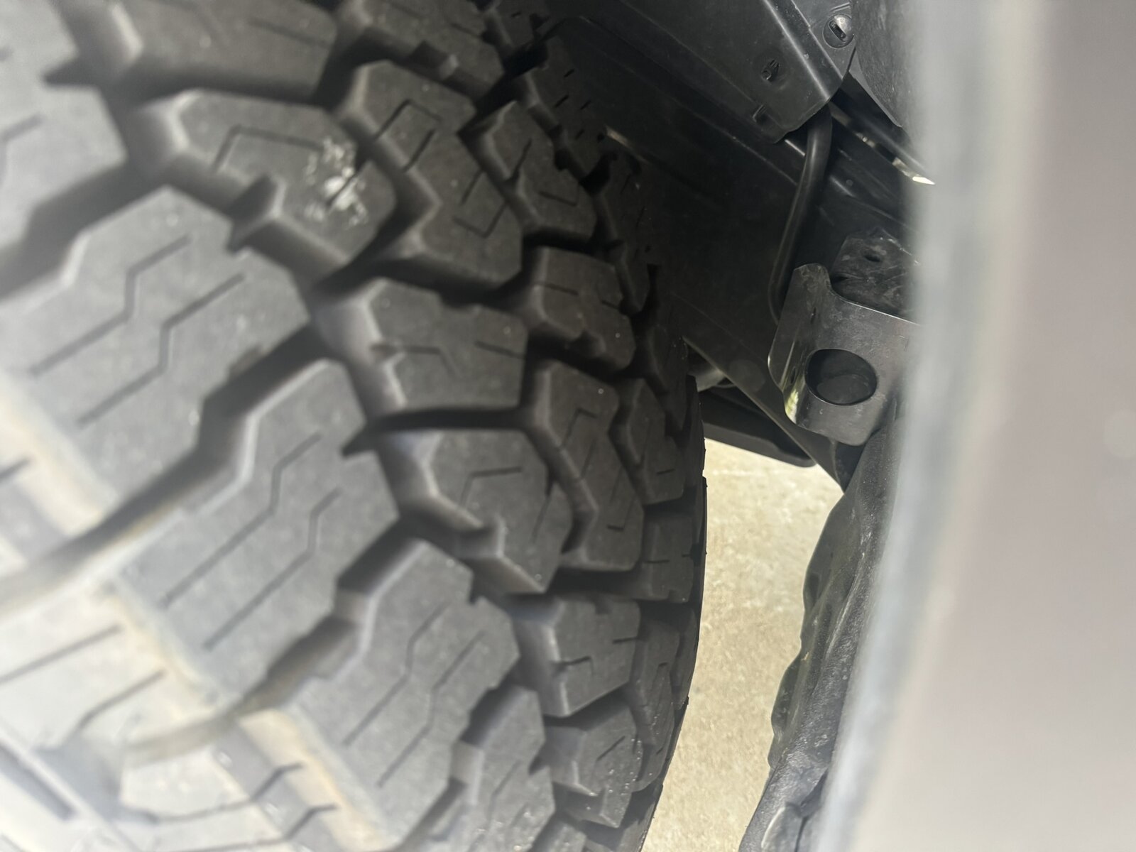

Looks great. “With 285/75R18 which gives you a 34.83" x 11.22" on stock rims” , did you have rubbing before spacers? I am going to use the same size with a Wescott lift and hoping that will do it with no rub and no spacers. Spacers would be next choice.
Yes. But, from what I've read, it is trivial to tuck these lines inside the frame.
