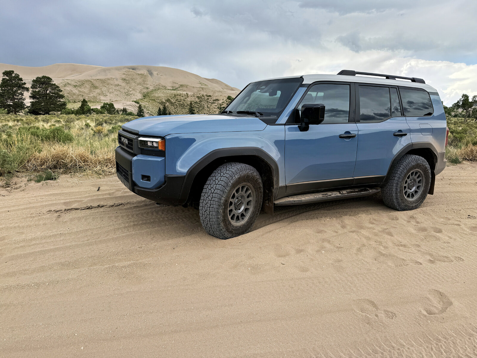

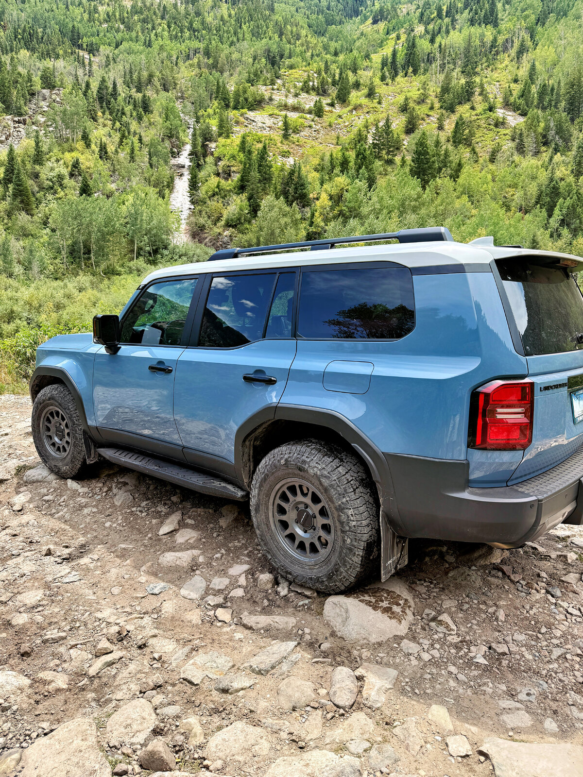

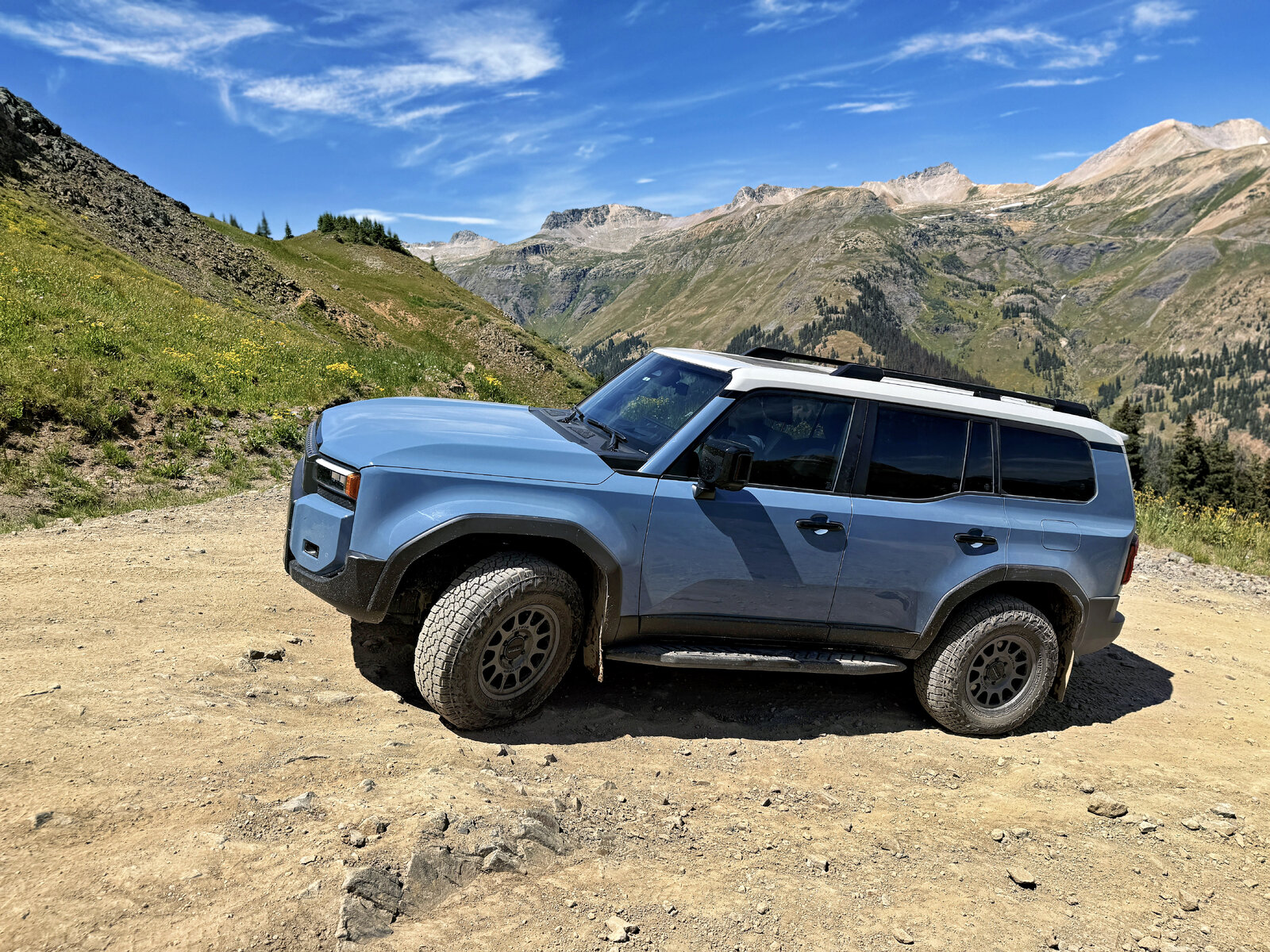

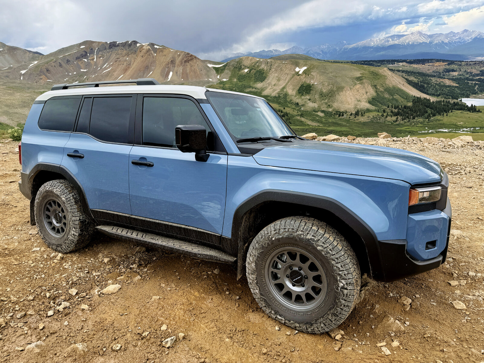

After spending the better part of six weeks living with my LC in the mountains of Colorado, I can definitely say that it was the ideal choice for me. The LC is a comfortable daily driver, sweet road tripper, and highly capable off-roader.
A quick list of mods I made specific for off-roading:
  1. Method 703 Beadgrip wheels (17", +35, Gloss Titanium)
  2. Falken WildPeak AT4W LT255/80R17
  3. Slee Rock Sliders
  4. OEM Skid Plates (engine & transmission)
  5. RCI Front & Rear Lower Link Skids
  6. RCI Rear Shock Skids
  7. OEM First Edition Style Mud Flaps
  8. All-Top Deflators (worked awesome!)
  9. VIAir Pump (fast, but not super fast to get tires from 20 to 40 psi)
  10. NOCO Boost GBX45 (just in case!)
  11. Glue Tread Off-Road Tire Repair Kit (pricey, but worth it if you get a flat. The Falken tires were exceptional and resisted any sidewall punctures, but you never know!)

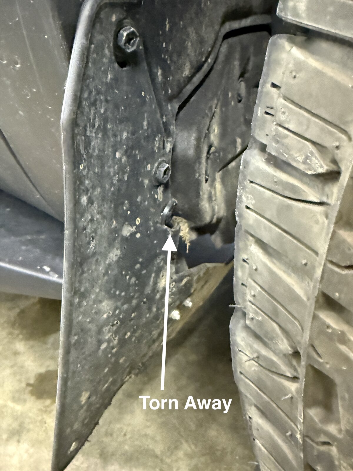

Of those, I would not do the OEM style mud flaps because I found that they were damaged during some of my off roading. I plan to pick up a set of RockBlokz to use next year when I head back to Colorado. The flaw with the OEM mud flaps is that the metal pieces got bent, with the front passenger side suffering the most damage. Here's a couple of pics to see:
View attachment 44848 View attachment 44849
Here's a list of most of the places we took the LC, along with the difficulty of the trails -
  1. Medano Pass Primitive Road (4/10) - east to west, emptying into Great Sand Dunes National Park View attachment 44850

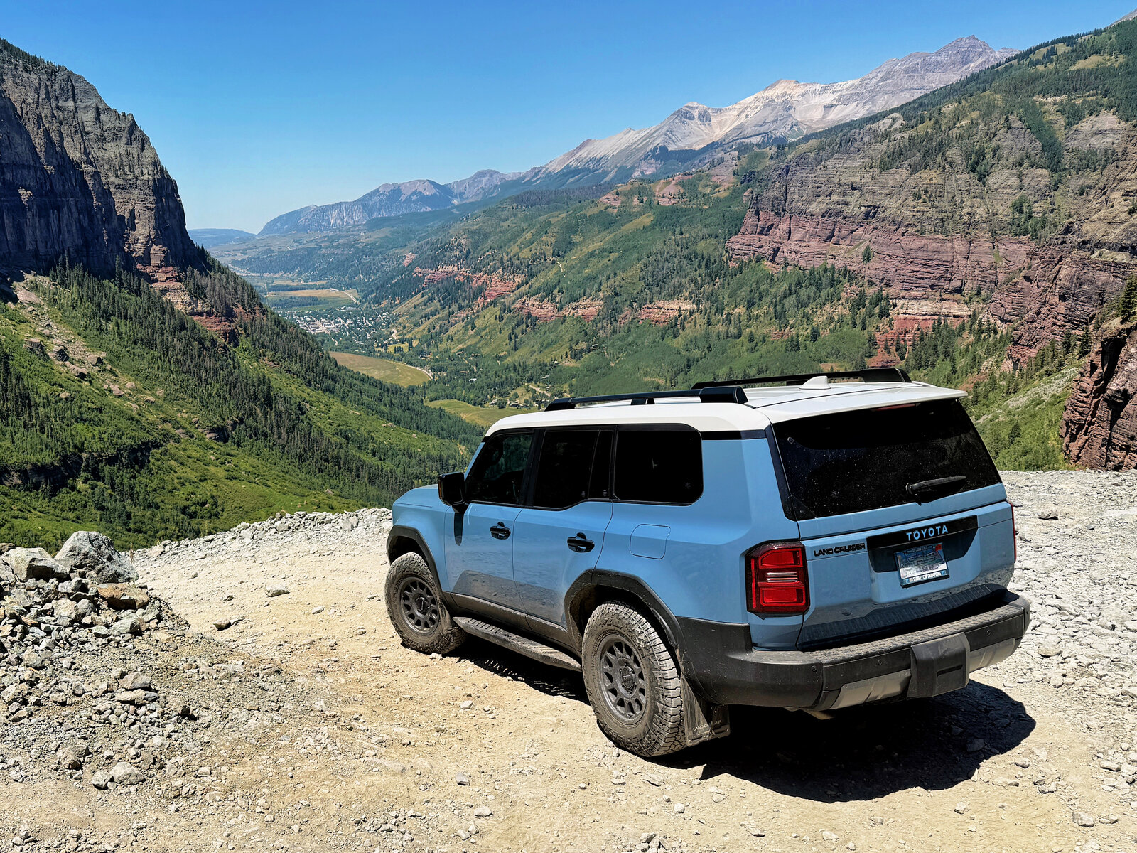

  7. West end of Black Bear Pass (3/10?) - two or three obstacles and switchbacks on the last 2-3 miles of the two-way trail on the Telluride side of the pass. No interest in doing the one way switchbacks down into Telluride. View attachment 44854
