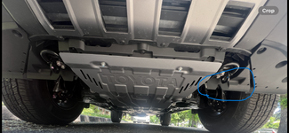

What is the other piece of plastic circled in blue and how to remove it?
I stole this picture from the skid plate thread and I don't have an FE, but I noticed the extra plastic piece when removing my air dam from my 1958.
Based on pictures posted by other members, it appears that most remove this extra piece from each side when removing the air dams.

I took those off when I took off the bigger dams as well - mostly because they integrate well with the dams, but were noticeable and a bit ungainly when they were left by themselves.
Each has three clips - two of them are twist clips on either side of the recovery point, that you simply twist 90 degrees and remove (like the clips for the floor mats). The third is inboard and above the recovery point, accessible from the wheel well, and is the same clip as on the bigger air dams. It's a bit trickier to get a flat had in there to pop out the clip so you can remove by hand, at least after I upgraded to a slight larger tire, but once you find the lip and get the right leverage point, they pop right out. No tools needed.
