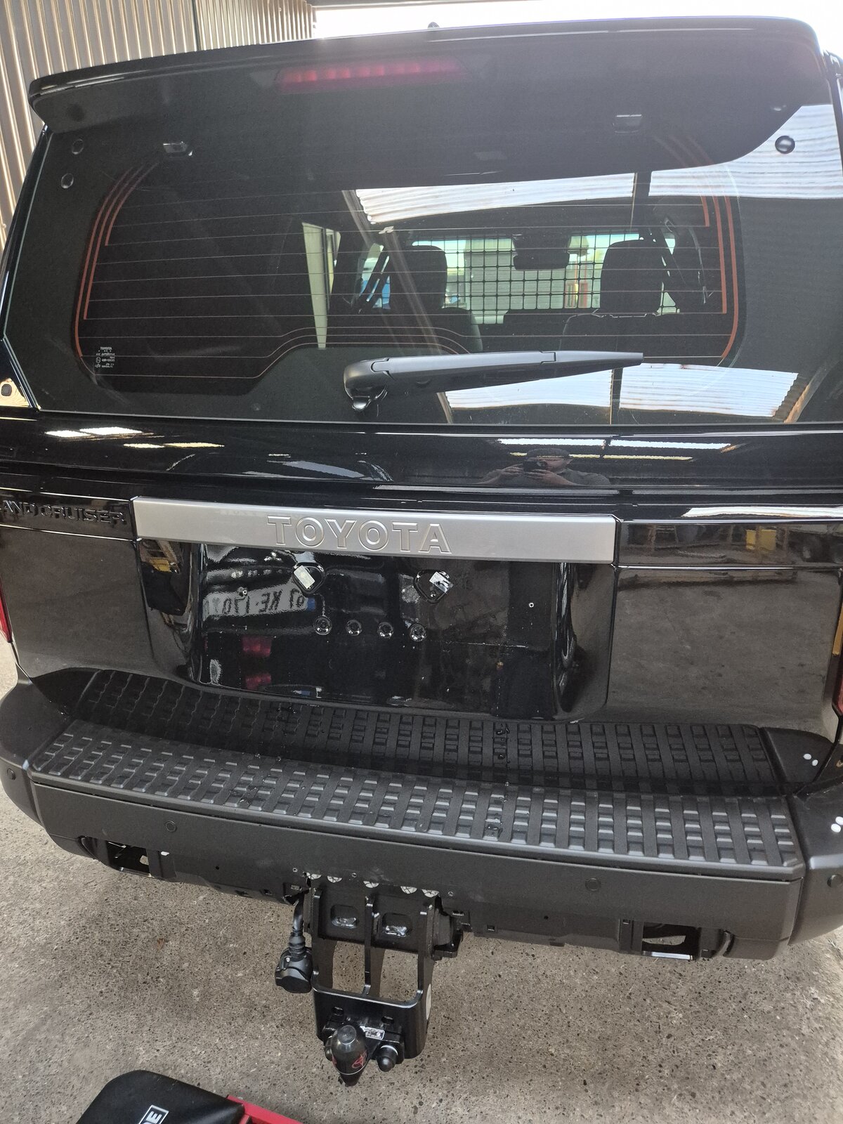

Hi All, fantastic forum, well done. Just got my new Landcruiser 250 the other day, they very slow to make there way to Ireland. Got it in metallic black, looks great but I've decided to do some mods to it. Ive put a set of BFG's AT under it and now want to paint the grey bumper trims and front grill in the body colour to create a black edition if you will. Your posts above were a great help to remove the trims on therear bumper. But the last piece I am struggling with it the Toyota Garnish on the rear door. I cant see how its clipped on and I'm afraid to apply pressure in case I crack something. Anyone been brave enough to remove this? Its holding up bringing parts to paint shop so I can start driving this machine. Any help would be greatly appreciated.

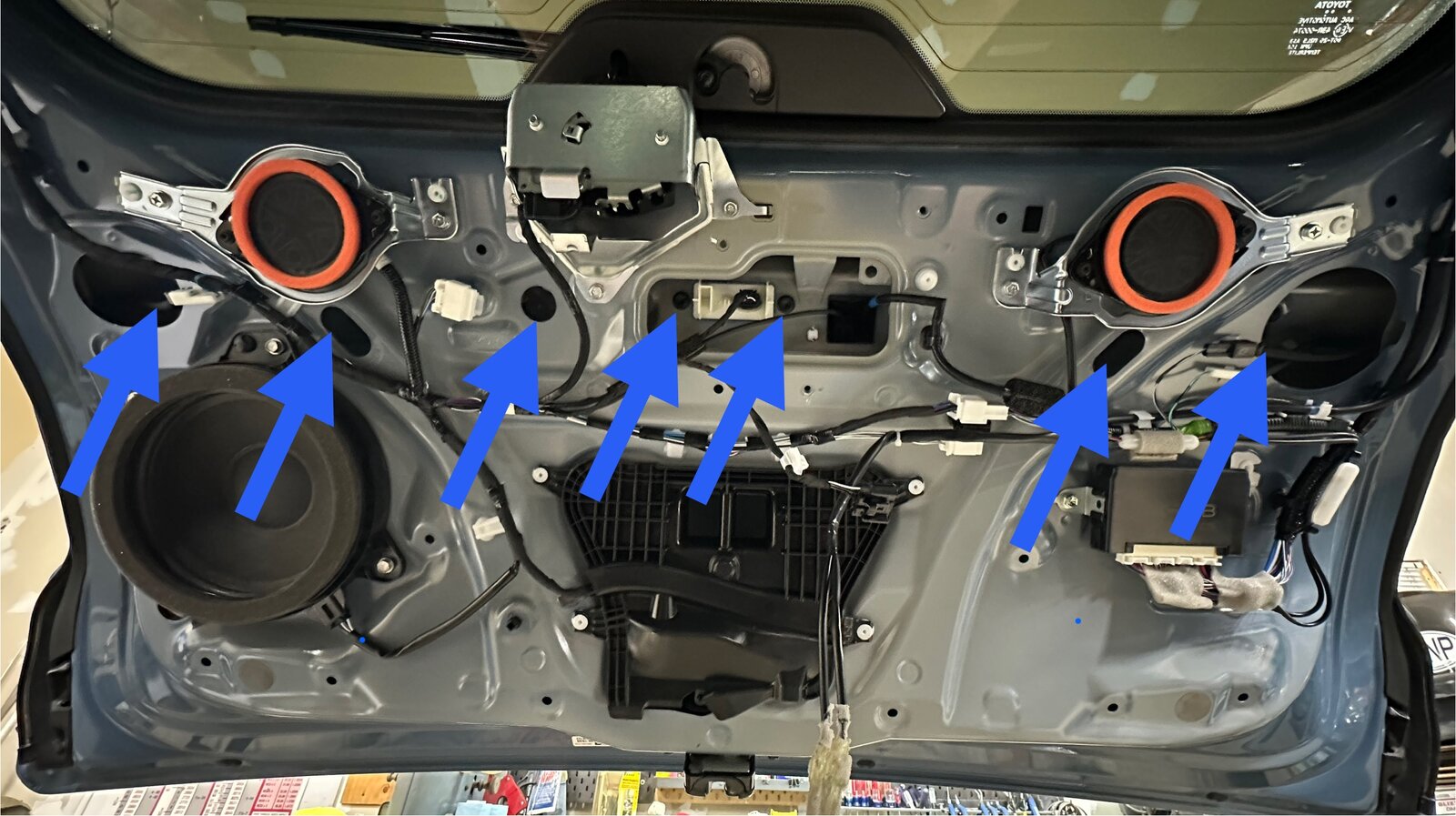

No messing around here, that was quick reply 😃 thank you. So if I'm interpreting it correct i need to remove inner rear door card to access the 6 bolts that hold on the full garnish strip. Then when its off I assume I can disassemble the grey Toyota badged piece.

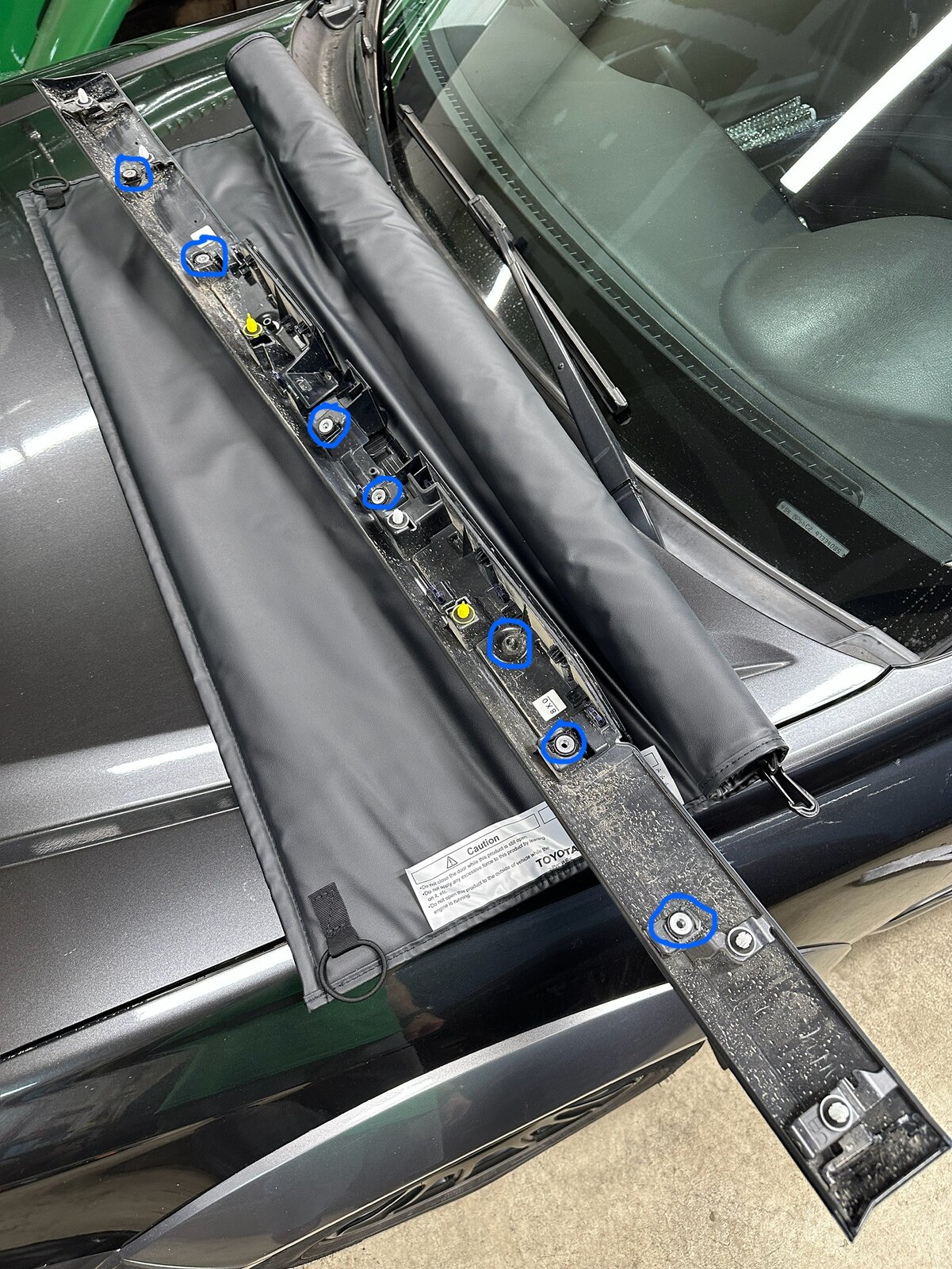

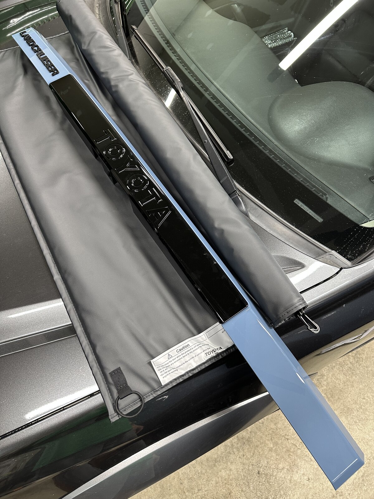

I don’t have time to explain much but here are some pictures that might help. There are screws where the blue arrows point and then a few of the “Christmas tree” fasteners.
You have to remove the rear wiper motor to get to the screws in the middle.
Correct. The rear hatch trim surrounds are held on by plastic "Christmas Tree" fasteners.
