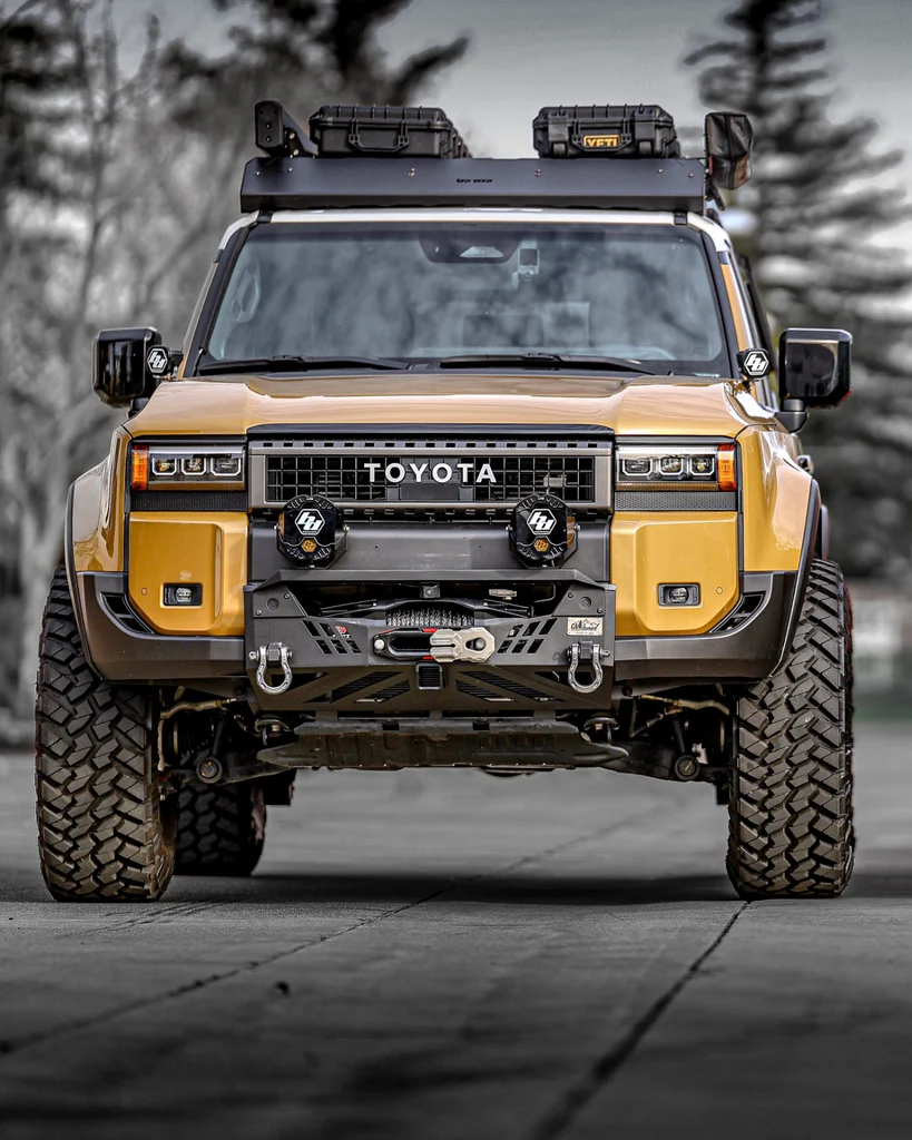

They don't advertise some of the suspension work they do, like King suspension products, you need to ask.
Going to look at the bumper and winch pkg, kinda irresistible to be honest, very clean with good winch access, all in house fabed.

I was just up there last weekend for this, still working on a quick install video for them. Max and the guys do great work.

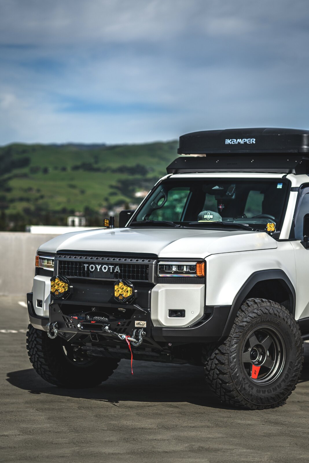

@Luigi (2yotas1fam) and I are both located in the south bay and area and would be more than happy to meet with you if you're ever in the area. I'm in the Milpitas / Fremont area the majority of the week. I don't think either of us have any plans to be up there anytime soon. We're both currently running the front bumper and winch. I can also shoot you some photos and answer any questions that you might have.
As far as the air dams, they're not need on either the 4g Tacoma, 6th gen 4r, or 250 series LC. I believe their sole purpose is to help Toyota report higher MPG numbers, and maybe to deflect some debris. There's a reason why many of these owners pull off the factory air dams as one of their first mods to these vehicles, and have reported no issues yet.

I'm in Fremont, how have I not seen your Land Cruiser around!
I've pondered figuring out some kind of quick disconnect for the air dams so I can take them off when I'm not on the highway, but I haven't put much effort into it yet.
