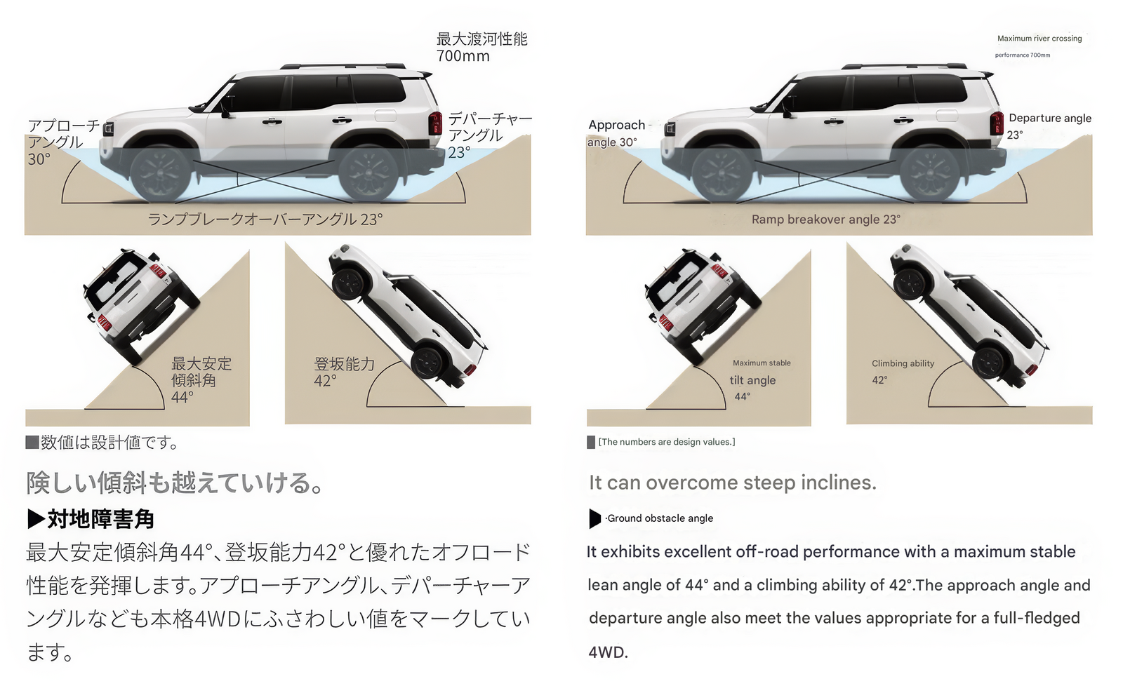

From the Japan catalog (translated by Google): 700mm.
I would think diesel and hybrid have different depths. I saw a video with factory LC 250 close to 700mm, but it was diesel. Diff relocation + hybrid - would be good to get a depth. I drove my diesel 105 series Landcruiser up to window.

I recall seeing 70cm as the official number.

I can't completely answer your question......... but as you found out with your winch install, a short in the 12V system will effectively kill the thing. While DC normally does ok with water, all the components in the DC to DC converter won't............... in Post #11 it looks like the OEM height of the rear bumper.
