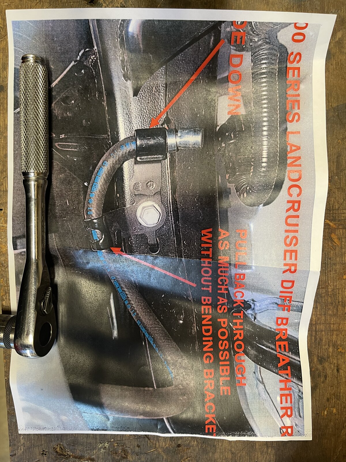

Was this diff breather part of the lift kit?
Not that I've found, all that is pictured is a hose with the OEM breather on the end, would need the correct threaded hose barb for the axle.
