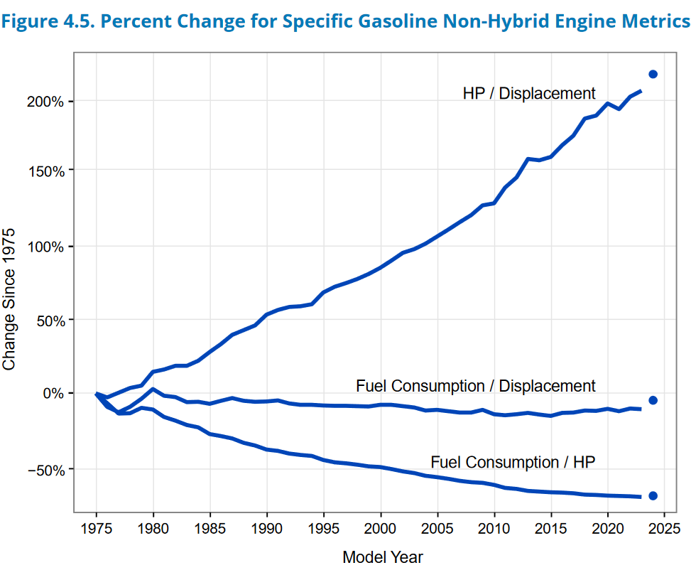

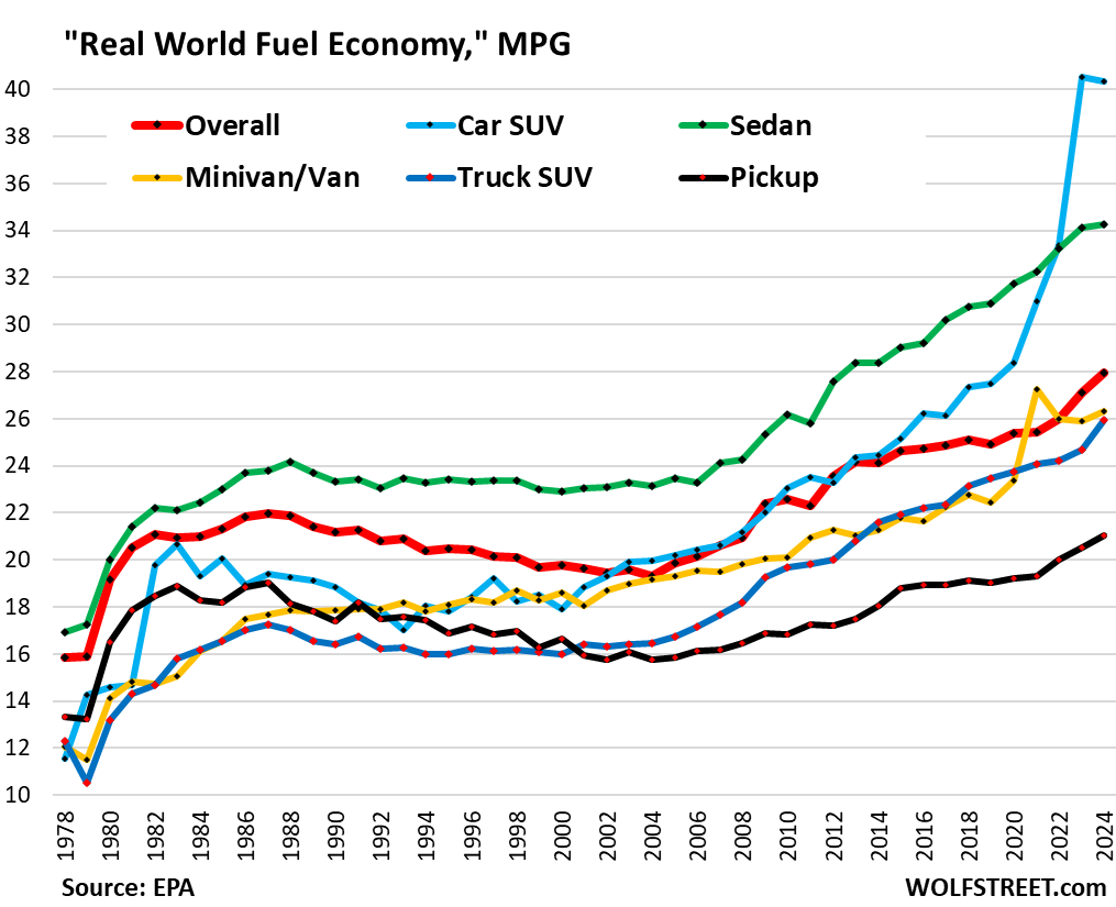

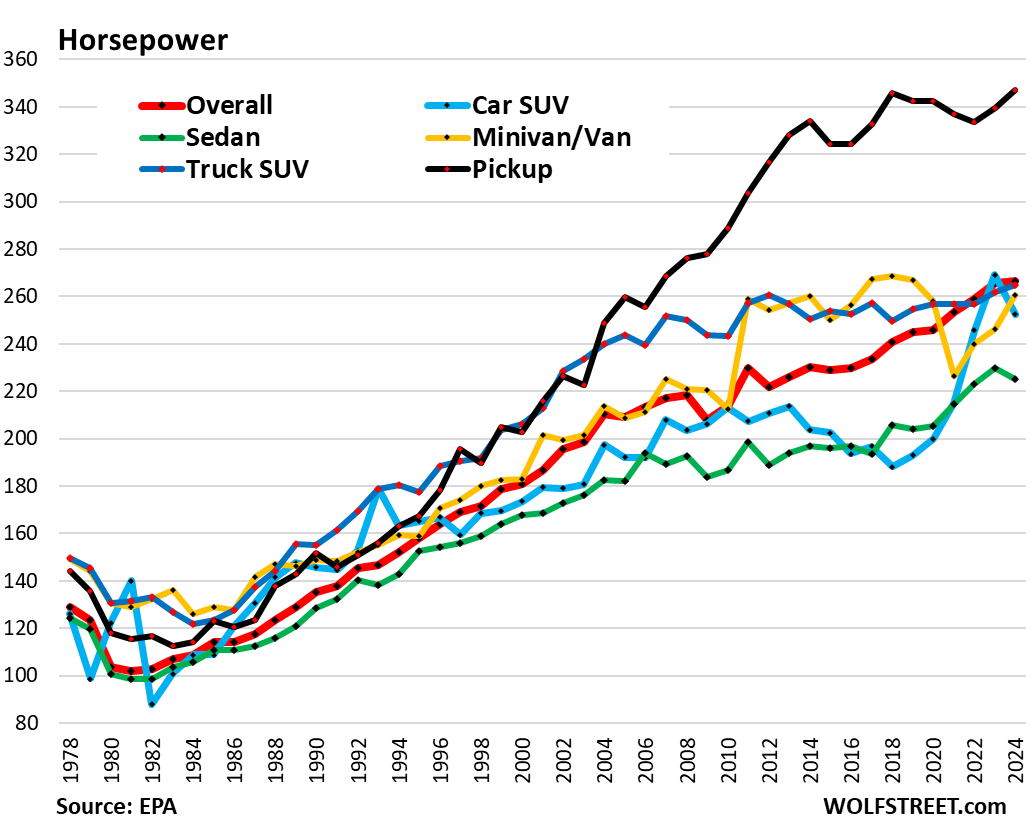

The good news is the light truck industry has been rapidly reducing the number of cylinders. In the case of Ford, it has gone from 8, to 6, to 4, and now 3 in its light truck/suv engines. In return, we have seen amazing improvements in power and fuel economy. Since 1975, horsepower per displacement has more than tripled (+210%) and at the same time fuel consumption per horsepower has fallen by 70%.
The industry has achieved this amazing success primarily by substituting pistons for turbos. Now, we are seeing the process continue by transitioning to hybrids which offer even more benefits. If the trend continues, after the next million miles you probably won't be able to find a new model truck/suv with a V8 or even V6. And that is a good thing.
So, it turns out there actually is a replacement for displacement. First it was the impeller and now it is a battery.

There's no obsession with track speeds. I'd hardly call 88 mph a track speed. You're the one posting dynographs. The TRAP speed at the end of the 1/4 mile is indicative of engine power but also factors in gearing and resistance.
It is most safe to drive with the flow of traffic. The stock LC250 in stock form can keep up with the flow of traffic. Add a family of 4, camping gear, winch bumper, RTT.... just say GVWR and it is slower than most sedans. Add 35"+ tires and it becomes slower. Add a trailer... maybe take it up to the mountains and now it is really slow. You can't understand that?
As for your graphs, it should be pointed out the first two graphs regarding hp and fuel economy are way skewed due to 100% electric vehicles.

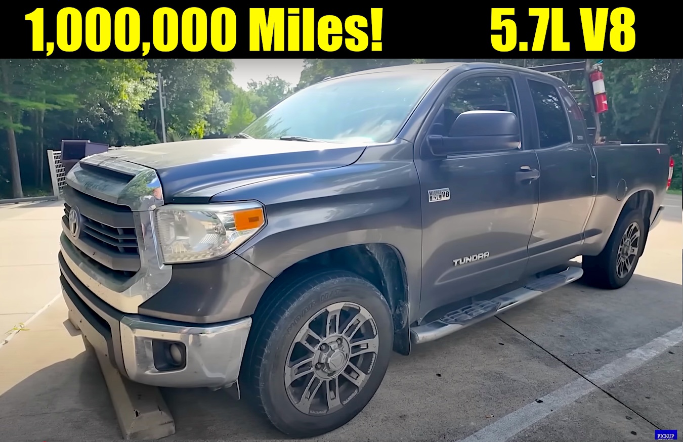

This guy had a 5.7 and 4.7 go a million miles on the original engine.
This is not a 5.7 but another 4.7 going a million miles.
If we go with extreme examples, here is a ford Ecoboost at 420k miles with original engine, transmission and turbo (without any major service).
