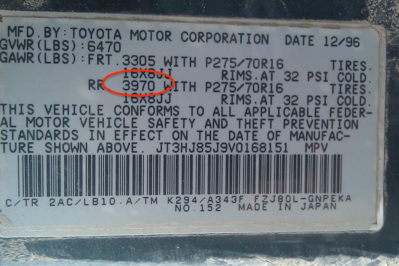

I don't know where your data is coming from but on an FZJ80, the full floating rear axle is only rated 3970 lbs. It's not even half of 8,000lbs. I believe the 80 series to be the strongest of the bunch (40/50/60).
The 32 spline axle shafts are only dimensionally larger than the 30 by a little bit but I believe it to be 20%+ torsionally stronger. I'm not trying to sell it and nobody here Is interested.
Yes, and a HZJ80 is 5500 lbs. with the same axle. The GAWR rating has to do with the drive train, suspension configuration and tires spec'd. This is why in Australia you can do GVM increases when upgrading suspension, drive train and such through the govt. approved parts and installers.
