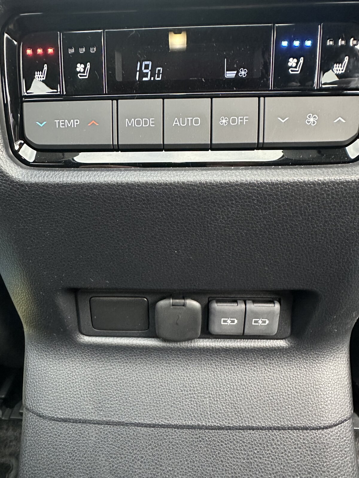

This is what we have on UK spec vehicles…
That’s perfect!
I wonder why they don't offer that in the States?
To be honest, I’d rather have heated and vented rear seats in the Premium package rather than the dopey cold box center console.
Ok. So now I’m wondering if I can add heated and vented seats if purchase all the parts from a UK Land Cruiser? If the wiring is there it would be feasible, unless the CANBUS needs to be aware.
Would be an expensive experiment if it doesn’t work.
