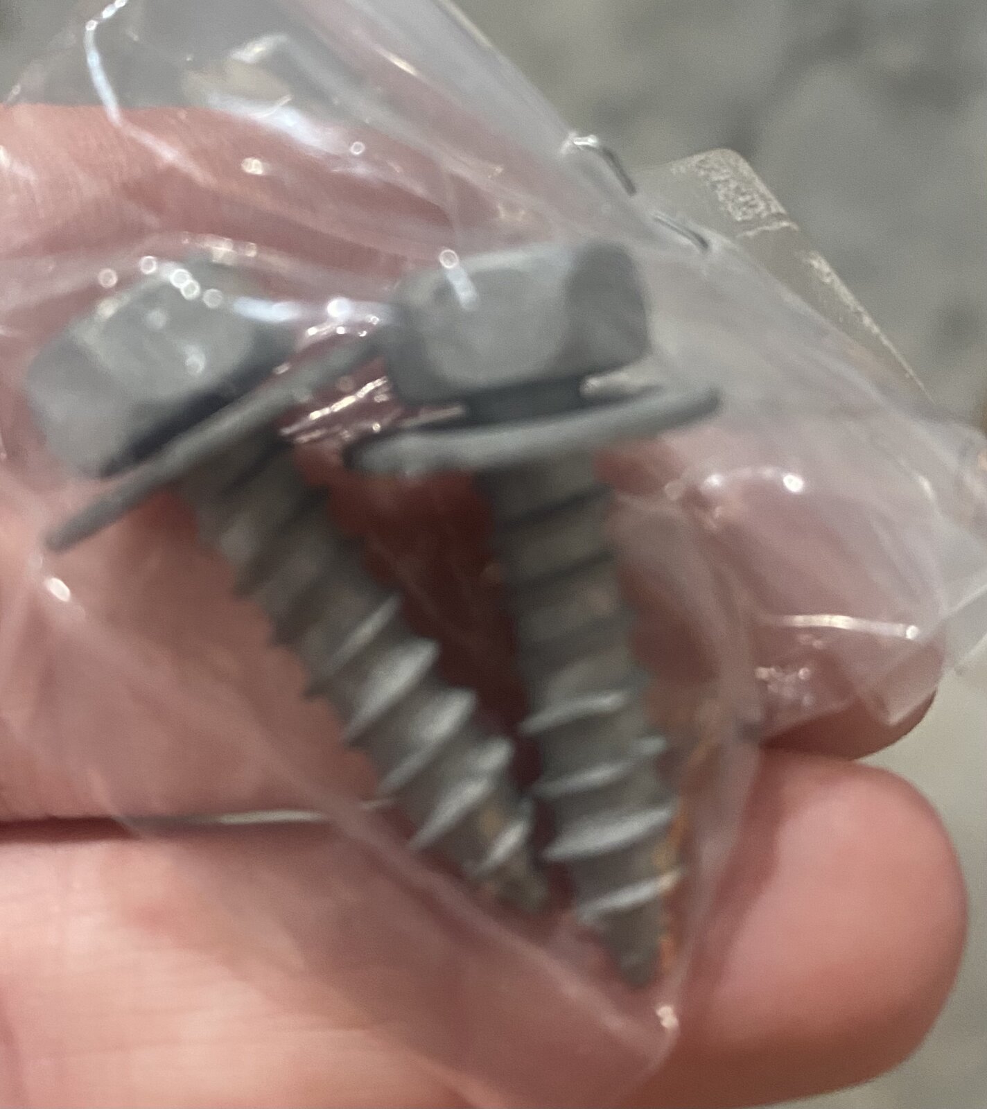

If you are suppose to have a front plate in your state - as I do- the dealer should be giving you a bracket that comes with pointed threaded screw like this one I got with my bracket kit for plate from dealer - which was for my sons 4Runner fyi -sorry in advance if this isn’t what you mean
So it won’t need any type of clip the pointed screw holds it
If you are suppose to have a front plate in your state - as I do- the dealer should be giving you a bracket that comes with pointed threaded screw like this one I got with my bracket kit for plate from dealer - which was for my sons 4Runner fyi -sorry in advance if this isn’t what you mean View attachment 2826
Wouldn't these require holes to be drilled in the bumper? He's looking for a no holes mount.
Yes - the black bracket plate holder hides it - but yes there will be a hole -
This was also in response to another question on this thread about whether an insert is required which is No, not in my experience

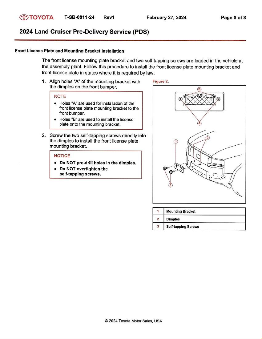

Where can i find so called dimples on the front bumper?
I just don't see them.
Never mind, just found it. It is very faint, you really have to look for them in broad daylight.
With the bracket that comes with the vehicle, it turn out to be not that bad looking.
