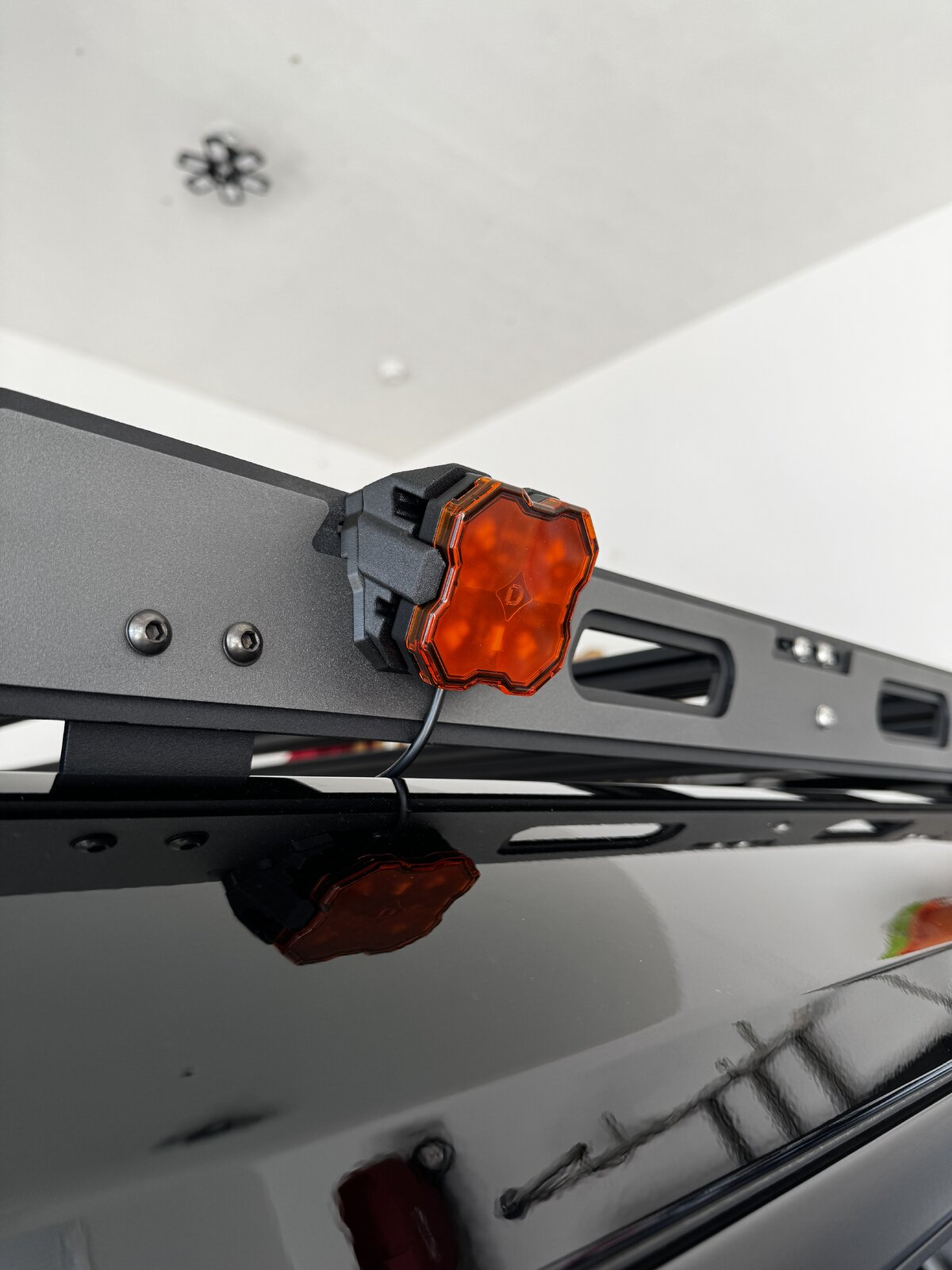

You could look at something like this to mount them on the side. If you could get me the dimensions I could design a backer plate that could house the included nylock nuts to screw the included hardware into. I am going to be designing a backer plate for my buddy's 2024 Tacoma TRD Pro for that mount too. This is what mine looks like on my Victory 4x4 rack.
Diode Dynamics Angled Rock Light Mount - Universal Fitment
Oh snap that will be awesome!
