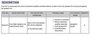

@Thx_1158 reading through TIS, it seems that for both the 10 and 14 speaker systems, the telematics unit has the ability to hijack the front right dash speaker path during emergency call situations. It also mentions DTC B1ACA71 will be thrown if "Open in the front speakerRH circuit is detected."
Curious if you knew about this and had a solution? if you wired your own front dash speaker did you leave the telematics connected to another dedicated speaker? You can also put a dummy load on the telematics SPO(+/-) speaker output if you don't mind dropping that functionality.
I was considering leaving the OEM center dash speaker dedicated to telematic unit and wiring my own L/R dash speaker.
