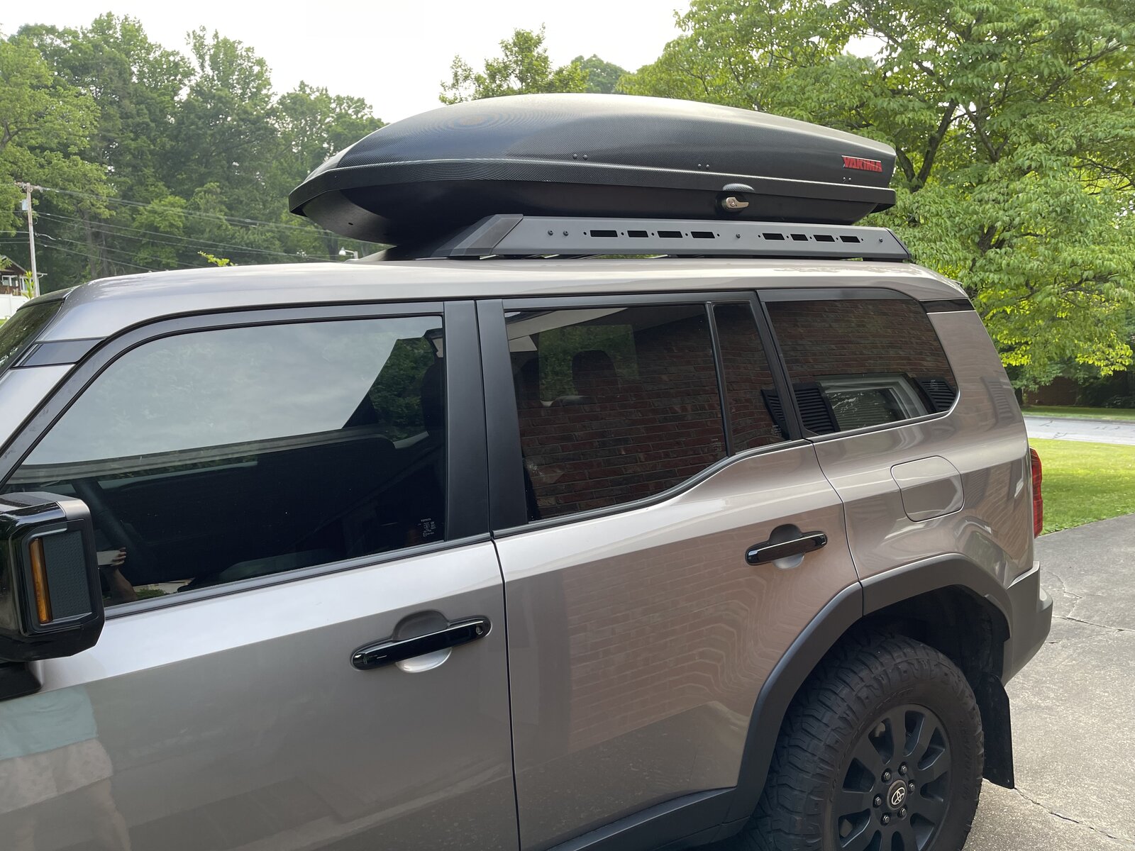

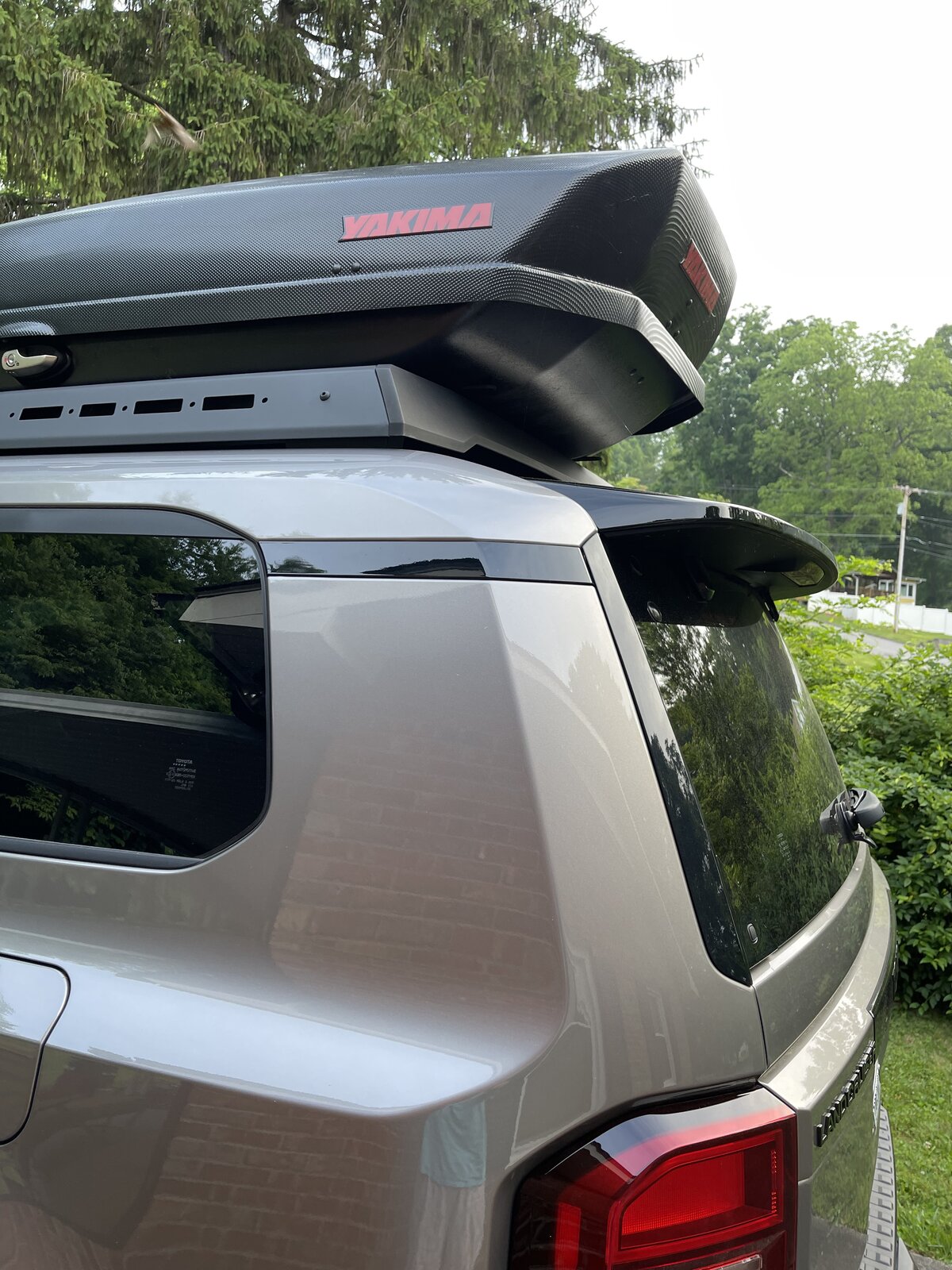

I purchased a used Yakima 16 Skybox - one manufactured in the older style - and made only slight adjustments. First adjustment to change position of one bar on rack and then to the lift height of the hatch. Works great.
View attachment 39034View attachment 39035
Looking at doing this same set up. Can you tell me which cross bar you ended up moving?
