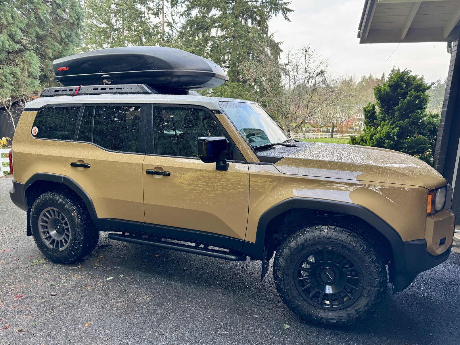

Mine fit fine. I have a Yakima box and I had to turn the front grabber on the box around as the bar was too close to the front fairing. Works fine though. I know Thule has a different grabbing system but it should work too.
My Thule ski box has the grabber/claw style attachment point. It did NOT fit on my first edition rack because the rails are the same height as the front edge. The attachment point is recessed on my ski box so it needs a raised rail to attach to - I suspect it would work on a the LC LC crossbar setup though.

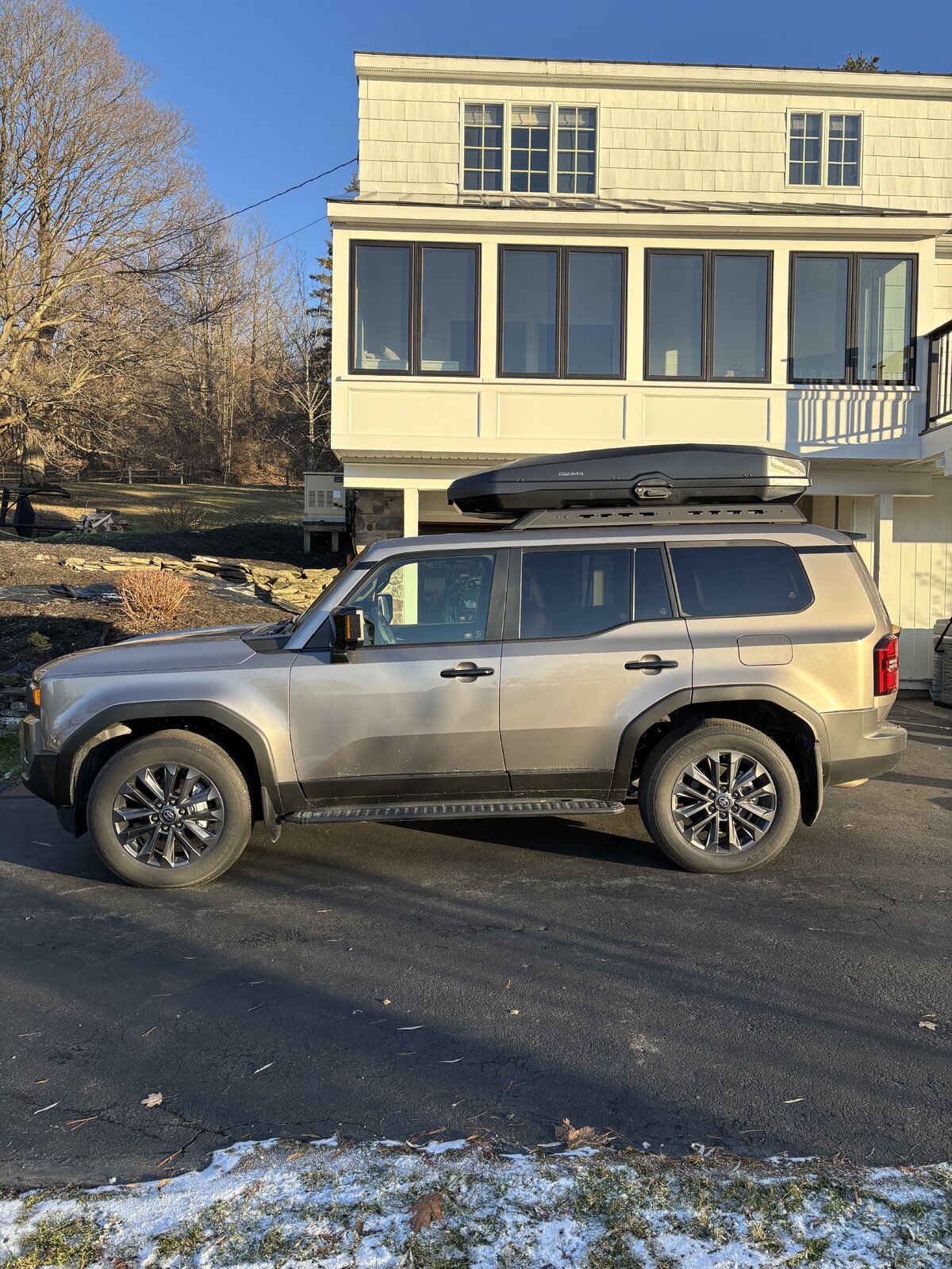

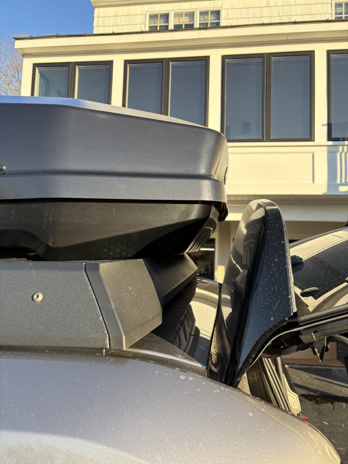

I got a Yakima CBX-16 that fit my first edition rack really
I got a Yakima CBX-16 that fit my first edition rack really well. View attachment 21830View attachment 21831
I cannot figure out how your box is attaching to the rails when it cannot drop down as designed. I believe the indented bottoms of the cargo boxes were added to increase fuel mileage. Yours obviously fits, but REI said they had tried, and it will not work. Did you have to buy special clamps or do you have anything you added to make this work? Thank you.
I had to move 2 of the cross members of the rack to be in the right location for the adjustable clamps on the box.
I had purchased the t-slot kit but didn’t need it.
I did have to mike the box clamp points to one of the alternate factory provided locations.
It fits fine without any custom parts/drilling/etc..
