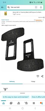

Could look at something like this. Believe you just put them in the slot and it fools the computer
