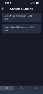

Would be interesting to hear the truck without the engine sound enhancement. They’d be better off reducing the engine noise versus enhancing it, ‘cause it’s not very sexy.
LC250 doesn't have ESE, that is only on GX550. The setting is there both in Carista and GTS+ but not applicable.
Straight from TIS when land cruiser is selected:
NOTICE:
ESE Function is displayed, but does not work.
When Lexus is selected the same notice is not present.

Chassis & Engine
Active Noise Cancellation (ANC)
ON / OFF
Engine Sound Enhancement (ESE)
ON / OFF

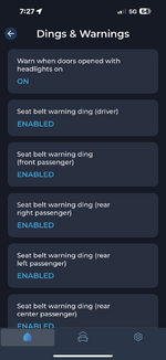

Dings & Warnings
Warn when doors opened with headlights on
ON / OFF

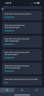

Seat belt warning ding (driver)
ENABLED / DISABLED
Seat belt warning ding (front passenger)
ENABLED / DISABLED
Seat belt warning ding (rear right passenger)
ENABLED / DISABLED
Seat belt warning ding (rear left passenger)
ENABLED / DISABLED
Seat belt warning ding (rear center passenger)
ENABLED / DISABLED
Seat belt warning ding (third row left)
ON / OFF

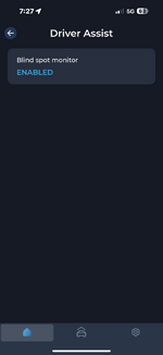

Driver Assist
Blind spot monitor
ENABLED / DISABLED

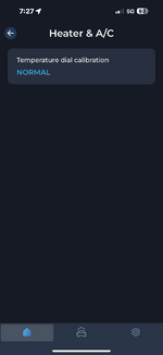

Heater & A/C
Temperature dial calibration
-2 °C (28.4 °F) / -1 °C (30.2 °F) / NORMAL / +1 °C (33.8 °F) / +2 °C (35.6 °F)

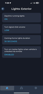

Lights: Exterior
Daytime running lights
ON / OFF
Lane-change turn signal auto-flasher count
OFF / 3 FLASHES / 4 FLASHES / 5 FLASHES / 6 FLASHES / 7 FLASHES
Turn signal click volume
LOW / MEDIUM / HIGH
Coming-home lights duration
OFF / 30 SECONDS / 60 SECONDS / 90 SECONDS
Turn on marker lights when vehicle is unlocked via remote
ENABLED / DISABLED

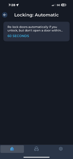

Locking: Automatic
Re-lock doors automatically if you unlock, but don't open a door within…
30 SECONDS / 60 SECONDS / 120 SECONDS

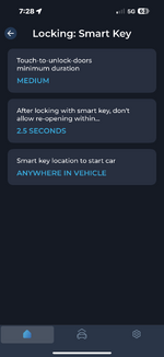

Locking: Smart Key
Touch-to-unlock-doors minimum duration
OFF / SHORT / MEDIUM / LONG
After locking with smart key, don't allow re-opening within…
0.5 SECONDS / 1.5 SECONDS / 2.5 SECONDS / 5 SECONDS
Smart key location to start car
FRONT AND BACK SEATS / ANYWHERE IN VEHICLE

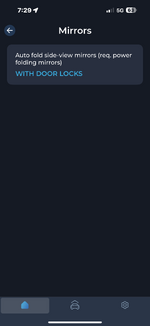

Mirrors
Auto fold side-view mirrors (req. power folding mirrors)
WITH IGNITION / WITH DOOR LOCKS / DISABLED

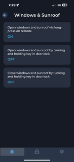

Windows & Sunroof
Open windows and sunroof via long-press on remote
ON / OFF
Open windows and sunroof by turning and holding key in door lock
ON / OFF
Close windows and sunroof by turning and holding key in door lock
ON / OFF

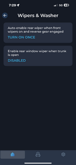

Wipers & Washer
Auto-enable rear wiper when front wipers on and reverse gear engaged
SWITCH REAR WIPER FROM INTERMITTENT TO PERMANENT WIPING WHEN IN REVERSE / TURN ON ONCE / DISABLED
Enable rear window wiper when trunk is open
ENABLED / DISABLED

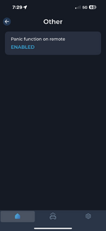

Other
Panic function on remote
ENABLED / DISABLED
