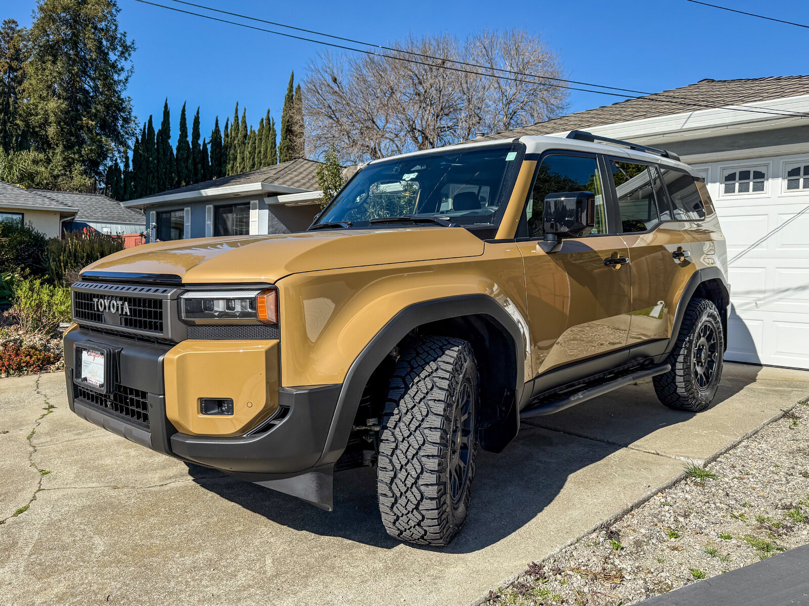

I actually think it looks better without the running boards, but that's just me. Next weekend (hopefully) I'll install the rock rails. (Added note: after having our FJ, my wife said it's easier for her to get in and out of the Land Cruiser now that the running boards are gone! Neither of us are tall. We're just used to a big step up I guess.)

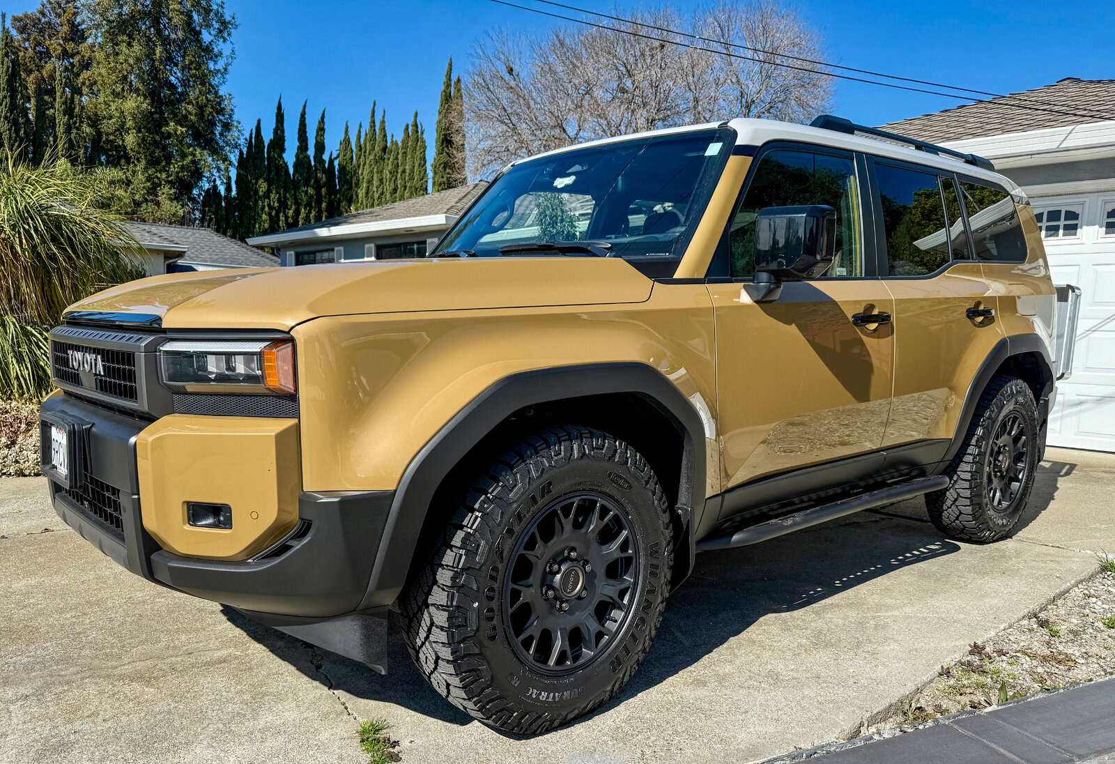

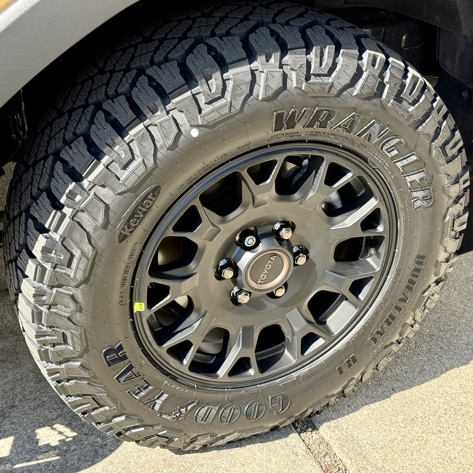

New shoes. Tacoma TRD 18x8” wheels PTR56-35242-F1 with Toyota bronze center caps PT280-35221-5F and 265/70R18 SL Goodyear Wrangler Duratrac RT tires. Three ply sidewalls even in standard load.

Hey man! Good looking wheel! I'm planning to do the same wheel and maybe a different tire :)
Quick question! Did the original LC TPMS sensor works for you? Or do you have to order the Tacoma TPMS?
Best,
John.
Best,
John.
I got PN 42607-76020, that's what a Toyota parts person told me I needed. America's Tire/Discount Tire installed the wheels and used those, I haven't had any issues. I'm using the original wheels for snow tires and left those TPMS alone.
