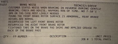

Hey all. I have been having the same issue with my LC FE, shockingly loud screeching of the brakes in reverse. Also started after a few thousand miles. It was driving me nuts. I just took it in for first 5k mile service and mentioned it. I’ve attached a photo of the work done. It’s been a couple days since the service and so far no more squealing. Not sure how durable this fix will be but I’m cautiously optimistic. Thought I would share in case it is helpful for others. Cheers.
