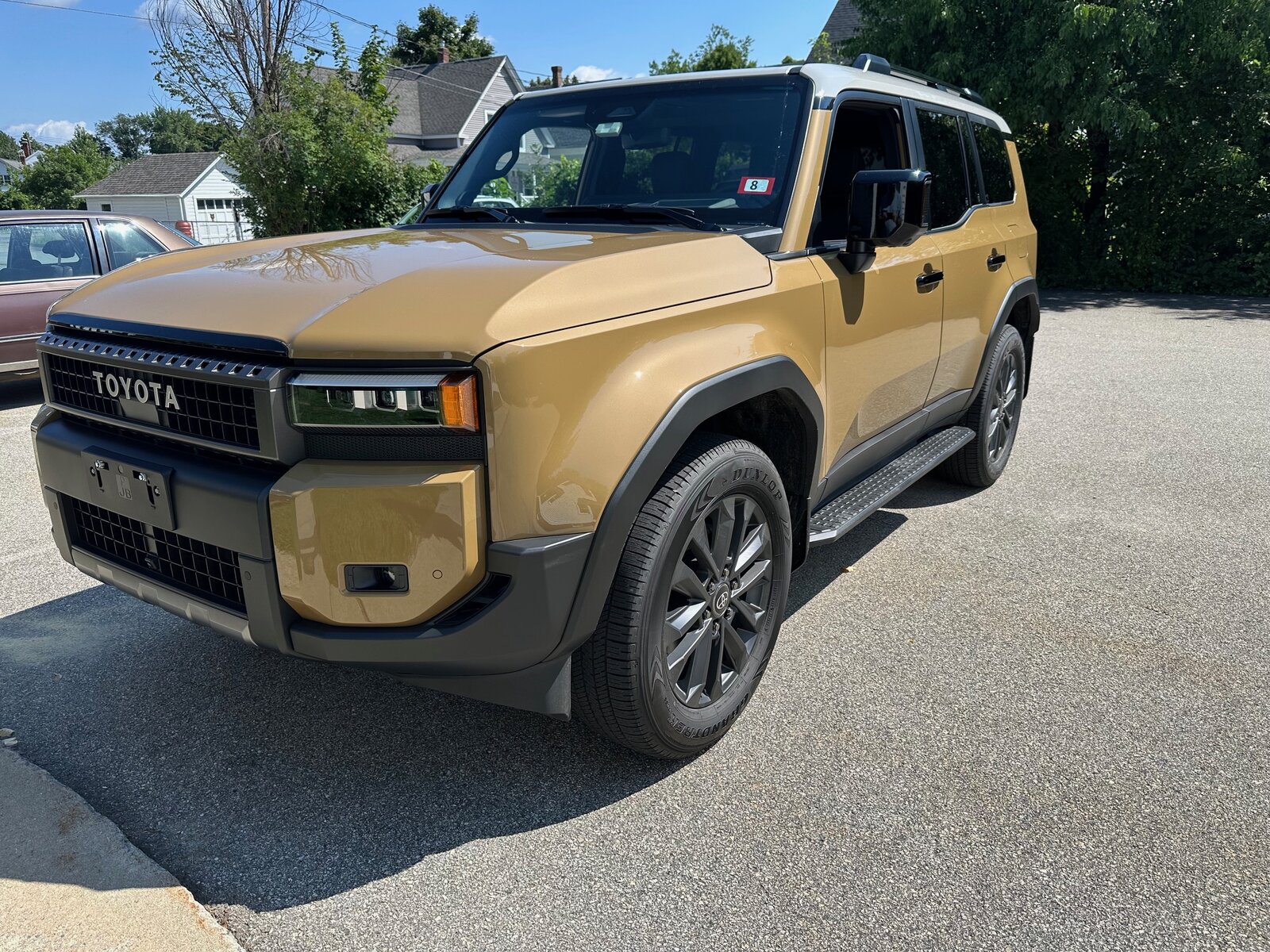

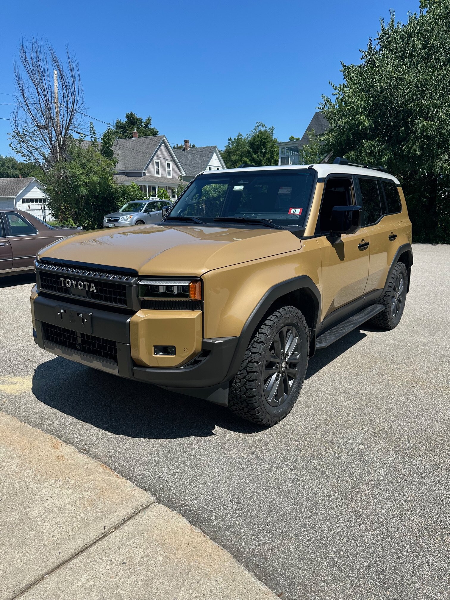

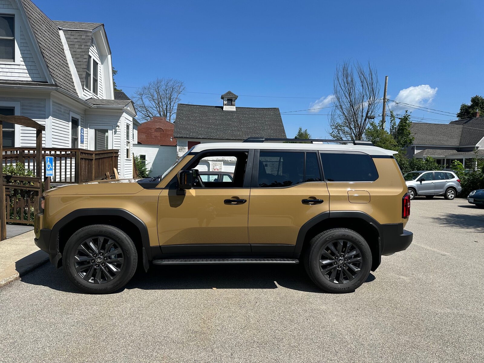

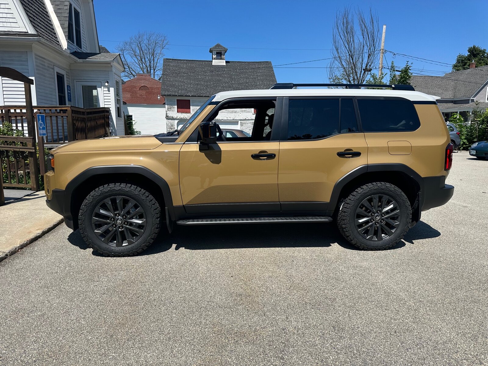

BFG KO2 stock size 265/60 R20
after and before.

Yours really came out perfect, congrats. Huge upgrade for minimum $$$ spent.
Was there a performance reason you went with the KO2 vs the KO3?
