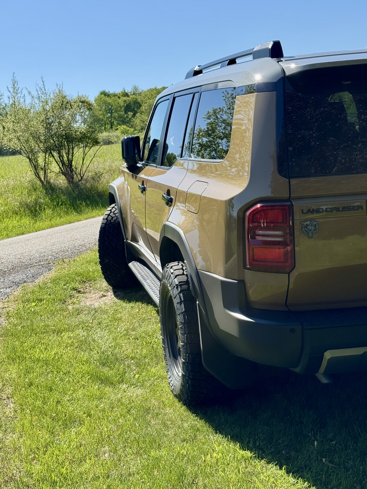

Toyo OC AT III 275/60r20 on stock Toyota wheels, no lift. I modded the heck out of my previous Tacoma, so I decided to take it a bit slower this time, just added some slightly larger all-terrains.
I did the same thing - Toyo Open Country AT III in 275/60r20. No lift. I went for the SL load rating rather than E to save the weight/hit on MPG. I only hit fire roads and easy trails, so no need for the E rated tire anyway. No discernible increase in road noise and the truck rides slightly better.

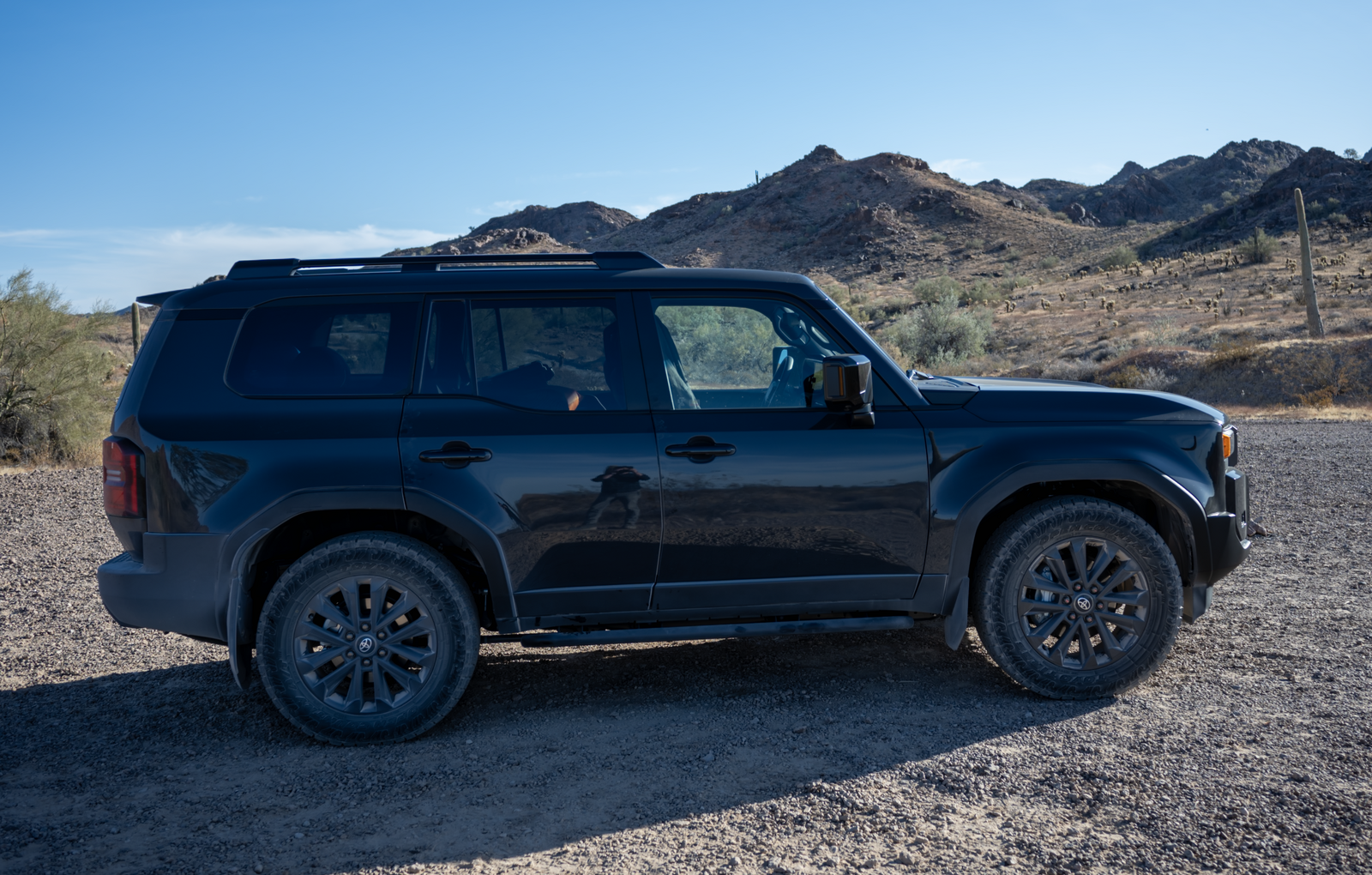

285/65/18 Method Rims

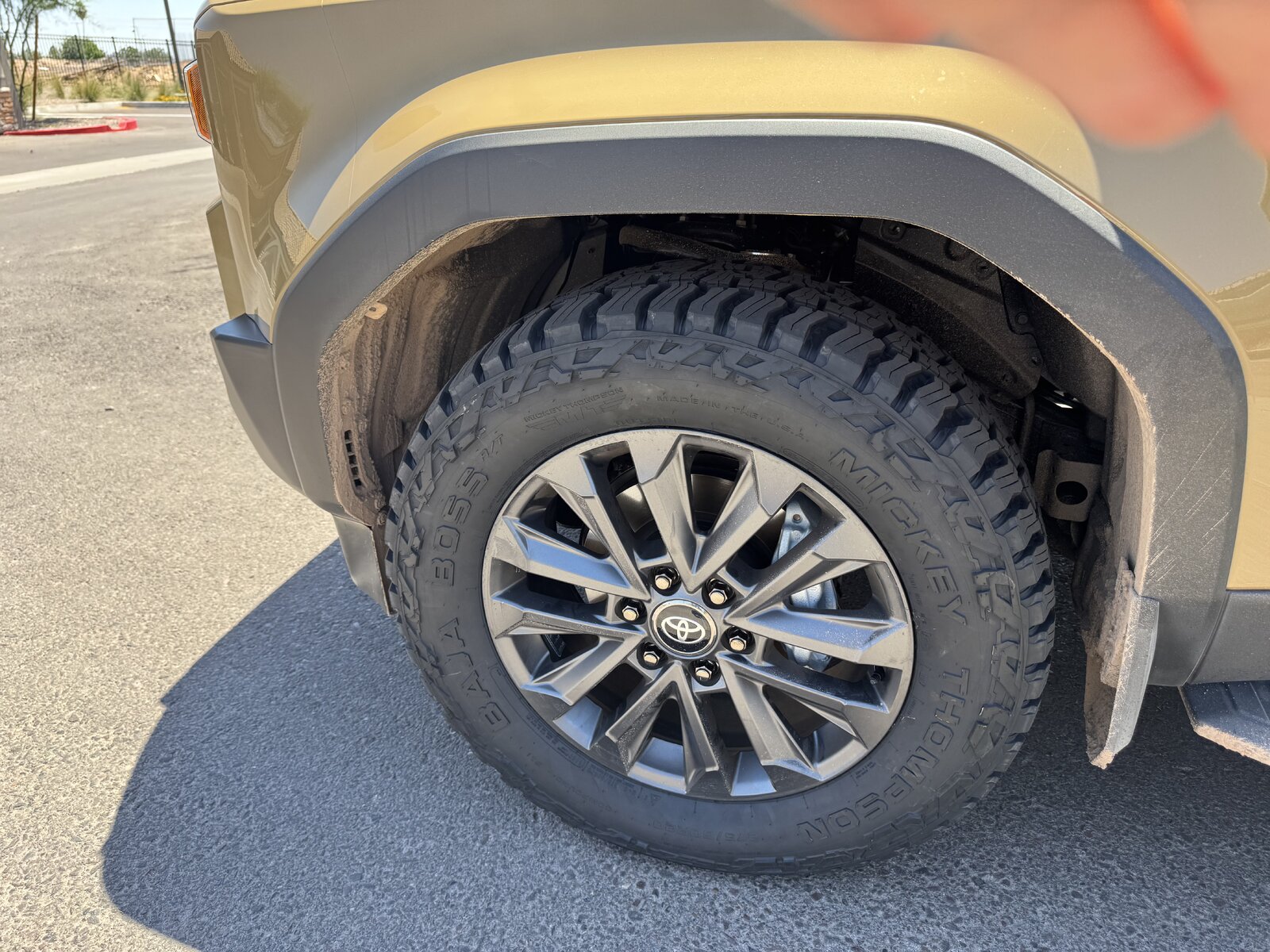

Well, I decided to get the Micky Thompson, Baja Boss 275/60R20 tires. Very pleased with the results.

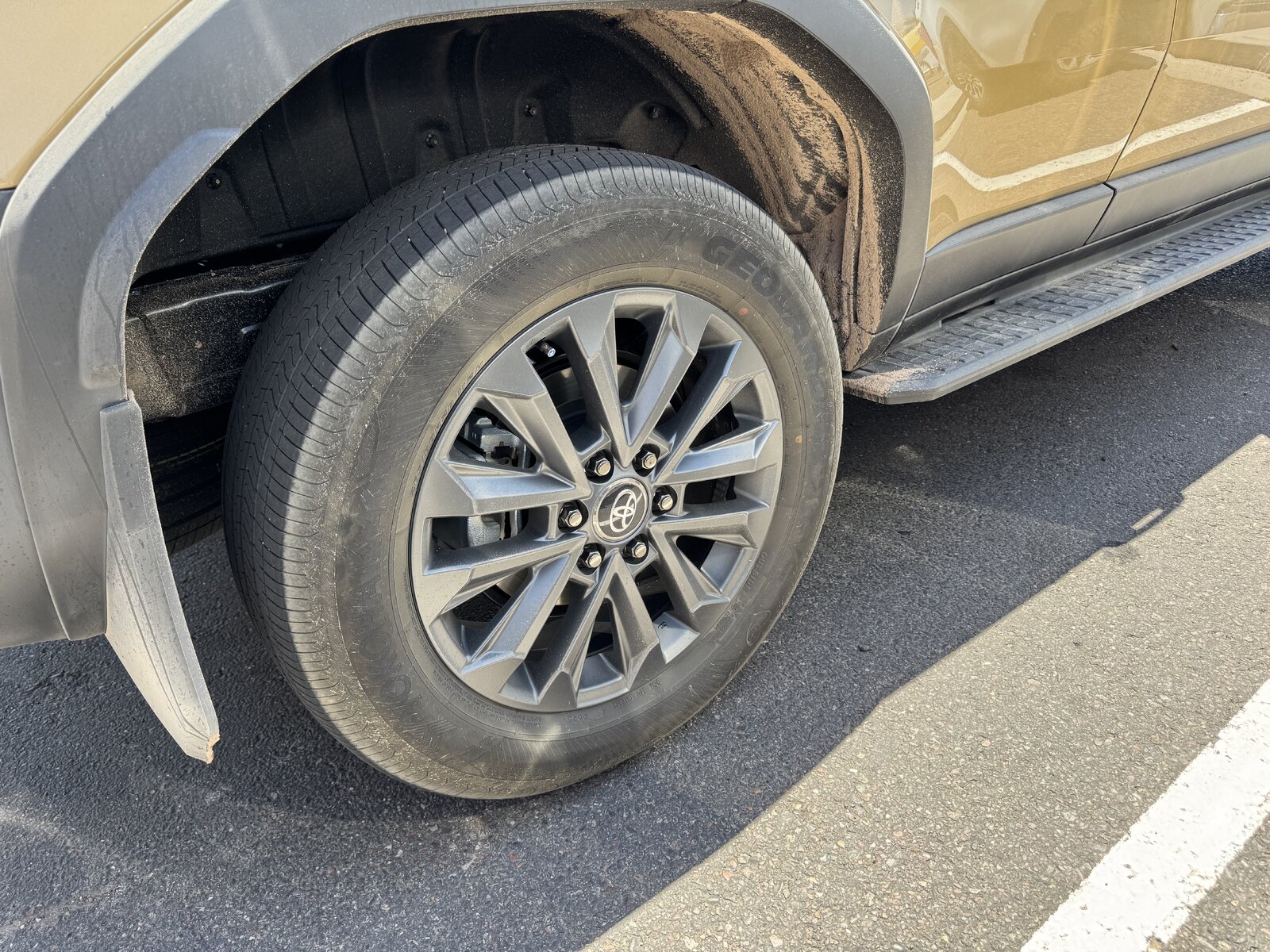

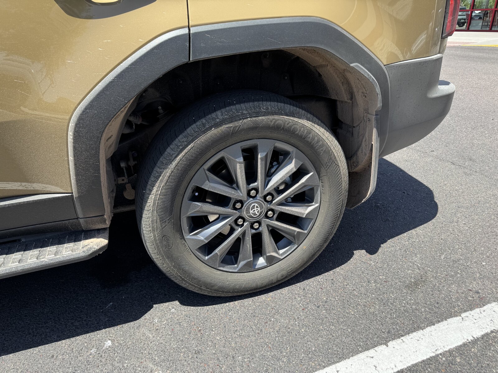

OEM Yokohama Geolandar X-CV
265/60R20 Diameter 32.5” x Width 10.4” x Sidewall 6.3”. Weight 37.5 lbs. (What was Toyota thinking?)😟
Mickey Thompson, Baja Boss A/T
275/60R20 Diameter 33.4” x Width 10.8” x Sidewall 6.7”. Weight 47 lbs. 😁
On stock 20" wheels. Fits like hand in glove. No mods, no offset. Ashpalt road handling and noise is as good as the OEM tires. But off-road capability is over the top compared to OEM.

They look amazing! I'm looking to replace my OEM tires (same as yours) with better off-road tires. I was also hoping to increase ground clearance. Did those tires increase your clearance?
Based on spec numbers, it should increase the ride height by about .5". By the time you load the LC with accessories that weigh a couple hundred pounds (i.e. rock sliders and other such things) the .5" is negligible.

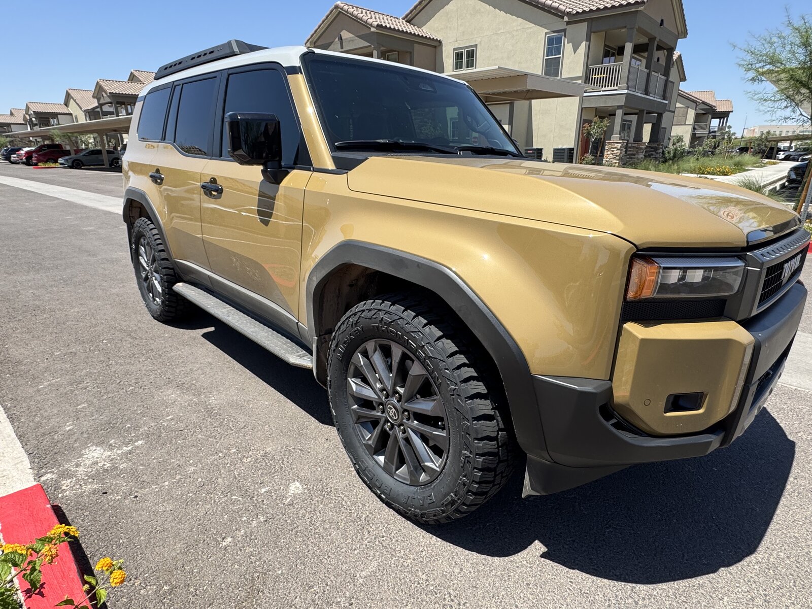

I switched the OEM Geolandars for Cooper Road + Trail in 275/60/20. My Discount Tire shop said they have seen rubbing with 285/60/20 so recommended the 275’s.
I’m happy with it for now, until I lift it.
