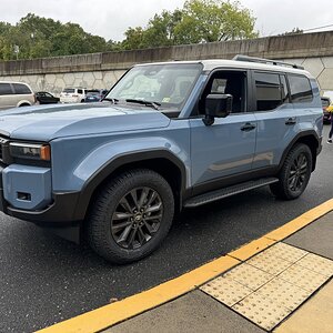

I installed the 275/60 R20 SL Mickey Thompson Baja Boss’s AT and they fit perfectly and the spare also just fit. Another great option and they do well in the snow.

Did your mpg take a hit at all with the Baja’s? What do you think of them so far?

Love them, several other people I know also put them on after seeing mine. I did a Wescott lift kit and the tires and full skids and still running around 22 to 23 mpg’s. Thought I was going to take a heavy hit but they are the SL versions. I’m about 1 mpg less with both.
