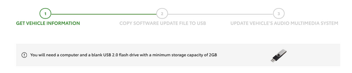

The vehicle may not have a USB-A port, might need a converter like the one below:
USB-A to C converter
I purchased this exact adapter and another type and neither works.
Both adapters with multiple different USB thumb drives formatted in fat32 are not recognized by the vehicle, so I am unable to check for any software updates.

The USB version has to be 2.0. I had to try a few thumb drives until I found one that the vehicle would accept.
I just tried again now. Downloaded my .json file from my 2024 LC FE and searched for firmware. Said I had the latest version already even though Ive never gotten an update and still don't have the sidebar. Wish I could force the update, but the site won't give me files to download unless it detects my versions is older and needs update.
