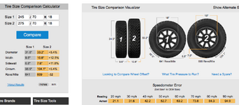

Forgive me if this is a dumb question...
If I go from the stock 245/70R18s to a set of 275/70R18s will I need to account for the difference in speed/mileage because if the wider diameter of the tire (i.e. the larger 275s will mean I'm going faster & farther than what the computer thinks I'm doing with the 245s)?
Width won’t affect the speed difference. Speedometer was very optimistic with stock tires. Much closer to reality via gps with 275/70 r18
tiresize.com is a good resource for figuring out these things.
