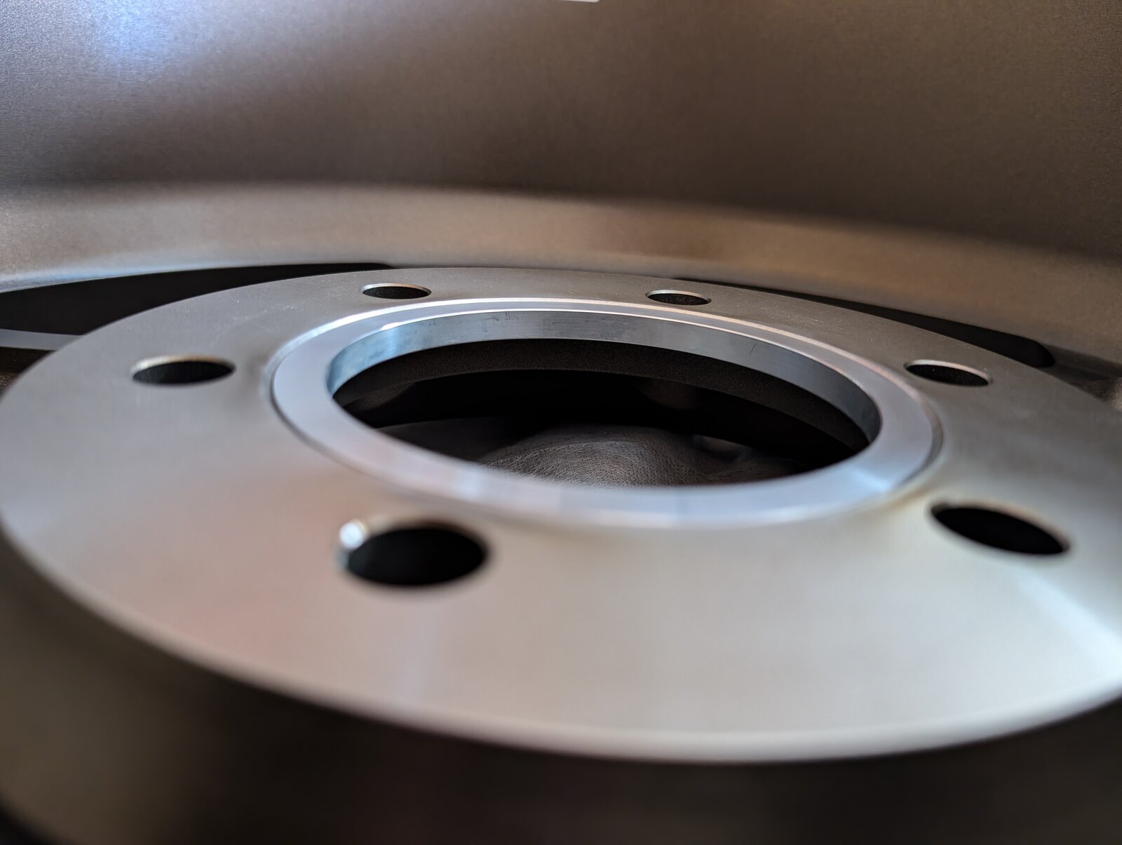

Hub on the Bradleys is 110... which is causing some 'issues' finding the proper hub centric rings, as the ones I have found so far all have a little 'lip' that protrudes on the wheel. I have had a few people say that the wheels are high enough quality that they can be used as lug centric, but I would still like to find the proper rings. One company on Amazon has offered to make custom aluminum ones for $50 Cdn, as opposed to the stock offerings at $25. (and plastic at $12) I could just try and sand down the plastic ones I bought, but then if that doesnt work the custom ones just cost me $10 more.

Got my custom hub rings today, fit 100% perfectly on the Bradley Wheels. Super impressed as they were a vendor on Amazon.

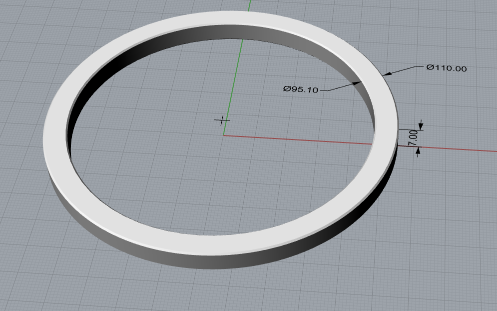

You just send them a message with what you are looking for and purchase the Amazon listing. He sent a complete drawing with the approriate info.
Basically you need: 95.1-110mm in a 7mm depth (Stock is 10mm) I attached the photo they sent (This would be specific for Bradley Vs)

how did you contact them.. im not seeing a way to message them from amazon unless im blind lol..
I believe I went through the 'ask a question' /Rufus chat but I believe you can also just buy and they contact you for the sizes.
