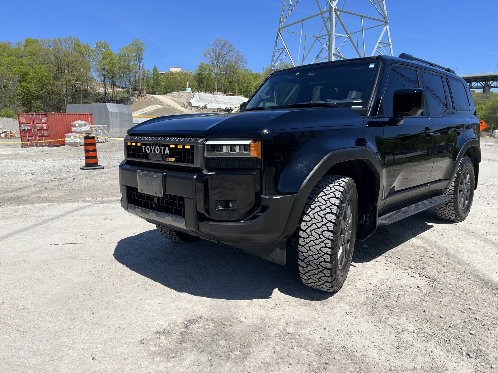

Ceramic is the way to go. I did 15% onto the back windows because I didn't want anyone looking in to see what is innthe back. Front window to keep legal I had to go with 20%. I also did 20% on the sun roof.
