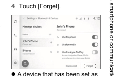

That’s a lot of work to do when all you have to do is go into the menu and flip it back on under use for Apple CarPlay. See attachment.
From experience, sometimes that works, sometimes it doesn’t. It’s been hit or miss.
Same here, it worked for me for a month or two, then never again.
