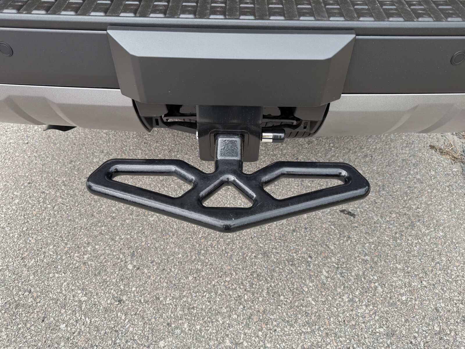

I did some significant mods this morning- removed the diaper from the rear bumper to install my Schittybilt beaver step (left over from my old Jeep) with the half diaper. The step discourages parking by feel. Second time lucky finding a locking hitch pin with a span wide enough for the Land Cruiser’s receiver. 3.5” was not wide enough.

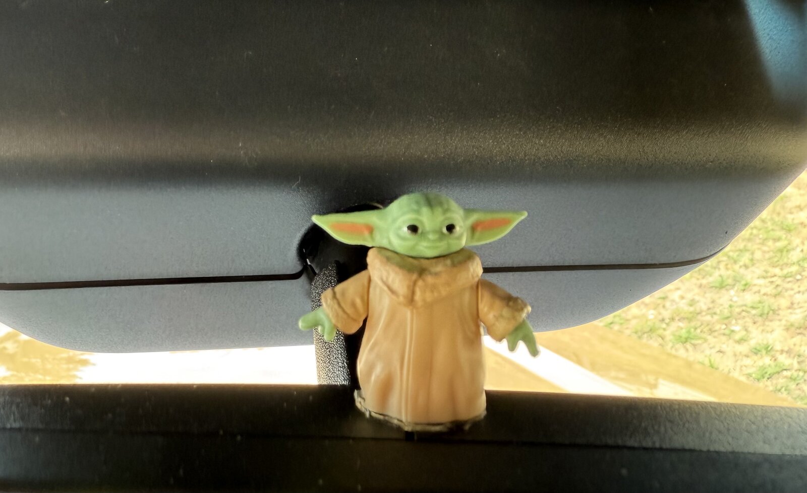

…and installed a Toy Yoda on the rear view mirror.

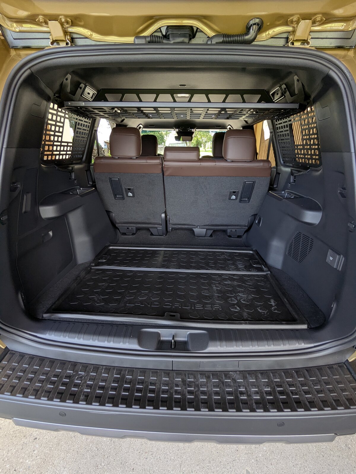

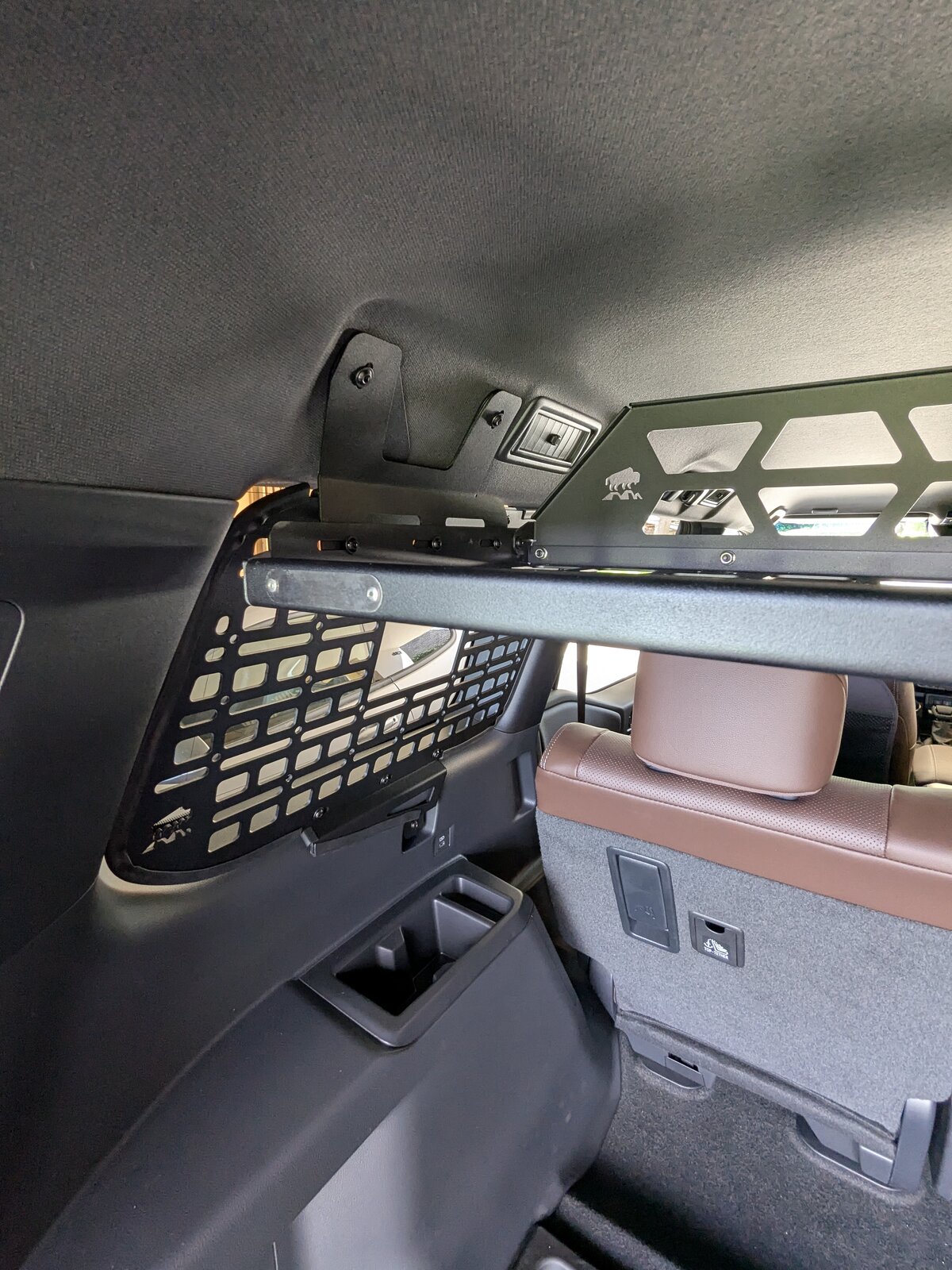

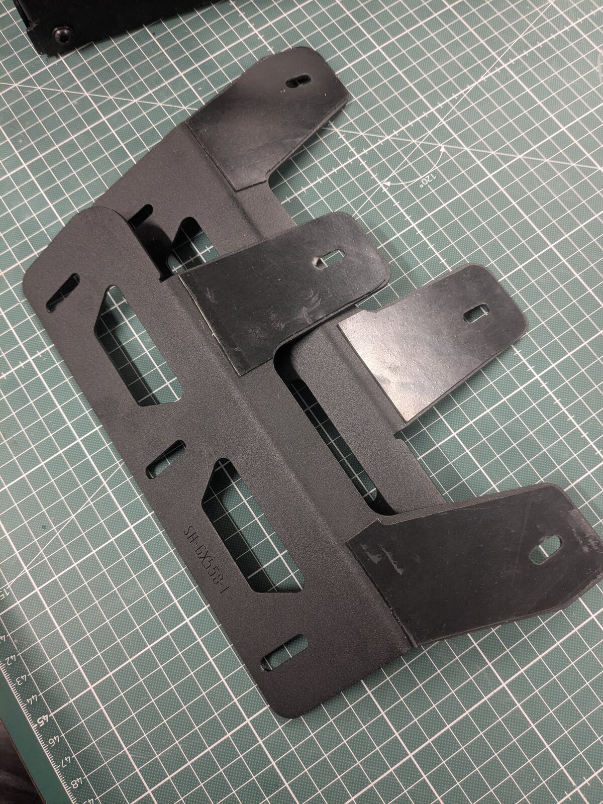

I finally got my new LC on wednesday. I've spent few hours installing Bison molle panels and shelf.
As I read that some people are complaining about rattling I've added some rubber padding between brackets (third photo).. I also got rubber profile and put it wherever lower bracket would probably rub against trim (first photo). And just because I bought extra I added it around the edges of molle panel - will see if I keep it (first photo).

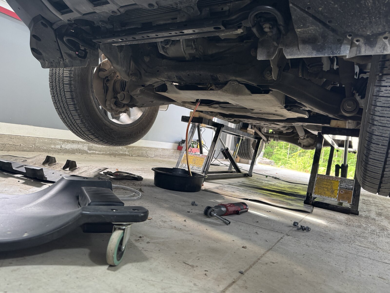

This post peaked my curiosity. I looked at the manual and saw we actually need to grease the shaft more frequently than I expected.
I was surprised too. Basically every service interval. I purchased a Milwaukee M12 grease gun for the occasion and that worked great. I had a manual grease gun and I was always a messy job with that thing.
Re-torquing the bolts seemed a bit overkill. They were all in spec.
well now I have a excuse to go buy a new tool 😂. I found the chart and the info that if you do any “water crossing” to grease it in 24hrs. Can’t find the torque spec part, was that in the smaller maintenance manual?
