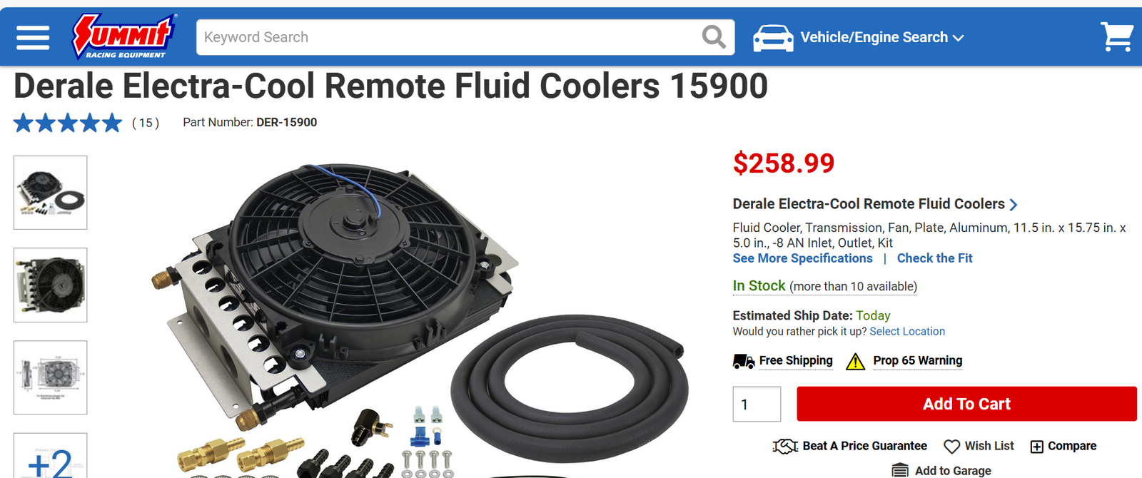

You’ll be in good shape after you add an auxiliary transmission cooler, it will probably help out in low speed off road driving too when the torque converter is unlocked. Particularly that linked unit with a fan, if you have a toggle switch to activate it you could keep temps where you want them even at very low forward speeds.

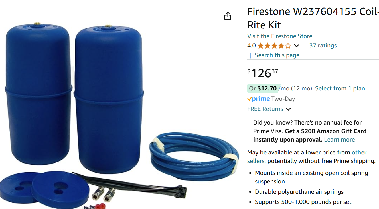

If you are at all worried about weight droop, I have used these helper bags in the past and they work very well. When de-aired to 1-2 PSI the stock suspension works as normal. When air'd up, my Sennia had no "Carolina Squat" at all. Super easy install.
Thanks - I’ll see how it levels and sows and keep these in mind.
Previously, the load distribution hitch is all I needed to keep everything ice and level.

I didn't need the load hitch after the bags were installed.
Just about any repair shop would be able to install a Xmsn cooler in series with your current cooler. It is a very DIY install. The hardest part is deciding where to mount the cooler. The one below is pretty much a complete kit minus two wires for the temp switch. Xmsn coolers with a fan do NOT have to be mounted at the front of the vehicle. The only important requirement would be ..... unobstructed air passage .... you could mount it in any position as long as it can draw and expel air. As an example under the hood, under the body. Now if your a mudder, under body would not be my first choice. If driving in mud every once in a while, no big deal, just insure mud isn't caked up before you start towing.
W/O physically having hands on the vehicle, there seems to be plenty of areas above the skid plate for unobstructed air and protection from mud, gravel etc....
In addition, I recommend a second manual switch (key on) be incorporated. That way if the temp switch fails for any reason, you can flip the switch and still go about your trip.
Thank you so much for the info.
I’m planning to get this to install ? What else should I get to prepare one day install plan?
Can I get the specific info/items for the switch and two wires for temp kit ?

I'd wait on the Xmsn cooler to see if your driving habits actually need it. I had it on the to-do list, but have since crossed it off.......... I don't tow with the LC and it seems to handle it just fine without a external cooler.
Additionally, I inquired at the Toyota dealer about them installing one, as not to mess with my lifetime power train warranty ........ they informed me Toyota didn't sell one for the LC, I asked them if they could install one from another Toyota model............ they informed me if I got permission from Toyota they would install one. Which made me shake my head...... "Dude you are Toyota".
I should it ever start to get hot, I'll DIY a cooler.

Most kits come with everything you need to hook it up as an auto temp activation. To put in a secondary manual switch, you will need a relay, a switch and wires. If you plan on putting the switch in a factory "blanked" spot they are the "Toyota Cube" size.
