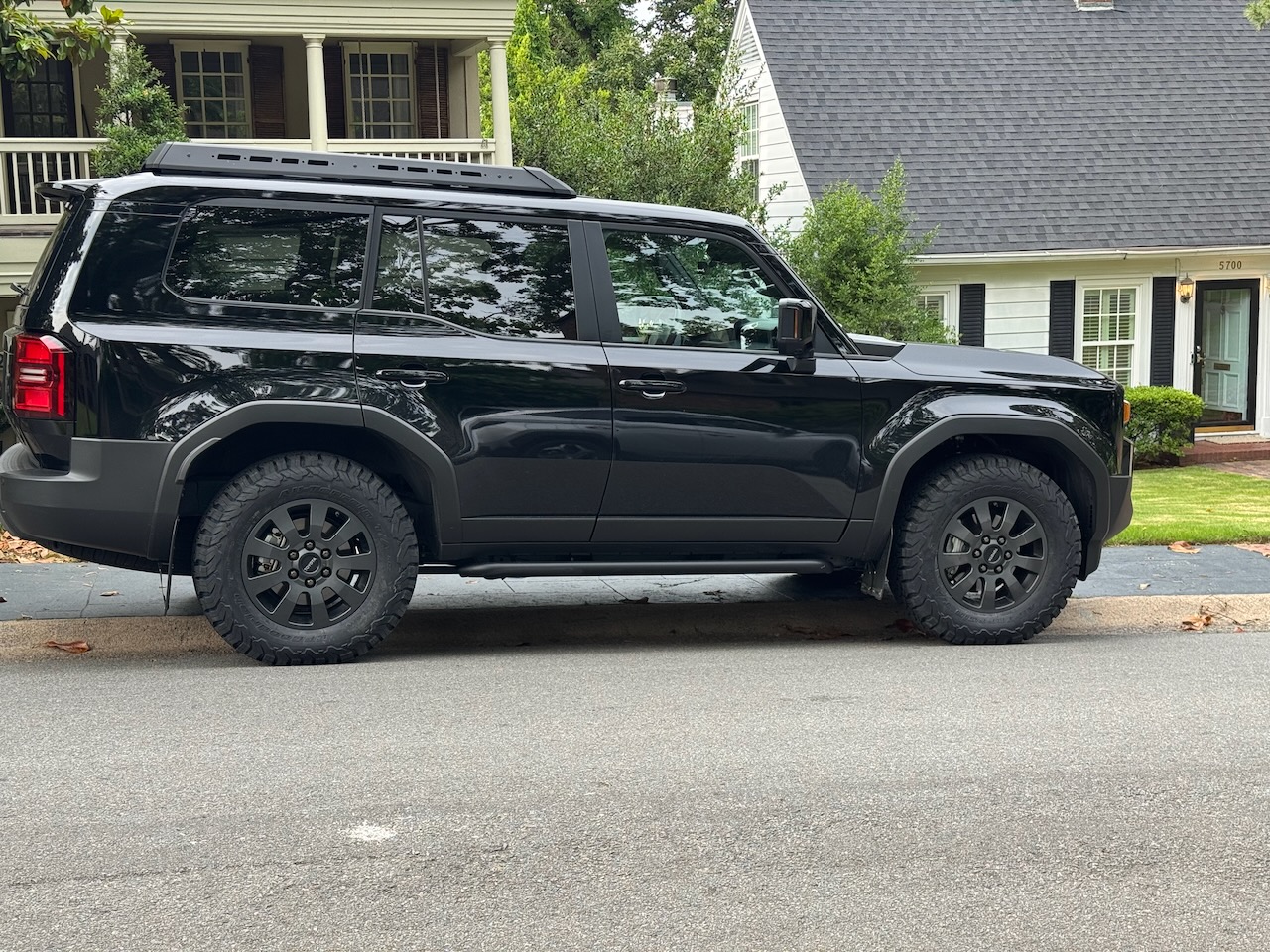

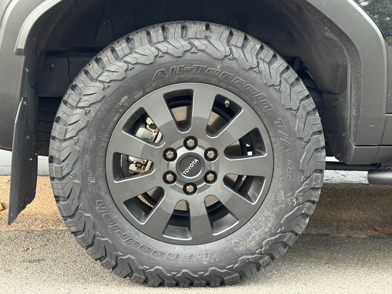

Purchased an extra set of 4 LC/LC dark gray wheels (no TPMS) from FB marketplace and mounted some 265/75/18 BFG KO2's. There on sale at Discount Tire, since the KO3's are not available. Left the Michelin LTX on the spare. Purchased Dill brand TPMS sensors from Discount Tire and had them installed with the tires.
Mounted the new wheels/tires today and did the "Tire Set Switching" procedure as per the manual, page 561. Drove around for 20 minutes and then everything registered. I saved this set at "Set 2", and will be anxious to see how quickly the procedure is when I put the other wheels back on. All good!
Gonna drive them for a couple weeks, then mainly use this set for winter and off-road trips.
