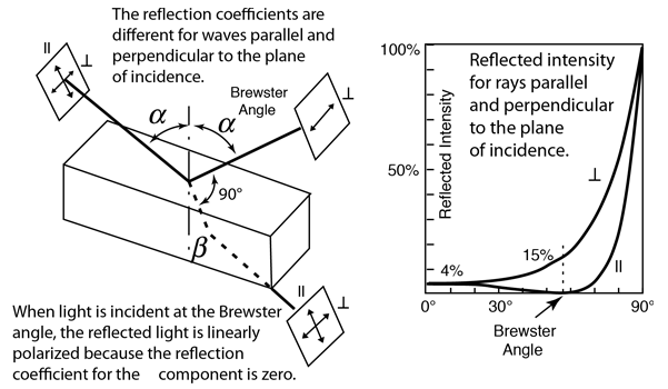

The part I don't understand is that even if the light from the projector was unpolarized, using the windshield to reflect the light will polarize the light -- to a greater or lesser extent, depending on the angle, but still the same problem for most useful angles of reflection.
You can see on that plot, over most of the range of angles reasonable for reflecting an image, you're going to get a very polarized image with nearly none of the vertical polarization being reflected. They'd have to push the reflection off the windshield to a really high angle maybe?
Source for the plot: Methods for Producing Polarization
That's a new concept for me. But, it only shows the parallel and perpendicular components. The light incident would be oriented at every angle in between 0 and 90 degrees. Not mentioned in the figure, but something I think that might make a difference is the index of refraction for the glass.
