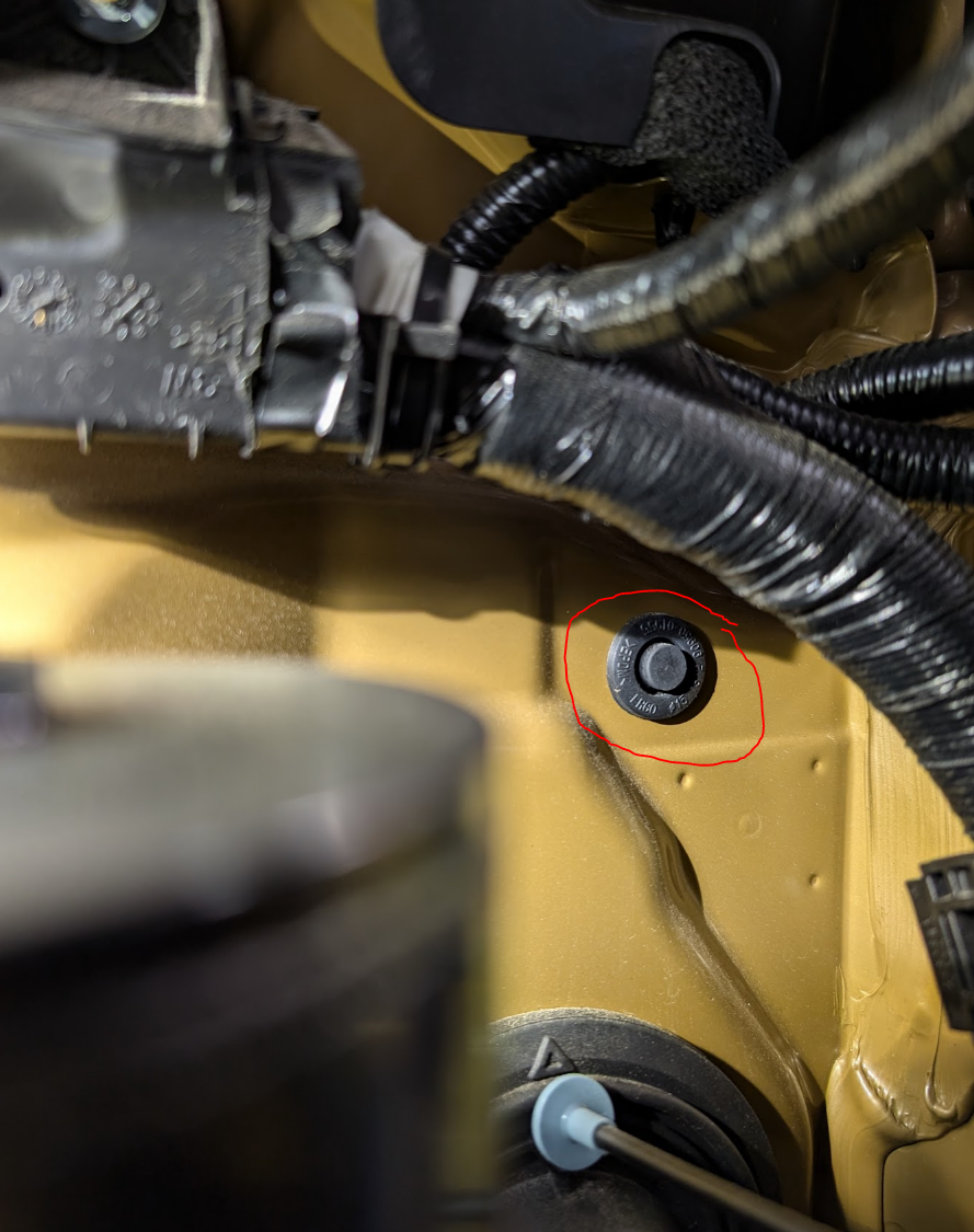

EOD guy - I’ve read the two center console and instrument documents, but not seeing the driver side pass through from the engine bay to the battery. I have my car in with a specialist and between us we’re trying to locate that grommet. Are there any suggestions you can give us please?

Not my pic but here it is..... This only gets you through the fire wall.
