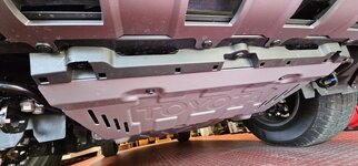

I just replaced the front skid, that piece attaches directly to the front skid then fits snugly against the front. It bolts to the skid and does not bolt to the front. You also should have received the thin metal keeper nuts for the screws. Those are what actually hold the black piece to the skid. If you line up the holes it make sense how it attaches to the skid. It wasn't until I attached it to the skid and held the skid in place that it made sense.

Great. Thanks so much. Saved me a headache from trying to figure out. Weird how it is not even mentioned in the directions.

Thanks! I agree I also thought the directions were rather lacking.
