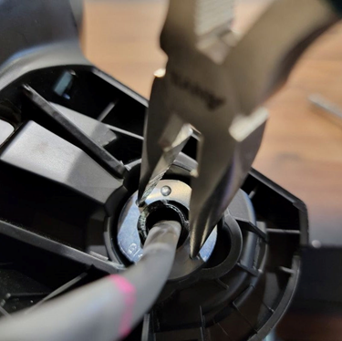

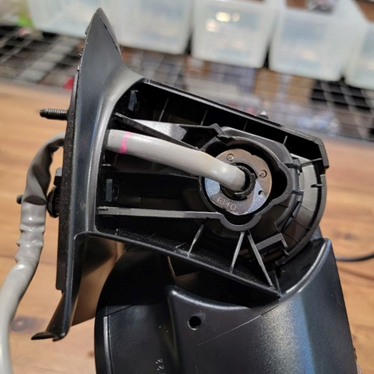

Great solution! I'm wondering if you could remove the mirror and place the shim (think I'd use metal) on the underside of the mount. I've never had the LC mirror apart but other Toyota mirrors have a spring with a bolt/pin/shaft that holds the base and the mirror together. Might be a case where the spring needs to be stretched to apply more tension or a shim to accomplish the same thing.
Your fix would be best.
I was looking into a quick fix with as little drama as possible. Trim pieces and my clumsy use of trim tools usually results in broken tabs and the resultant cussing.
A solid Belville conical spring washer or three, used as shims, would likely tighten up the gap. Of course, once you tear into the project, you would be down a mirror until you sourced the correct washer/shim. Possible items: Source for spring washers and Shims

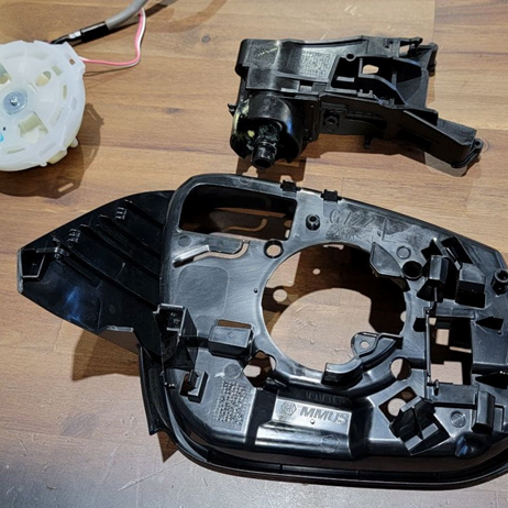

@EOD Guy Do you happen to have the glass removal procedure? It says click here in the pdf, and was hoping there is more detail on how the trim tabs hold it the glass on specifically. I've pulled/pushed/pried on it in a few directions but am nervous to break a tab.
The glass has plastic tabs/mount glued to the back. If you tilt the mirror upward as far as it'll go and look into the wider part, you can kind of see them. The mirror back is held into the tilt plate by friction and so no way to disengage the tabs. So ya gotta pry it off in a specific sequence.
It's kinda of scary the 1st time and NEVER use a metal prybar!
Are you planning on trying to shim the pivot point? If so you shouldn't have to remove the glass, once you unbolt it from the door the keeper should be right there.
Thanks for those details. Hmm, I don't see the sequence you mentioned in the pdf's. Did you have to learn by peeking through the gap? I'm exploring adding a heated mirror glass for my 1958. Was hoping to access what the wire harness looks like with the glass removed.
Sorry, some how that PDF didn't upload, it's on Pg2

Does anyone know if the mirror housing angle can be adjusted? I recently learned that the default angle of the driver and passenger mirror housings are different. The passenger side is angled more toward the vehicle, making it more aerodynamic. This is why there's less of an issue with wind noise and vibration on the passenger side. I'm wondering if the drivers side can be adjusted to a similar angle, assuming the glass can still be angled to provide a good view.
Not sure on the LC, but on the Tacoma mirror there is a shoulder on the pivot shaft that has, what I call a spring loaded detent. The pivot shaft is held together by a locking collar held under heavy spring tension.
