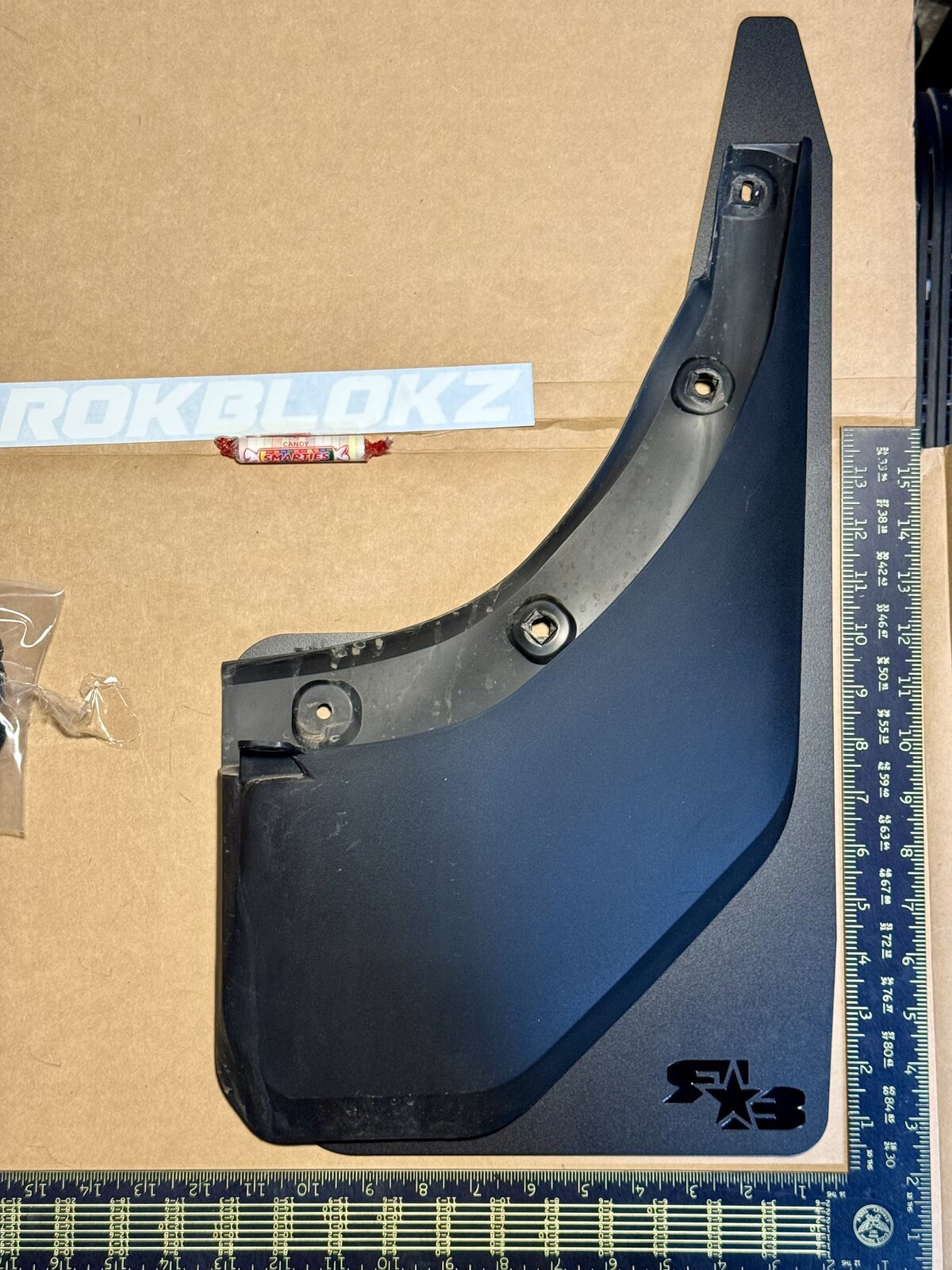

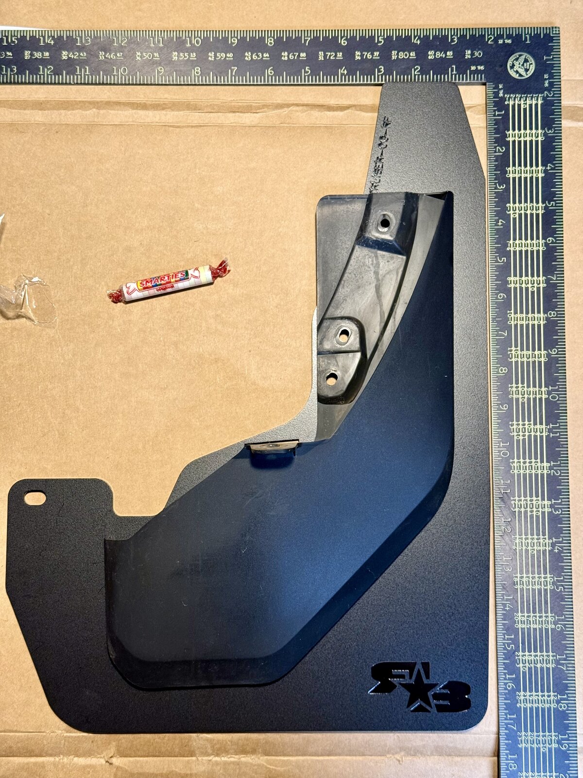

I have a ‘25 LC LC Premium package. I took off my mud flaps today and lined them up with the standard size RB flaps I’ll be installing. Fronts look about an inch wider and longer. Rear flaps are maybe 3/4” wider and just a little longer. I might not have had it lined up as well.
View attachment 28629View attachment 28630

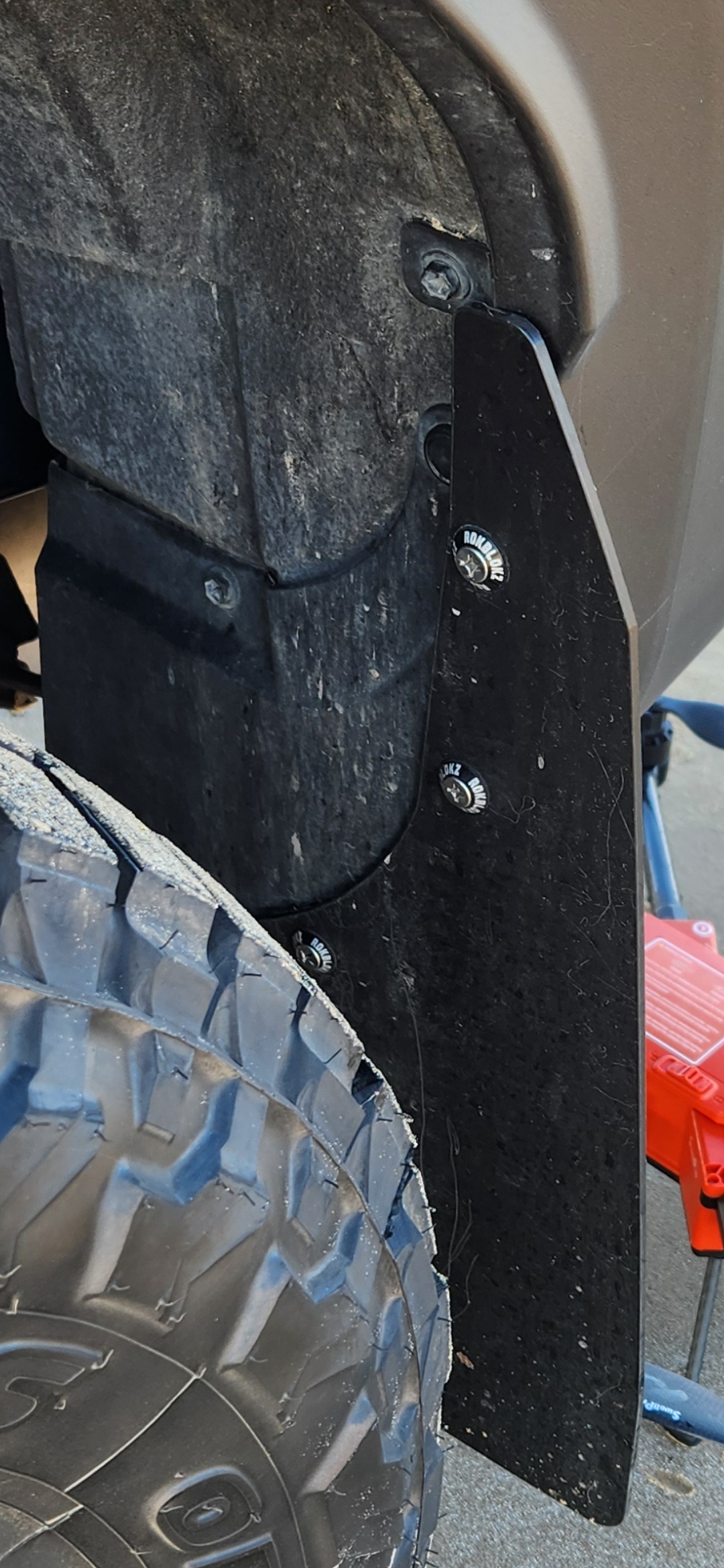

So when mounting on the 1958 you're just missing the top bolt on the front mud flaps? Any mounting points missing on the rears?
Yes, but I ended up drilling a small hole and getting that top 3rd screwed in, very easy fix...

Can you post Pic of hole you drilled
First, install the other screws, it'll hold the mudflap in place. The top hole needs a small hole drilled.
Pick a drill bit slightly smaller than the screw. Then use that empty hole in the mudflap as a drill bit guide

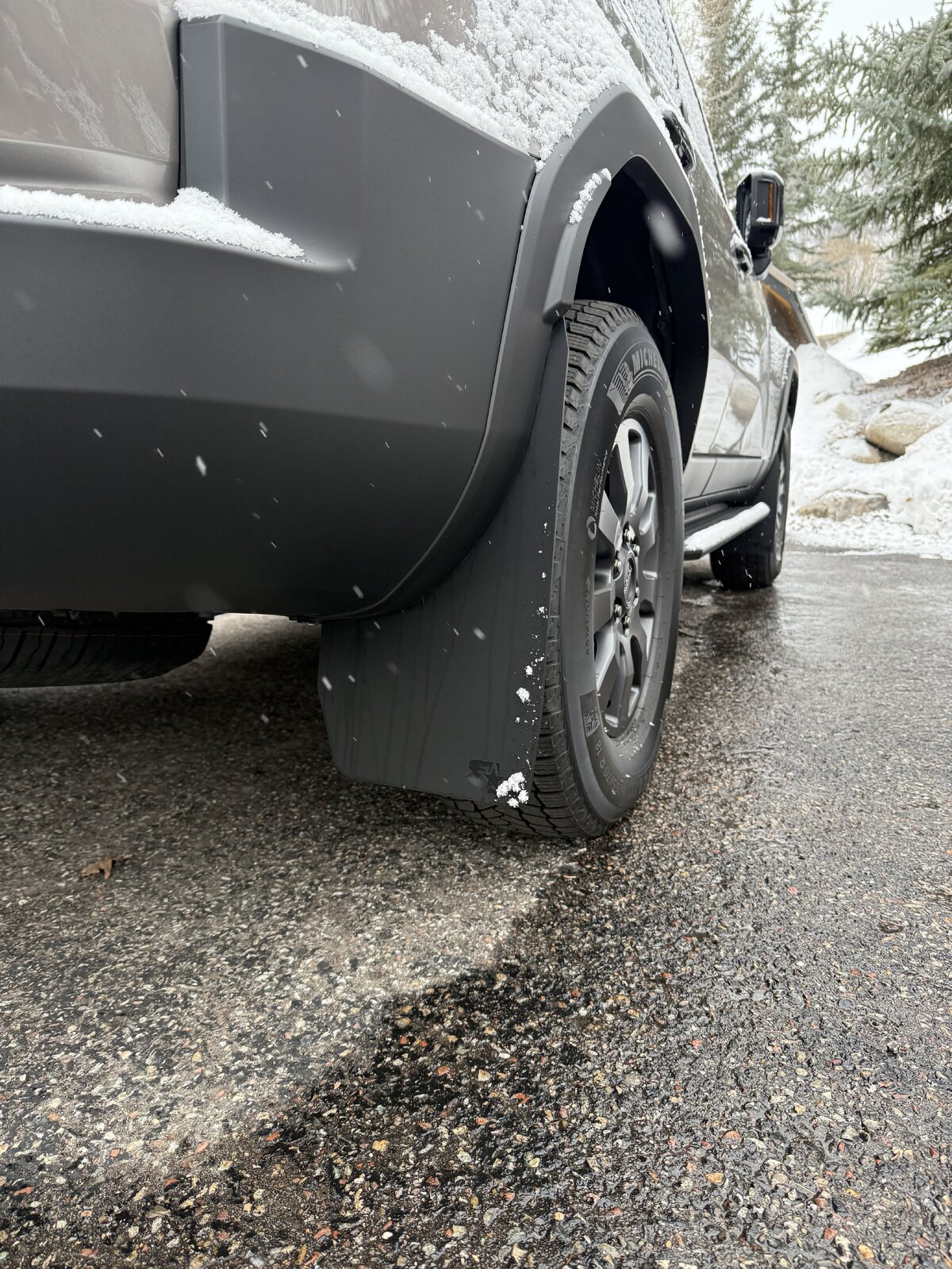

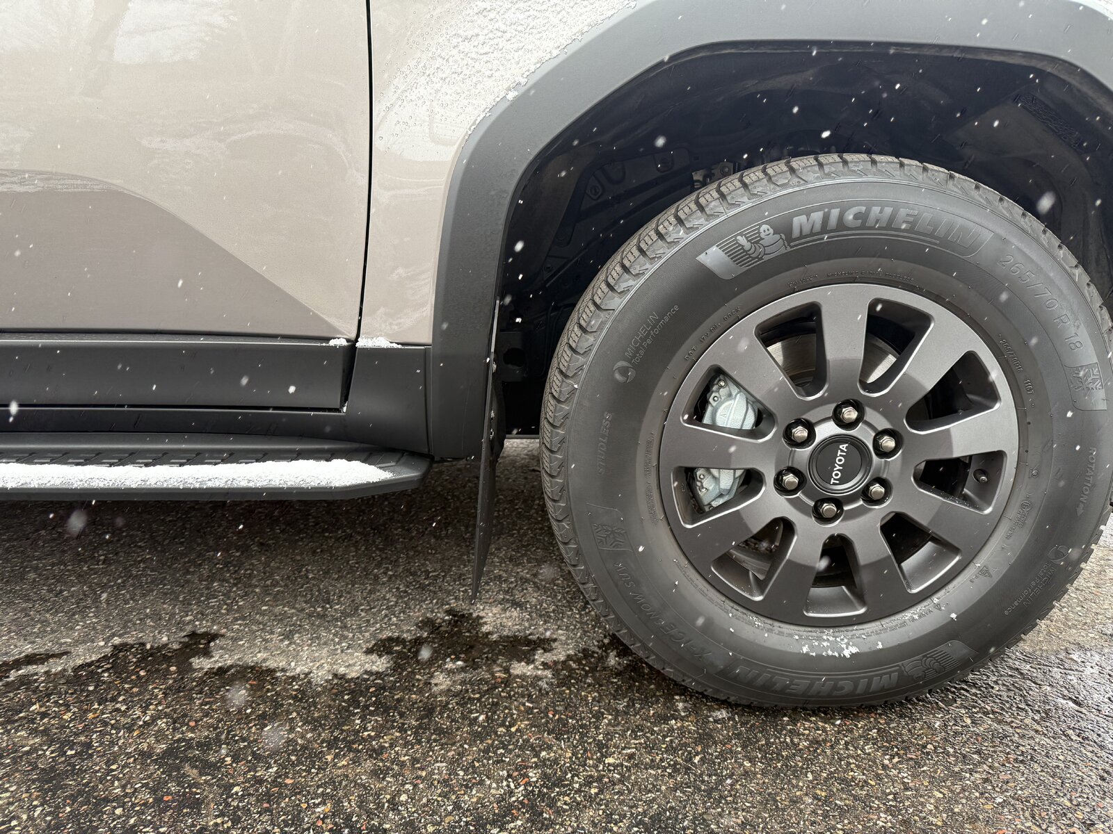

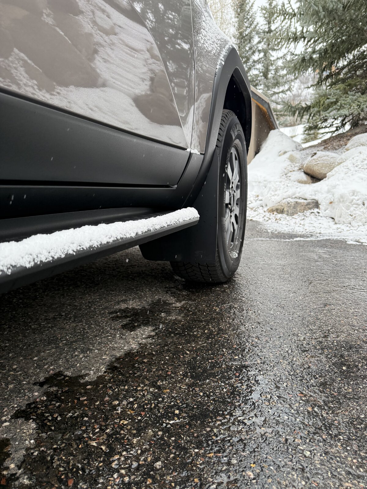

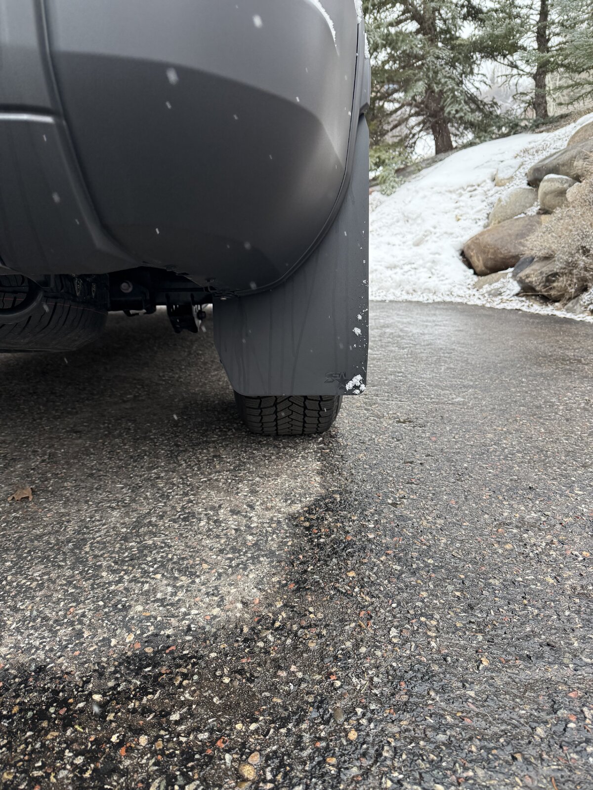

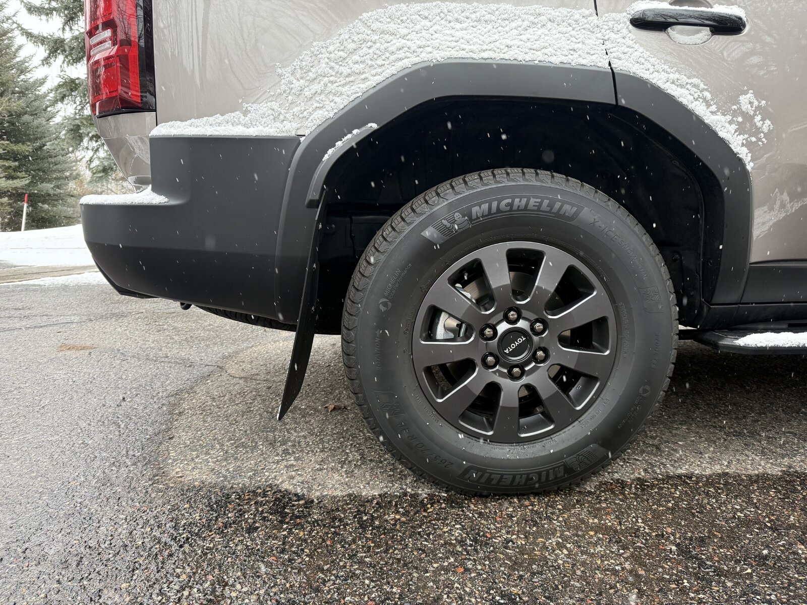

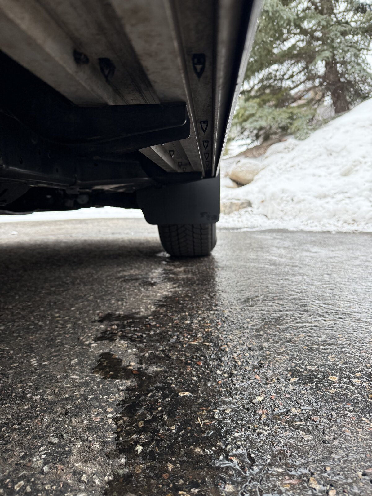

I’ve had mine on for 1,000 miles or so and have been great. Easy install and much better coverage than stock. These are the regular size on LC premium stock wheel and 265/70 R18 tires / stock suspension for reference.
