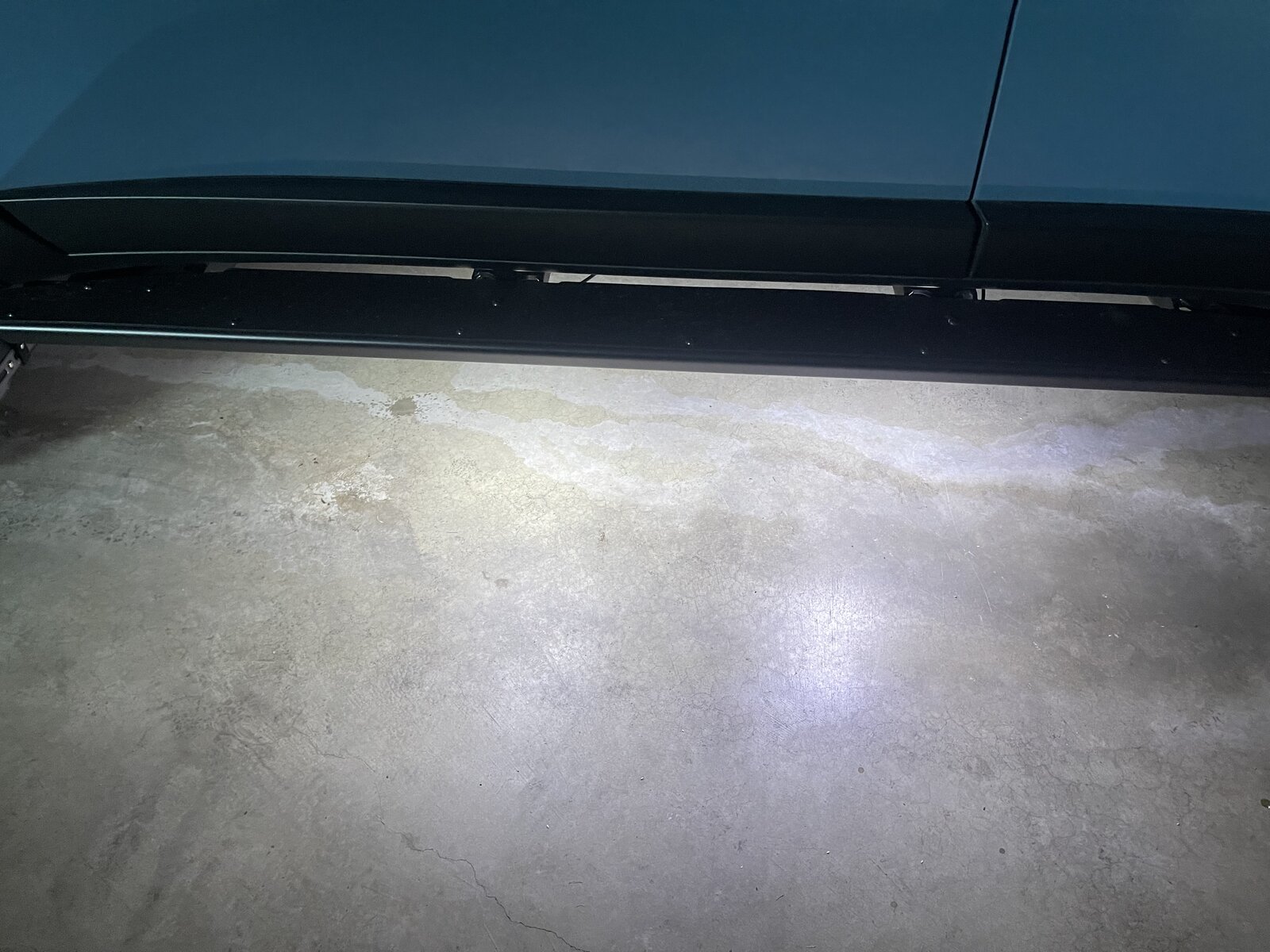

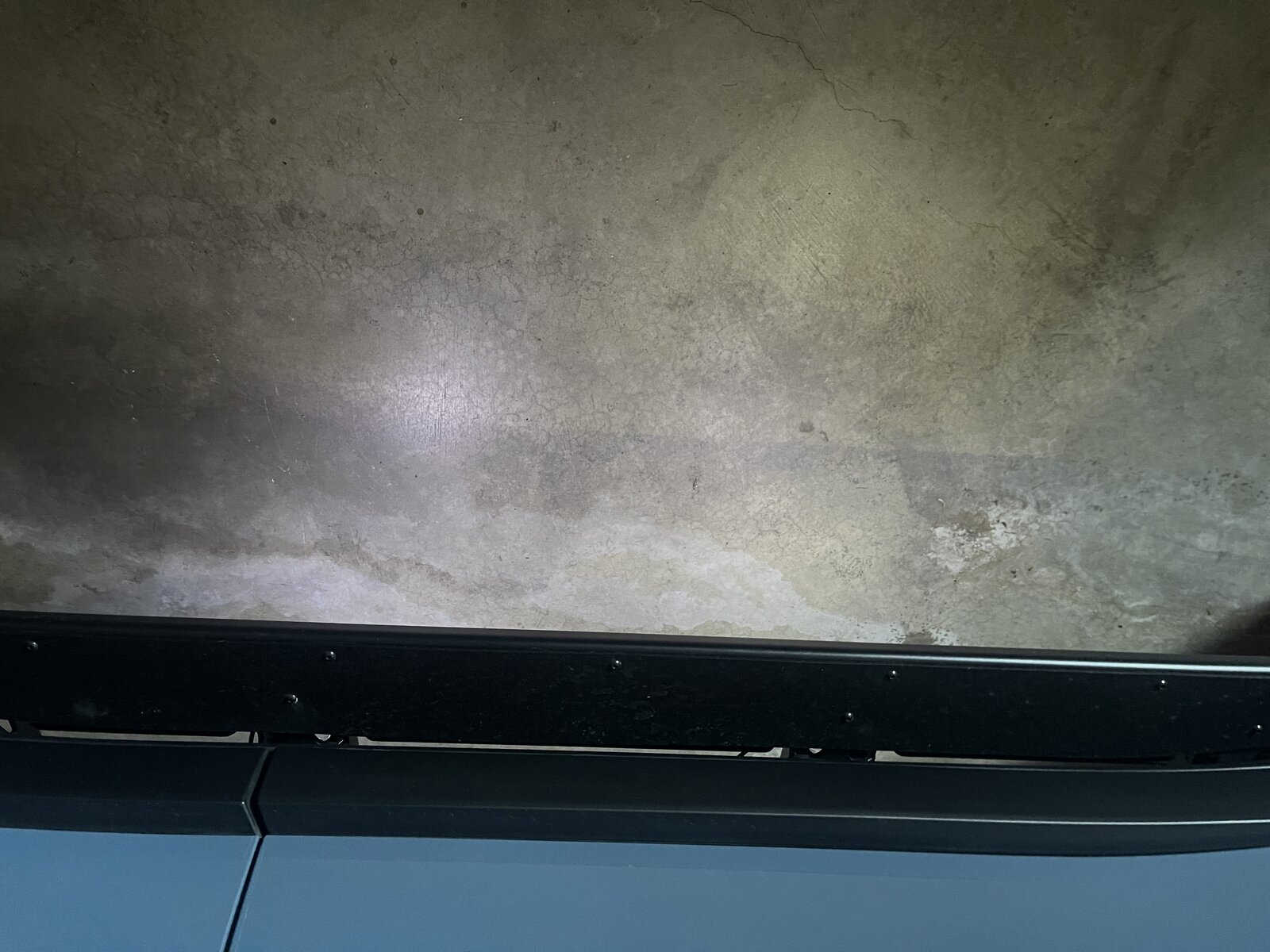

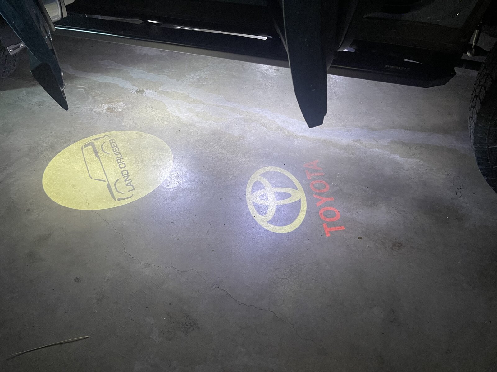

I installed the rails and kept the wire harnesses/lights zip tied up underneath to where they still shine down on the ground when the doors are open. I ordered several parts people said would work to plug the wire harness after removal in order to protect it and none of them worked. Dealerships were of no help at all.
The parts needed to blank off the plug are in the first pic, ordered from CorsaTechnic, Search Results .
The magnetic lights in my pics are from Lux Lighting systems, I used two per side and I wired them into the dome lamp to get full brightness as the OEM harness has +12VDC and variable +9VDC to +3VDC on the ground. There is a pass through under both the drivers and passengers seat to right where the connector is and runs up just under the front outside seat rail on either side. MICRO RGB Pro Series Magnetic LED Light Pod 4 Piece Set
