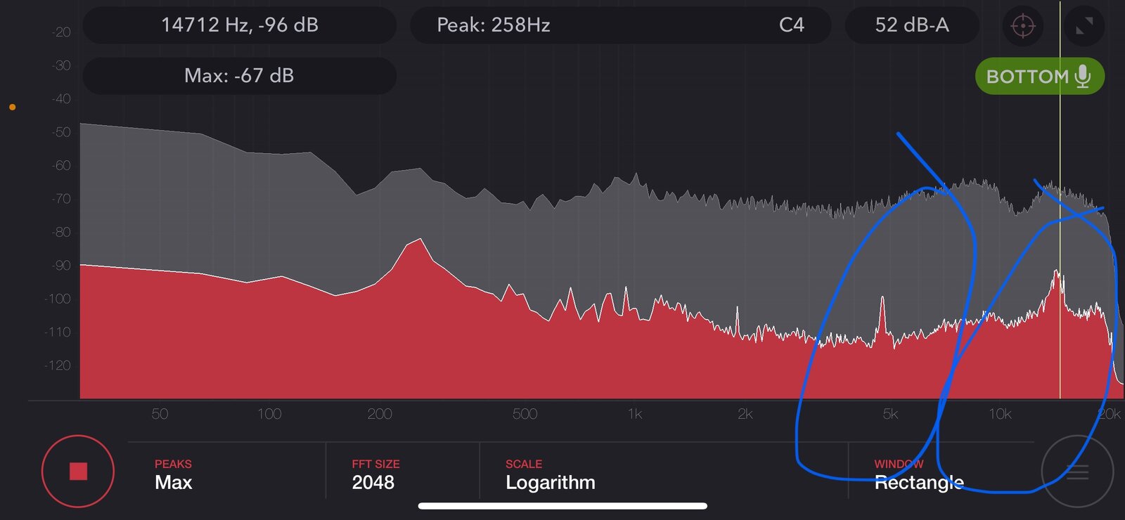

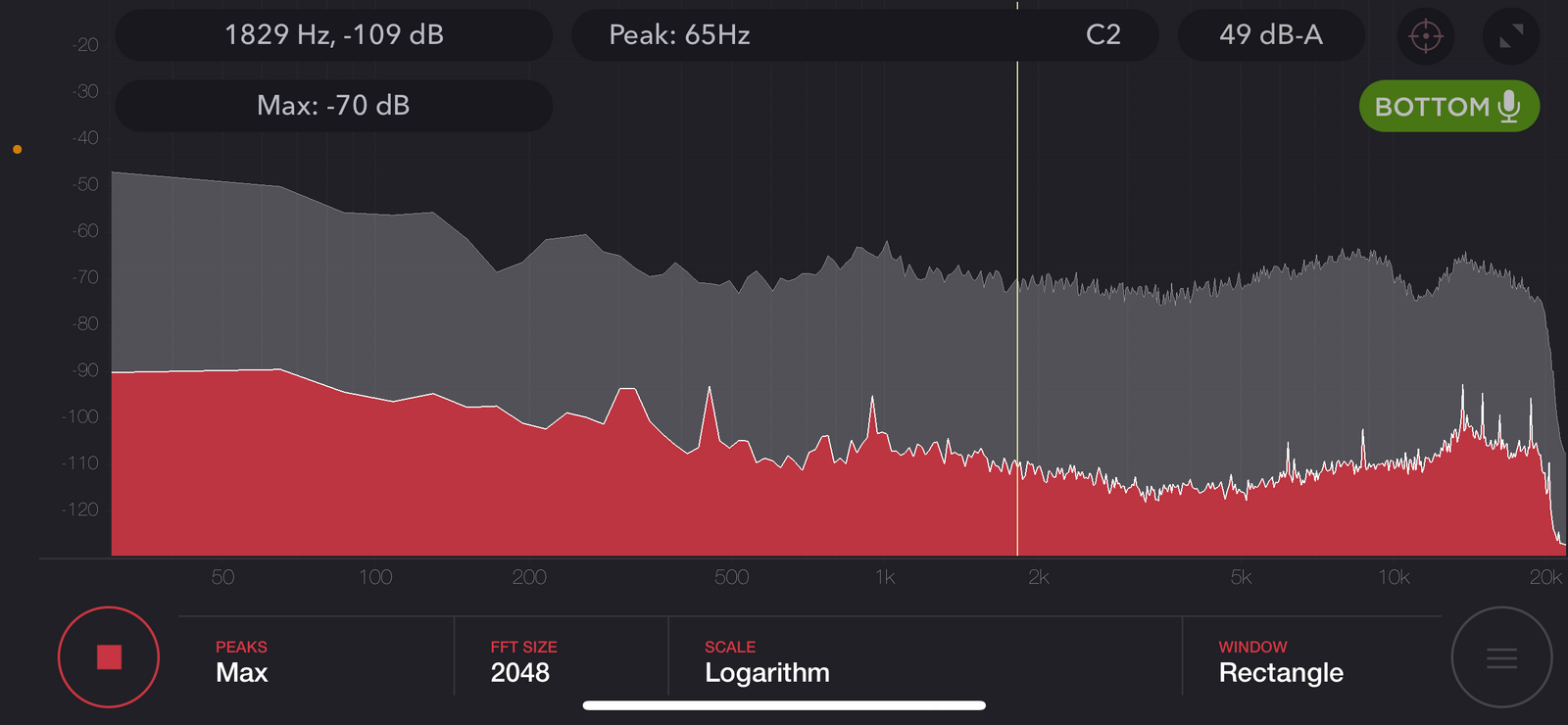

I downloaded an app on my phone that records sounds. In the first picture towards the right there are no spikes. The second picture represents when I can hear the noise. It has spikes around 14,000 hz. I’m thinking this is why some people can’t hear it (the guy at the dealer said he couldn’t hear anything). I took it back to the dealership and rode in another LC. I couldn’t hear the noise in that one, so I know something is up with mine. This graph proves I’m not crazy!
View attachment 4934View attachment 4935
My hearing cuts out around 10,000 hz so I wouldn’t be able to hear it but my wife or daughters would tell me I’m sure. Need to find a technician at the dealership less than 30 years old with good hearing so they can confirm to the dealership what you’re hearing.
