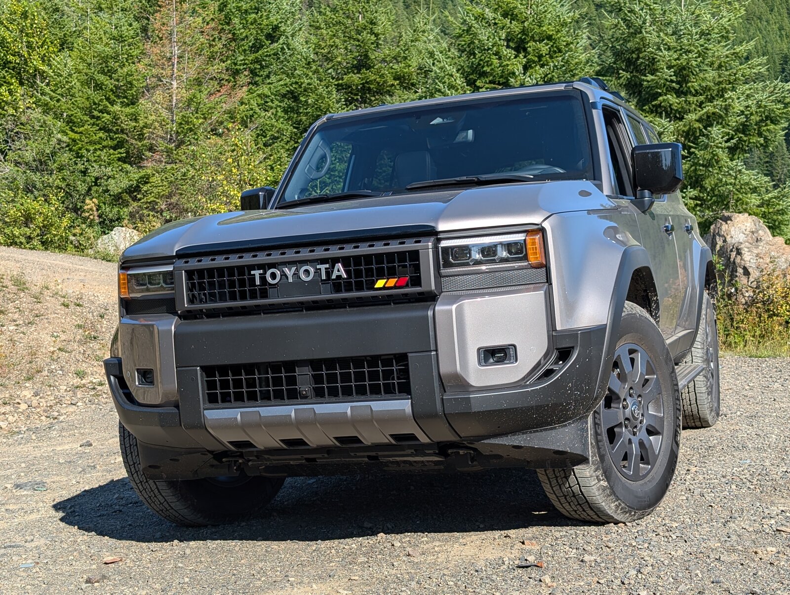

After removing the shroud like @EOD Guy suggested, I used a small ratchet along with an extension and deep well socket to install mine. Was pretty fiddly to install with the grille shutters in the way, but I'm happy with the result!
Is your badge backwards? I thought the yellow was at the end or does it matter?
I need to know before I install mine 😆
I've never had it completely off and it looks quite involved, not hard but a lot of pieces.
I've seen it yellow/orange/red, but I'm certainly no expert! Not planning to change it, because it was a PITA. :LOL:
I bought the TRD badge, tried for 30 minutes to get it installed, and finally gave up. No badge for me unless I get really bored and creative this winter.
I could not figure out how to get in there as well from the radiator side because of the louvers. However, I went to the hardware store and purchased wing nuts. I used orange Loctite to set the screws into the badge, followed up with the bolts that came with it. Then, the wing nuts were a little wonky, as they would stop. So, I ran them all the way down to straighten out the thread. Then, if you have them on the far end, you can slip one side in the front and turn out the other side and put the plastic holder in place with and the wing nut. Then I reached in the front with my fingers and tightened them it up, making sure to put some more Loctite where they would be sung. VIOLA!! My first mod!
