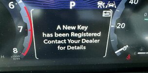

Every time I start my Land Cruiser using the Toyota app for for remote start, I received the following error. My car still works fine and the message goes away eventually. Does anyone know how to fix this?

If you bought your LC in the last 10 days, manual states that warning will appear for approx 10 days after a new key is programmed (like the digital key in the app)

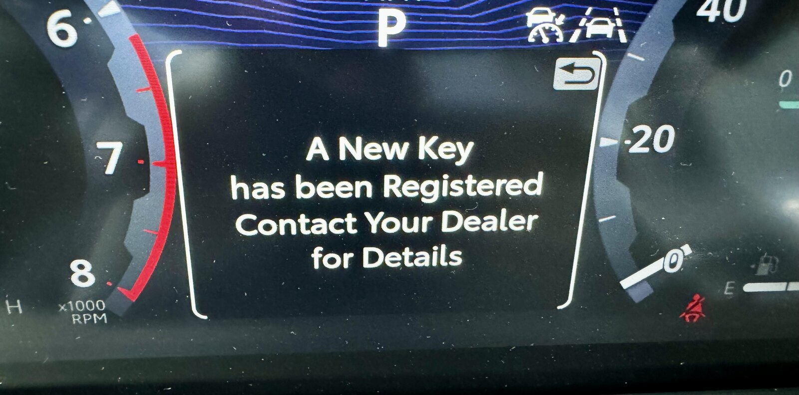

You will continue to get that for a few days after setting up the digital key. Eventually, it’ll go away.
