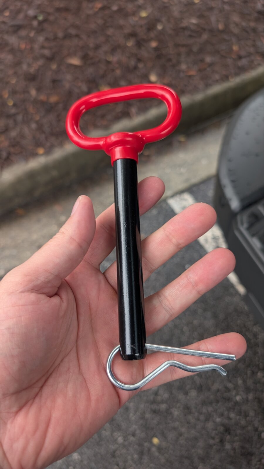

I found this a Harbor Freight for anyone stateside... Not sure if the weight rating, but it's steel and I suspect it will work for most anything light you are trying to tow.
View attachment 39044I found this a Harbor Freight for anyone stateside... Not sure if the weight rating, but it's steel and I suspect it will work for most anything light you are trying to tow.
That's not an "anti-rattle" hitch pin and would bugger the threads in short order.
