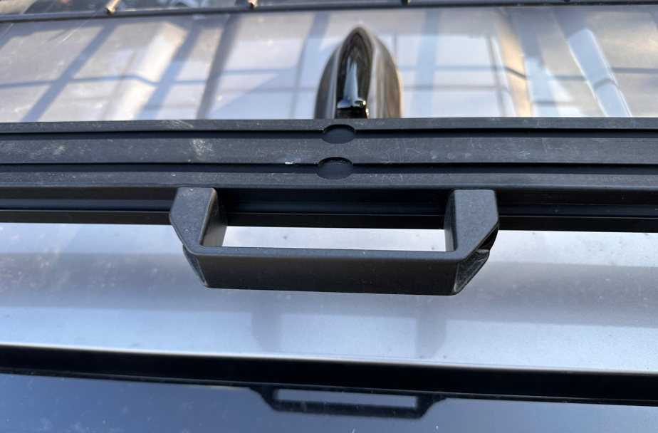

The handle I installed on my Prinsu Pro might work better for you. They look like they might extend further out than the Prinsu ones and are hell of a lot cheaper and you can grab from underneath if you are desperate. The picture below shows where I have one installed on the last bar but I also have them installed on the side. That might be a challenge now that you have the RTT installed but it might be possible.
What a great idea! I knew you folks would come through with some great solutions!
Where did you get that handle?
