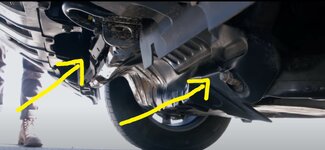

OK, might as well make my first post on the forum here. Happy to be here and answer questions. There are obviously different ways to design a product. Our number one question we get asked in regards to skid plates is what is involved with changing oil. We have found that by splitting the front plate in two pieces that it makes it much easier to remove the front plate to access the oil filter vs. working through an opening. It it still only 4 bolts to remove. So we option to address that design criteria.
Merely saying a skid plate that bolts to the tow points will be better does not really address the issue. The radiator would not be better protected unless you add an additional crossmember or sacrifice a lot of clearance. See attached photo. The tow point bolt locations are a good two to three inches below the radiator cross member. Now if one tied those together with some sort of cross member, yes that would be a way to protect the radiator more. Or even if you ran the plate from that section back it would not be close to the radiator, but you are also giving up a lot of ground clearance.
That hit that the vehicle took was pretty substantial. See the screen shot. The factor skid was pushed so hard the eccentric punched a hole it in and the radiator cross member appears to be bent. Not sure there are many skids that will take that impact. Not saying there is not, but there has to be a balance on designing for a outlier or the mass market. We chose to go for clearance and allow the user to hopefully stay away from impacts easier. ''
