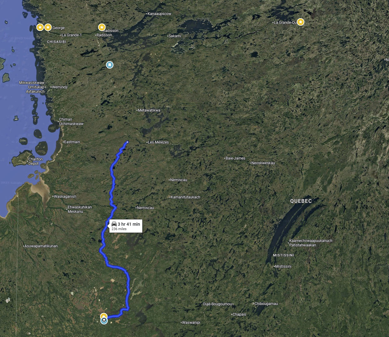

As soon as I "sign in" to enter the backcountry at Matagami I won't even be able to make it the first (easiest) paved leg up the James Bay road to Relais Routier to "start" the trip as that is a 236 mile leg. I'll need to get into a fuel jug before we even reach the first stop.

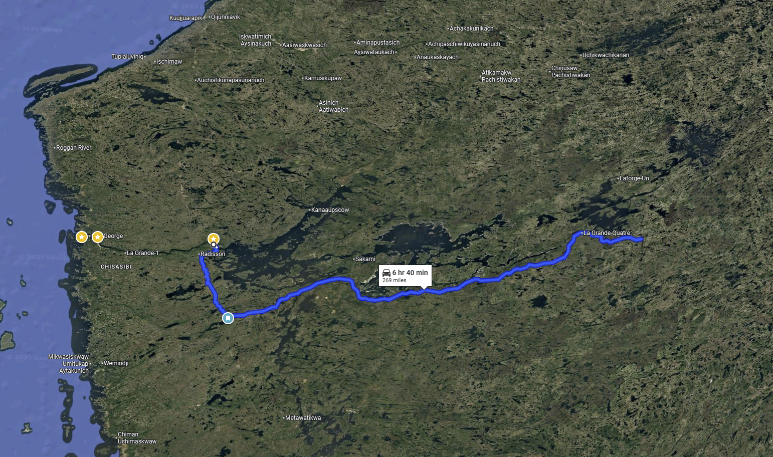

Then after visiting Hudson Bay and Radison I can't make it from Radison to the next remote fuel stop which I understand is a pretty informal/remote place about half way out the Trans Tiaga.

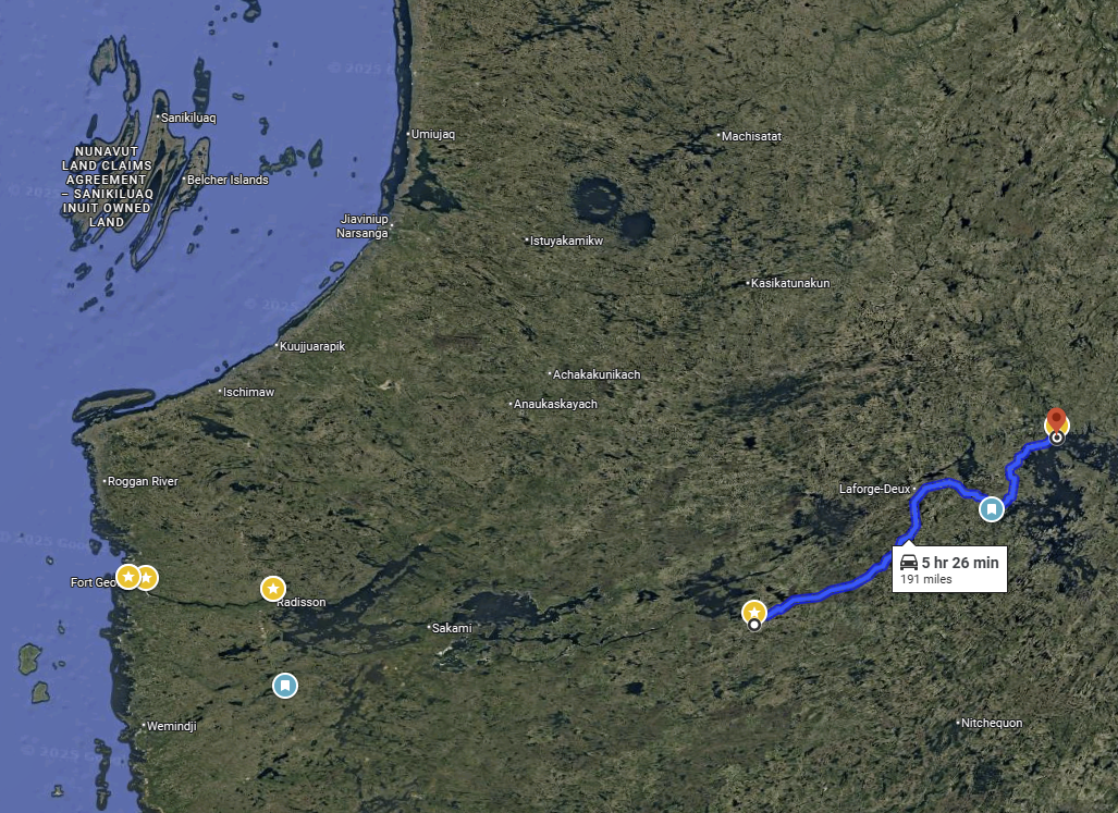

From there at MINIMUM i want to get to the end of the road and back to this same place for fuel. That is AT LEAST 382 miles not counting side trips or exploring the remote road south from the end of the Trans Tiaga. I need close to DOUBLE the range of the vehicle. And we want to go exploring on side quests etc so the situation is actually far worse.
This problem can't be solved by 1 or 2 or even 3 jerry cans. I think I need to carry at minimum 4x5gal cans and even then I will need to keep a close eye on things. Luckily one of my buddies is doing the trip in a pickup and he said I can throw fuel in the truck bed. I think I'm just going to get a 4-pack of VP Racing fuel jugs. If it were not for my buddy carrying the fuel for me I'm not sure I would be making this trip in this supposed "Land Cruiser."

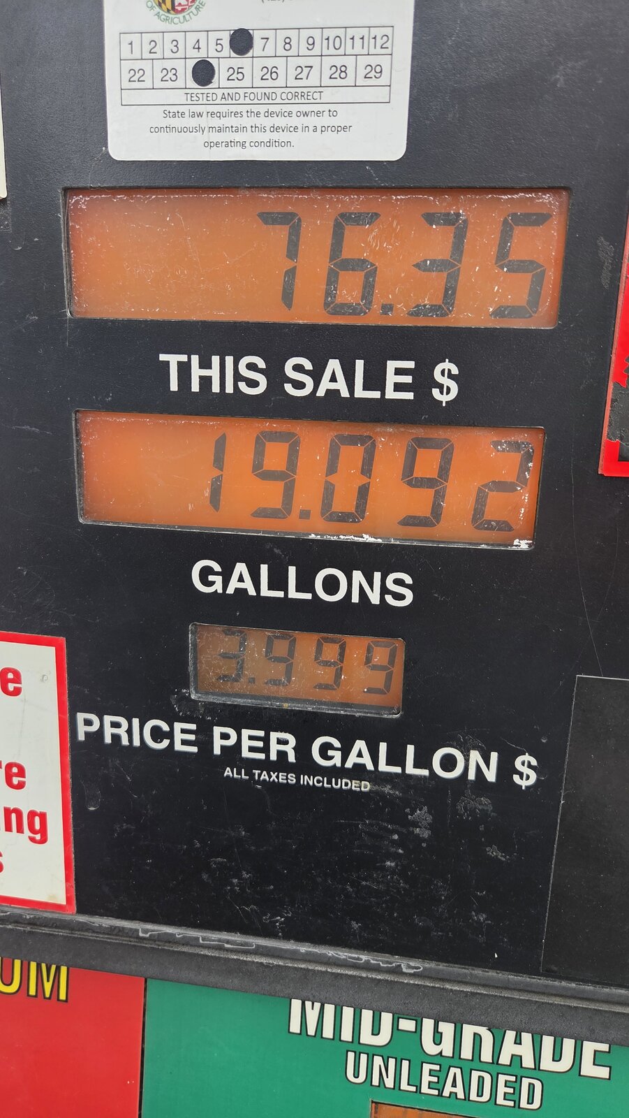

Okay here's an interesting piece of information to add to this issue. I decided to let my tank run down past indicated empty and indicated zero range. I drove maybe another 20 to 25 miles but I didn't keep track of it exactly because I didn't notice exactly when the gauge went to zero.
But the point is I drove it for a while after empty and then just now I brimmed the tank until it's splashed out and put over 19 gallons in assuming I can trust a regulated/ inspected pump.
I usually pump in about 15 gallons if I'm down near empty so this extra reserve in the tank is significant. Also seem surprising that they rate the tank 17.9 but I got over a gallon more than that. I guess some is in the filler neck but still seems like a big discrepancy.
Yes. I "brimmed" the tank. I manually ran the pump into auto cutoff about 10x. I pumped until it overflowed.
You filled the neck, which takes about 2 gallons. So you had an about a gallon of fuel in the tank when you fueled up.
Also, you should not manually fill it beyond the shutoff. Neck contains charcoal canister and evap control equipment, which will get damaged by the fuel.
