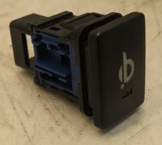

This is a great idea. There’s a blank button just above that area next to the camera button. It’d be cool if that were an on/off switch
2020 Tacoma actually has a Qi switch that'll fit.
This is great!! Is this a CAN BUS switch or normal on / off?
I assume it's CAN but I've never looked it up on the Taco. CH 4X4 sells Toyota "cube" sized switches. My plan when I do the mod, is a simple (normal) switch that'll interrupt the pwr coming from the ECU to the pad (with a breakout harness) with a relay. I'll just order a custom switch from CH4X4 with the Qi graphics (it's a little more expensive but they'll put whatever graphic on the switch face).
