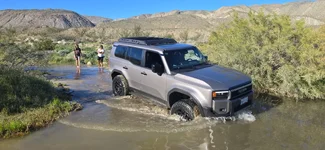

glad mine made it through this puddle...
