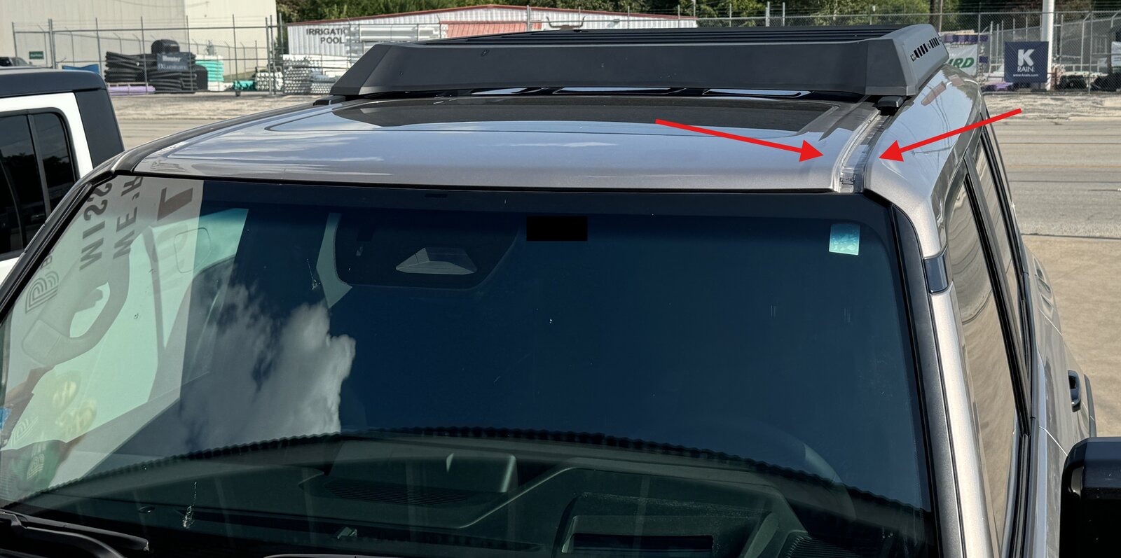

Anyone know what this part is called or what the part number is? I just got my windows tinted and my guy mentioned it was missing on the driver's side. I checked my driveway camera and it must have flown off Wednesday night (now Monday). I was looking on the Toyota parts site and couldn't narrow it down since most of the LC parts don't have diagrams yet. Won't have a chance to get to a dealership till maybe Friday.

Thanks @EOD Guy! Saw this in another post on removing the roof rack. Looks like it's the drip moulding, which I thought it might be (5).

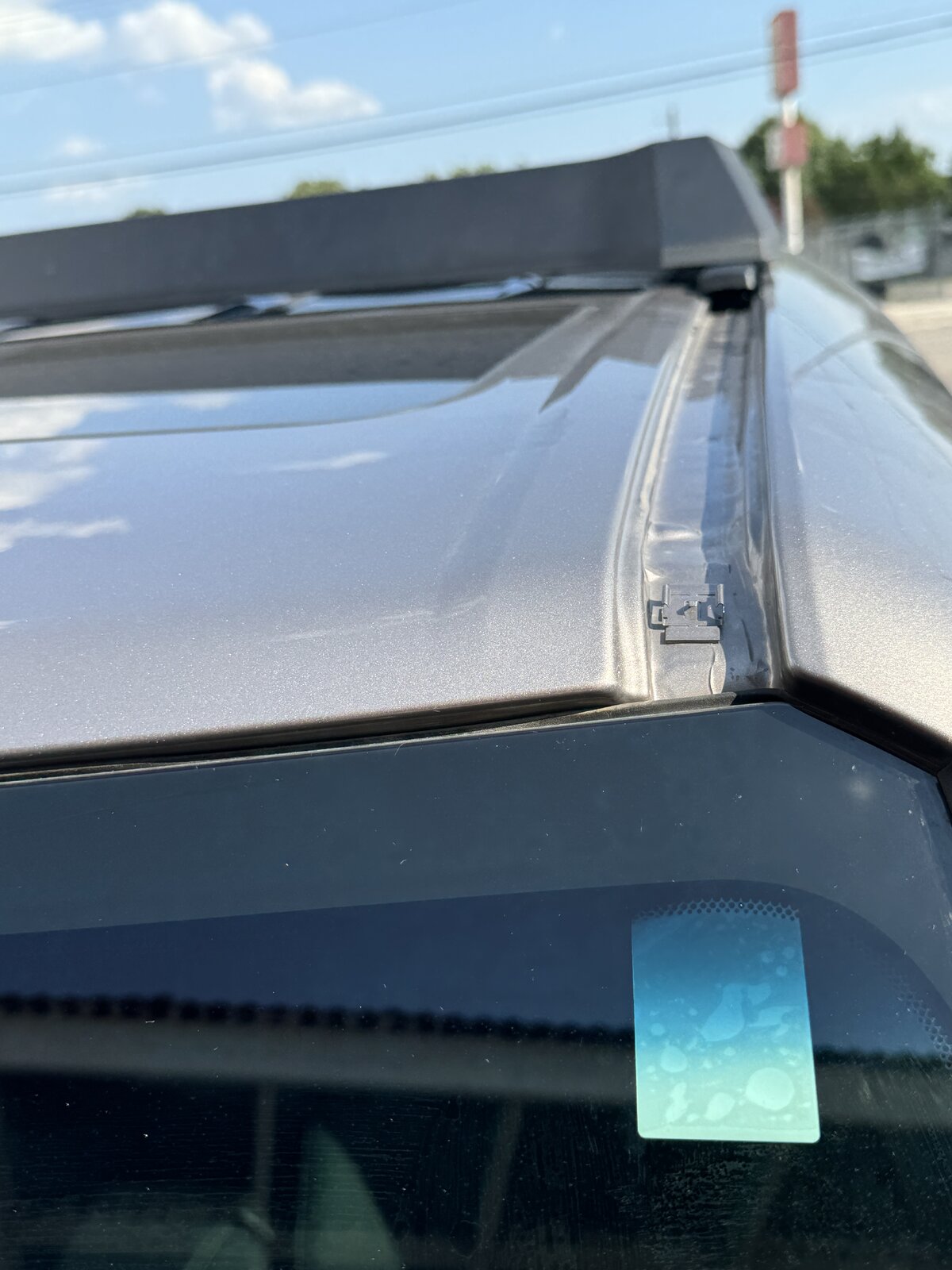

This just happened to me as well. Does anyone know if this could cause a leak into the car, or is the moulding only aesthetic?
Edit: realizing this might be a slightly more involved fix for myself, as it appear the clip itself has come off. There is a part number for the clip.
There is no way that those things keep the water out when they are installed so I'm confident that they won't leak when they are off.
