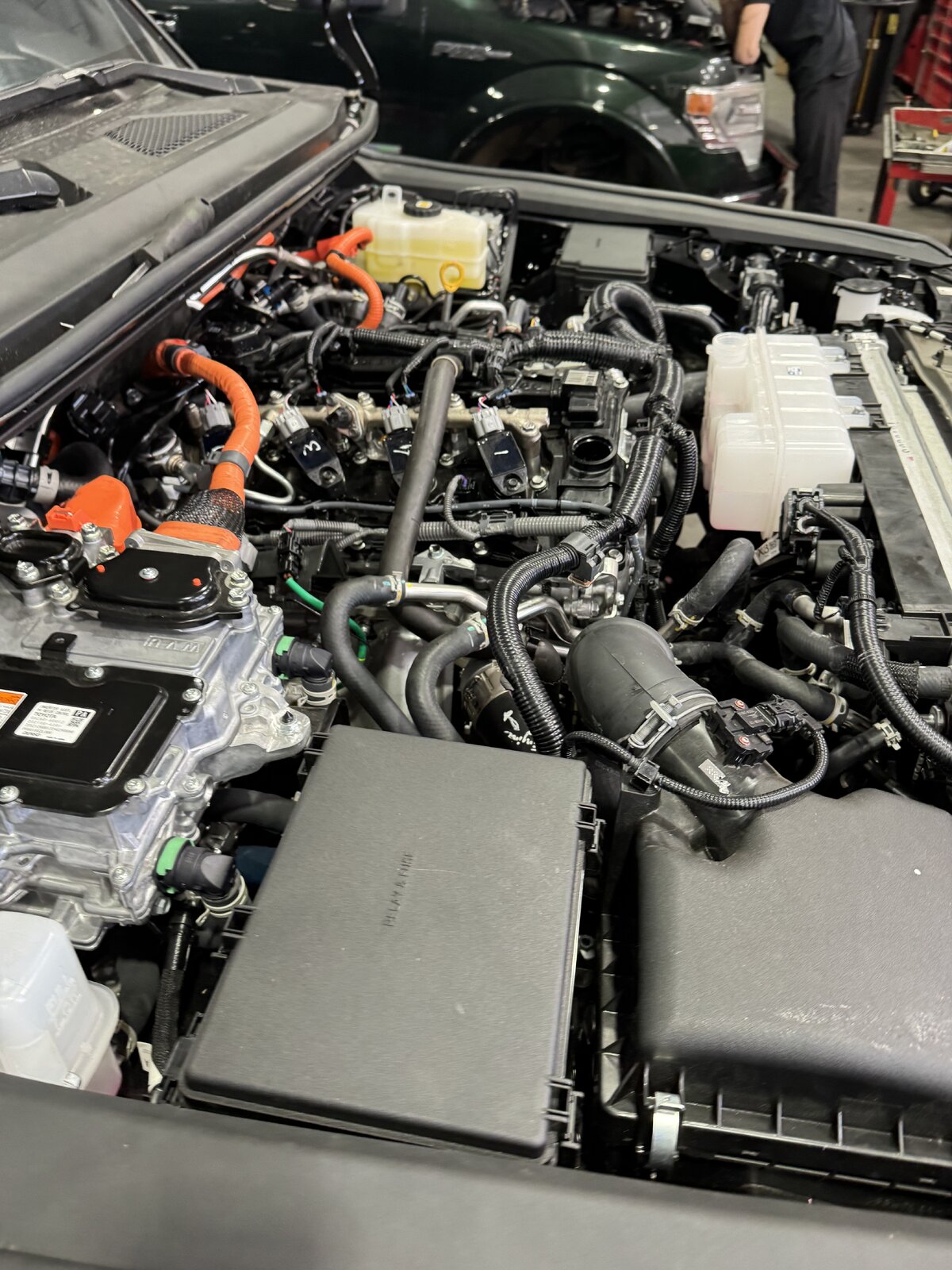

My engine is torn apart at the Toyota dealership. What I've pieced together from Service rep, "engineer", and sales person because they are all chatting about it. Big news at the dealership.
The engineer removed fuel from each cylinder to locate which cylinder the noise was coming from. When removing fuel from cylinder 1 the noise went away. This lead to a total tear down of the engine (in pictures). The engineer is thinking bad universal bearing in the block. There were metal shavings in the oil as well. They are waiting for Toyota corporate to send someone out to verify the findings.
Replacement part: Block
Replacement time: ETA 1 year.... :mad:

Alright…finally got an answer. The service advisor said it’s piston slap. Bad tolerances.
Toyota is also picking up my vehicle (lemon law-buy back) the dealership probably next week. Waiting to hear back from a carrier.
Did see the vehicle too. They have the hood resting on the roof. A new engine is partially in… from what I heard, these things go to auction.
Did see the vehicle too. They have the hood resting on the roof. A new engine is partially in… from what I heard, these things go to auction. View attachment 12876
Happy you finally got an answer and some closure. For the rest of us, I think it’s not terrible news, as my understanding is that piston slap is not fatal to the engine just something you have to tolerate from a sound perspective. Is that correct?
