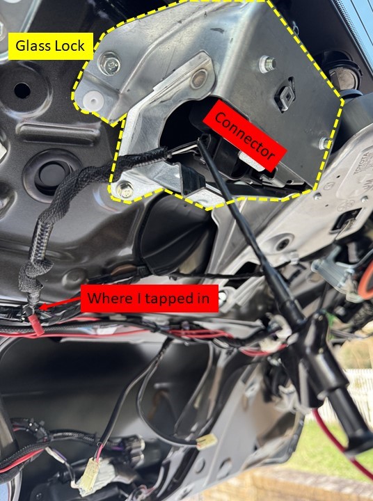

So the doors have got to be unlocked in order for the glass hatch button to pop the hatch. Locality of the E-Key has no effect...... if the doors are locked the outside button will not pop the hatch.
However....... On the hatch lock is a connector, with the hatch partially lowered to eye level of the connector, there are 3 wires:
Top wire in the connector is blk
Middle wire is wht/blk
Bottom wire is Blk
If you apply 12v to the top blk wire the hatch will pop regardless if the doors are locked/unlocked.

I understand what you are saying, I don't use the fob anymore and I'm not triggering the central locking system, just the single glass lock. I haven't had an issue with my dvr's door unlocking switch.

Probably via a relay as most small switches can't handle the load. I also haven't made up my mind if it'll be a totally hidden Magnetic switch or a small push button. I'm still awaiting my rear hatch switch and depending on how that looks will determine if I go mag or push.

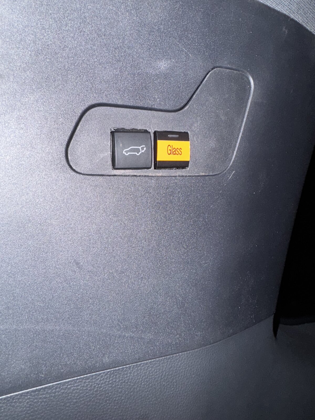

I received the connectors and pins from Japan for my hatch opening mod. Of course they weren't the correct ones and I had to shave the key rails off the male connector, they now fit the OEM switch and I was able to fabricate a breakout harness. With the breakout harness installed the OEM switch works like it should.
Now if the new, inside, OEM switch would arrive from FeaBay, I can complete the mounting of the inside hatch and liftgate switches.
My Switches arrived and I got them installed, could have been straighter, but it was cold!
(edit) The hatch switch is functional with the doors unlocked, the glass switch is always functional (purposely so in case of an emergency).
