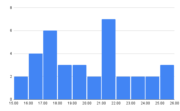

A few reporting in the 20's for the Lexus? About half the responses in this thread have been in the 20's. Here's the distribution:
Quick take: this distribution does make me wonder if there's some common/frequently occurring factor that causes several people to be stuck around 17, but I have no idea what it would be.
The longer version:
The big caveat with this data set is that with the title of the thread, and as it goes in general with problems, the data set likely over represents problematic values (near 17 mpg). The mean and median values are both 20 MPG, the most common value is around 21-22. But it's not a very uniform or Gaussian distribution as I'd expect -- It's small number statistics to claim much, but it does look a little like a binomial distribution with a lower peak around the 17's. With the very limited data in this thread there was no obvious correlation with tires, wheels, trim, or even AC use -- most of those looked like maybe a 1mpg-ish difference alone. Not a 17 vs. 21 mpg difference. Short trips (and low MPG) vs. highway driving (and generally much better mpg) was a theme in several posts.

Yea ive picked up same mpg distribution from reading threads. Roughly 25% about 17 and rest about low 20’s.
havnt seen a correlation to geographic region, driving habits, etc.
people mostly got 20’s right off the bat or 17ish.
