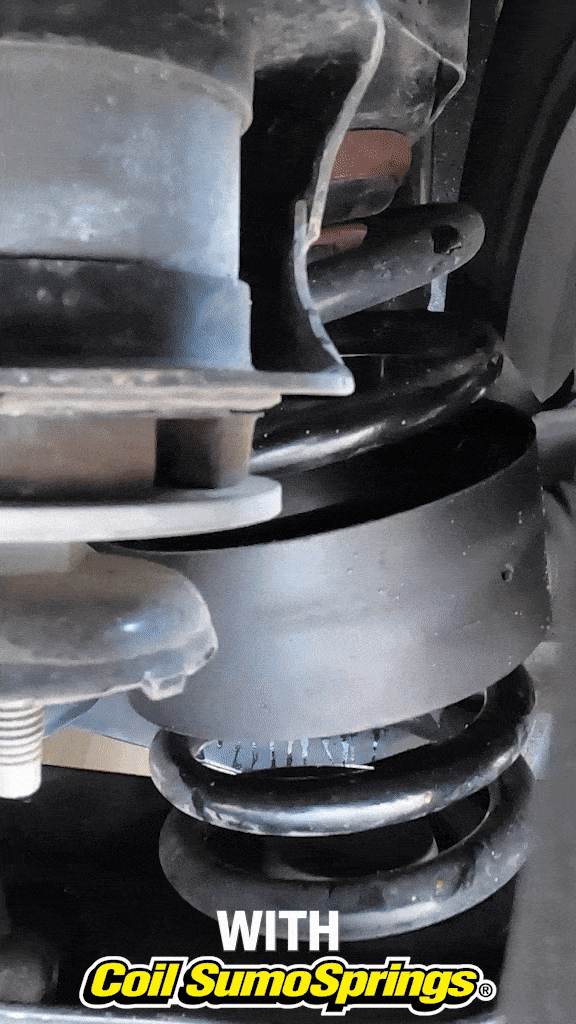

Has anyone looked into the sumosprings coil inserts?
I’d imagine you’d trade some articulation but it seems like a decent option for folks staying on the road looking to make things a little more progressive, might even help dampen wash board gravel roads.
